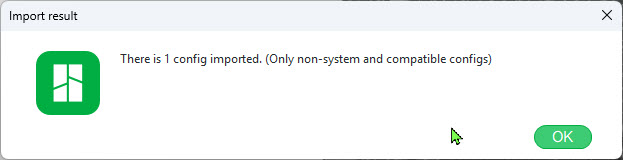

I will!! I’m sure this is just my own ignorance as a noob to the bambu world (but not new to 3d printing). I did the file-import-configs on the X2D PLA-CF and TPU-85A profiles. I’m running super generic, .4mm nozzle, .2 mm layer height. factory process settings on my X2D. During import I get this
which results in this
What am I missing?
