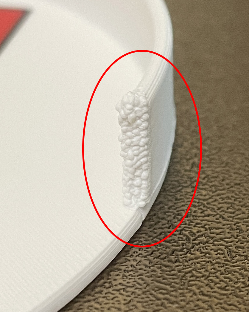

Everything when fine until this
The filament is eSun Basic white. I check print settings and all are the same as virtually any PLA Basic. Right side is shown, left side was a little rough but nowhere near the right.
Suggestions?

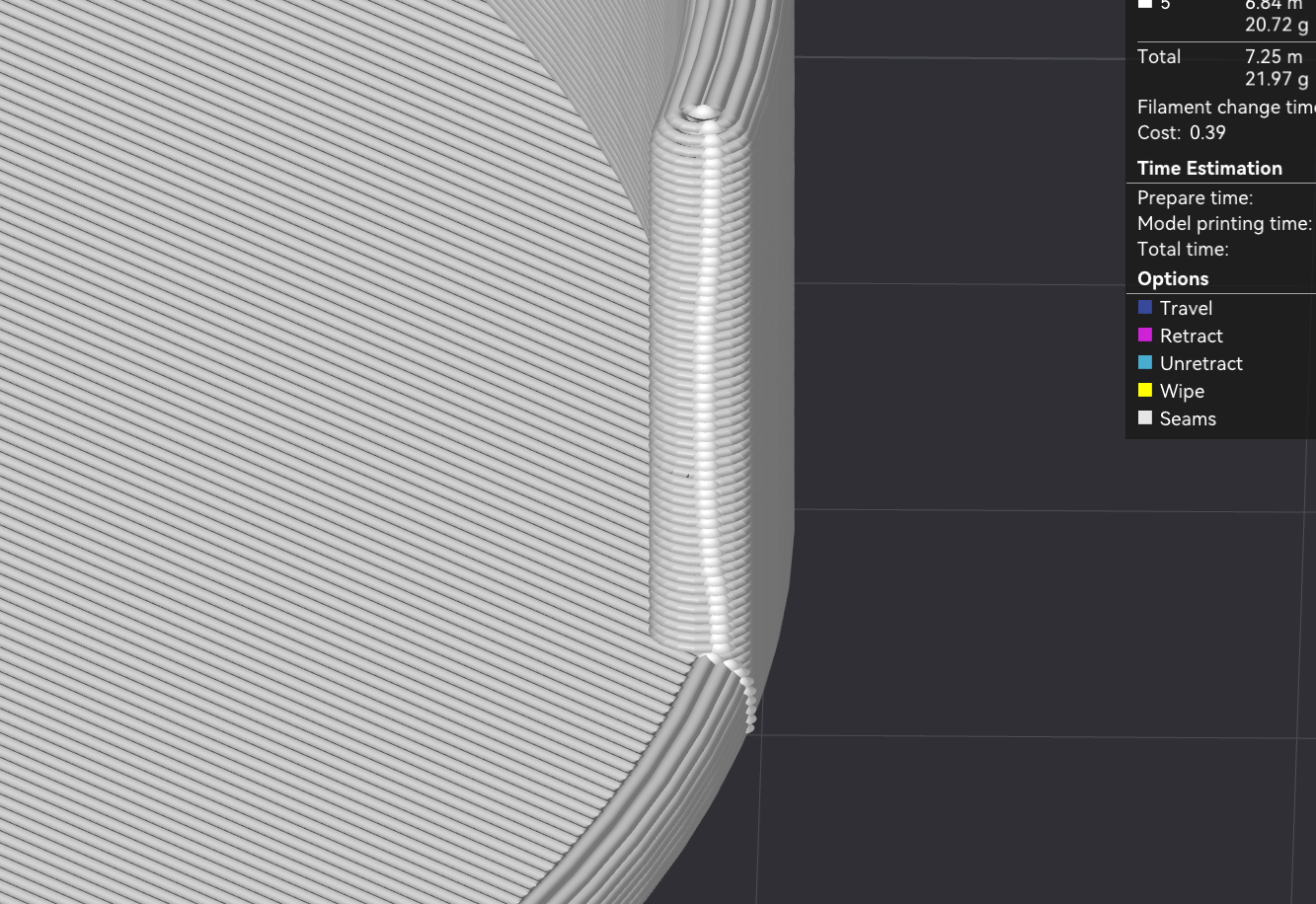

Does the preview window show the seam at that location?
Looks good in preview.

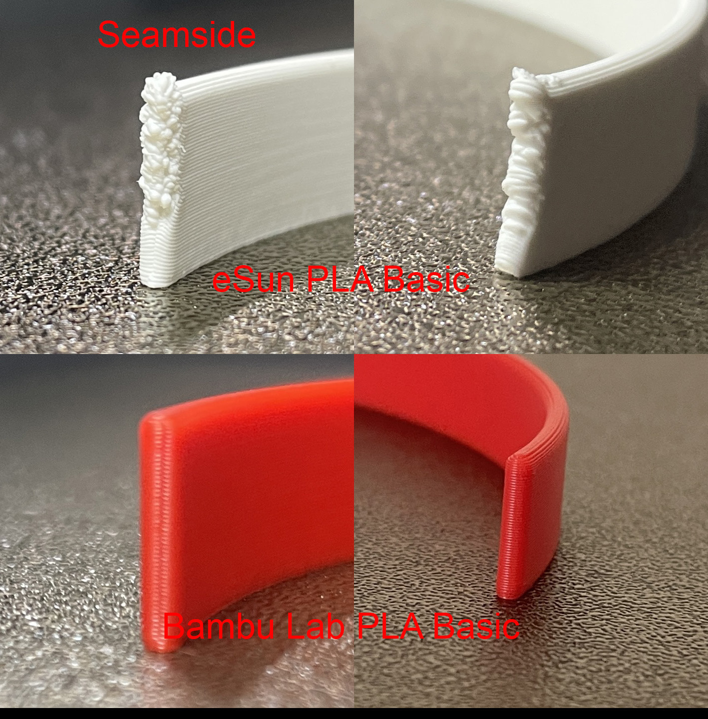

With my previous print I used up Jayo basic white and used this eSun basic white as a backup but named it “Jayo” so the AMS would finish the print. The results were similar. Jayo looked perfect and eSun as in the first post.

Basically it looks like it develop small blob and at the end it wipes it at the corner. So maybe it will need better manual calibrated profile.
As suspected the seam is located exactly where the issue is. My guess is that your scarf settings are causing this issue. Try turning scarf off. It’s this or your flow dynamics (pressure advance) are set too high.

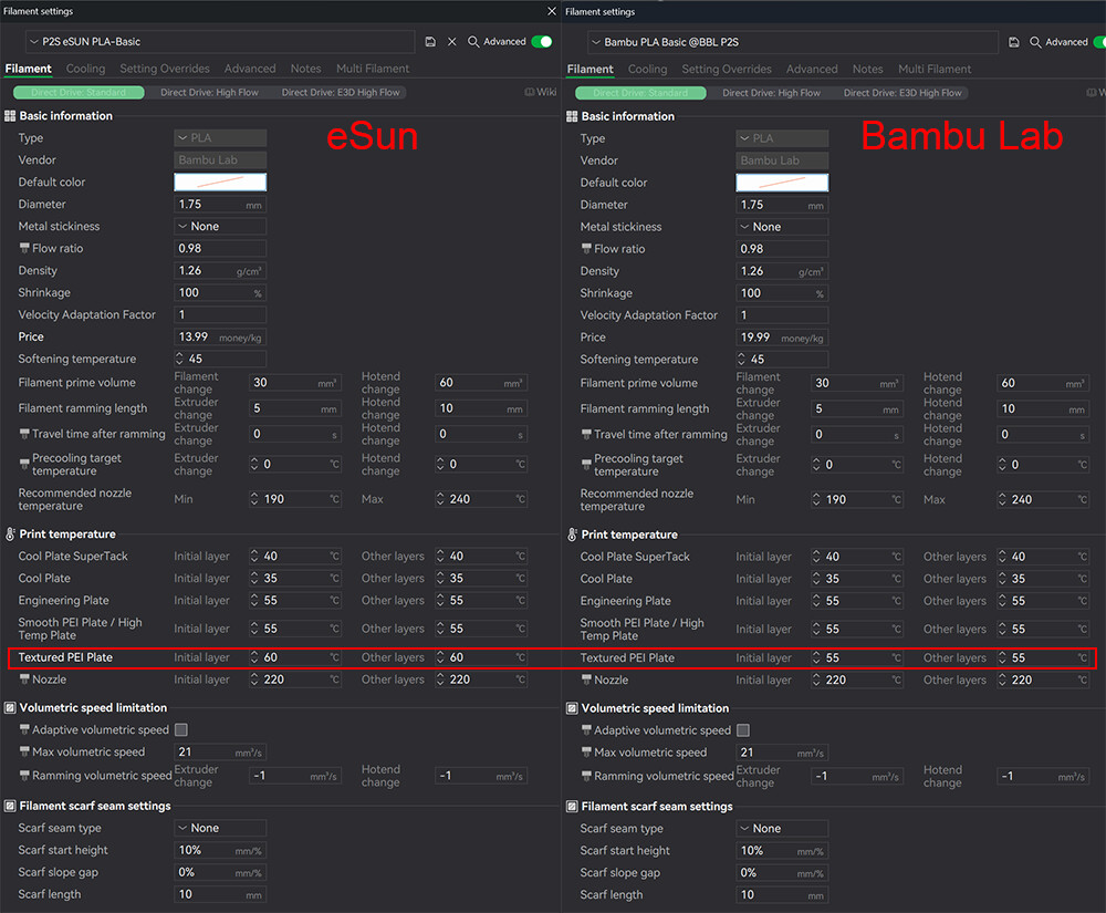

Ran a test today; All settings are the same. I did not change Scarf settings. Both printer settings are the same with one difference; eSun has bed temp set at 60C instead of 55C.
The eSun spool is nearly at the bottom. I have not noticed this issue until last week. The Bambu Lab red is a year old PLA Basic.

The only difference is the PEI Plate on eSun is 5c hotter

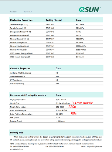

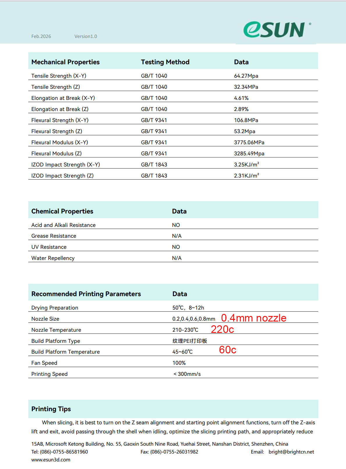

However, this differs from the manufacturer’s recommendation. It won’t make much of a difference, but it does raise the question of whether the profile is set up correctly:
eSUN PLA
  • Extruder Temperatur. 210 - 230°C
  • Bed Temperature: 45 - 60°C

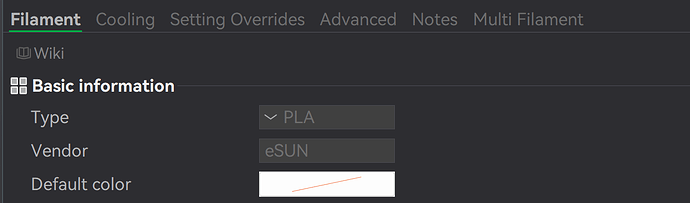

You can see from your profile that it says “Bambu”, not “eSUN.” Actually, that should be listed in the profile - Vendor: eSUN
Did you accidentally select the wrong profile? Did you follow the manufacturer’s settings?

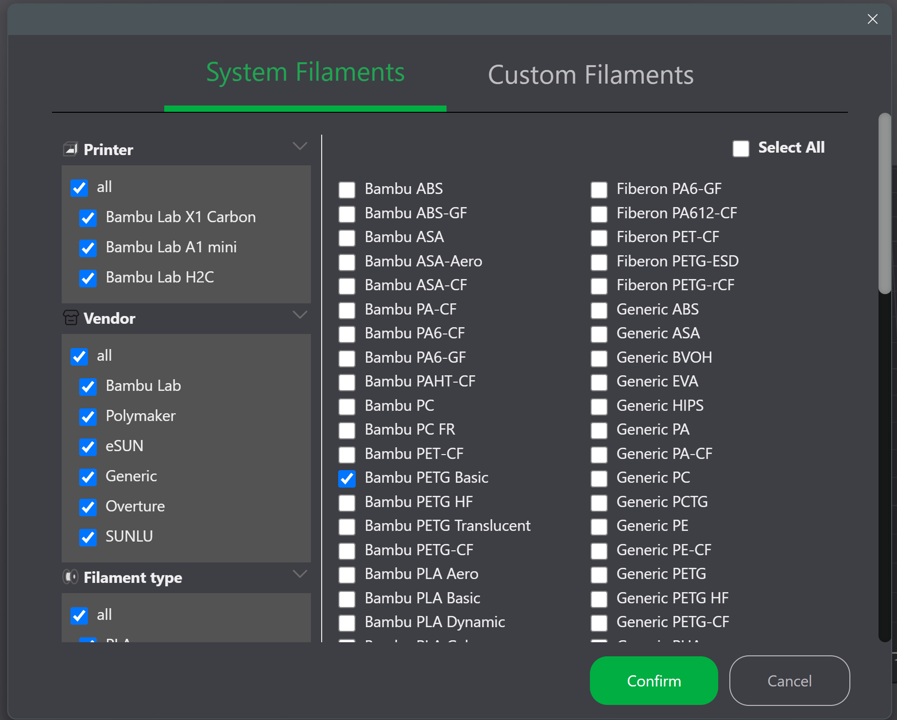

I’ve searched for other filament manufacture settings and used what I have found. I see nothing in Bambu Studio for filaments other than Bambu Lab and generic. When using a P1S Bambu did list other manufactures like Sunlu but I don’t see anything for P2S.
It’s possible that it hasn’t been set up yet; please check to see if it’s been activated.
Alternatively, you can also find the information on the manufacturer’s website, which is usually much more up-to-date than the information in Bambu Studio:
I see nothing in my settings that would drastically alter the print quality in eSun’s recommendations.

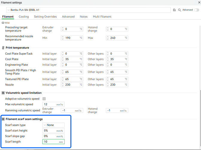

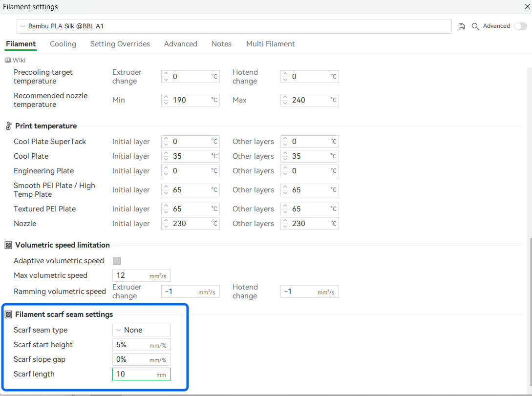

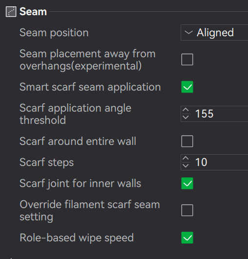

Below is the default setting. How do you do turn scarf off?
It used to be in the Quality/Seam section but now I think it’s disabled in each Filament settings.
Yes, disabled in mine, too.
