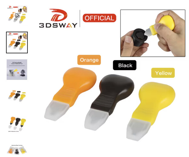

After I stabbed myself with flat screwdriver when removing support, I started to use this tool since then
A right of passage of use all.
