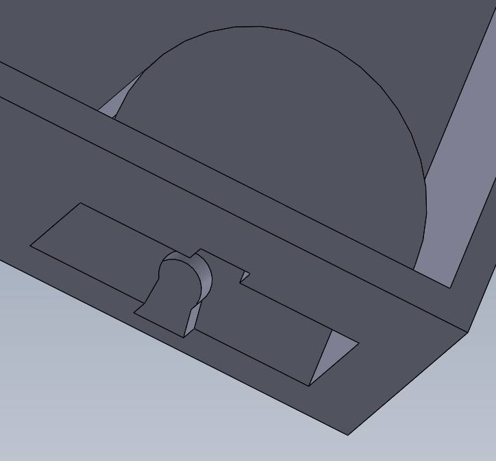

I am making some rectangular containers and I need to have wheels on the bottom, not the side. Preferably taking up as little space as possible.
I have seen since injection molded examples, does anybody know of some examples of 3D models with wheels on the bottom? I am looking for some ideas instead of me just reinventing the wheel :wink:.

Your question is a bit vague. What size container? What weight must it contain? What surface are wheels expected to run over? Must it be all fdm printed? Do wheels have to be like castors, i.e. pivot around z axis? Do they need to be hard, or have rubber like tyres?
124mm x 236mm x 65mm
Don’t know exact weight, but pretty light, makeup, toothpaste, etc.
Painted wood
I was looking to do all fdm, but am considering buying small wheels to attach.
No, just needs to turn one direction.
Either way

My initial thoughts would be plain wheels, about 30/40mm diameter, with tpu tyres, recessed into base of container so maybe only 2 or 3 mm below the base. However, the bus wheels that drakko linked too, would be a shame if they were enclosed, and the container could then be modelled on a lorry trailer. And then I thought, why stop there, model a landau instead.
I think simple metal (ss) rods would suffice for the axles, or even 4/5/6mm bolts, recess them to clip into the base of the container. TPU tyres would give a bit of grip, so wheels actually rolled, and would not scratch the paint. If TPU does not print well for you, then wrap the wheels in PVC insulation tape, or thin self amalgamating tape, or coat with hot melt glue, to give a soft, grippy surface. An alternative, but not so much fun, would be a felt pad at each corner.
Given the size, the weight and the use for it, I would go for a very simple hard wheel, snap-on design, something like below example:
wheel
Thanks, I was thinking to do something similar.
Question is, do you really need wheels :wink: wouldn’t small stick-on chair slider at each corner fit the purpose?
You may have a point. I think I will first try the chair sliders and see how it goes. It will be less trouble and give me more space within the container.
Although printing wheels and wheel recesses is more fun :wink:
