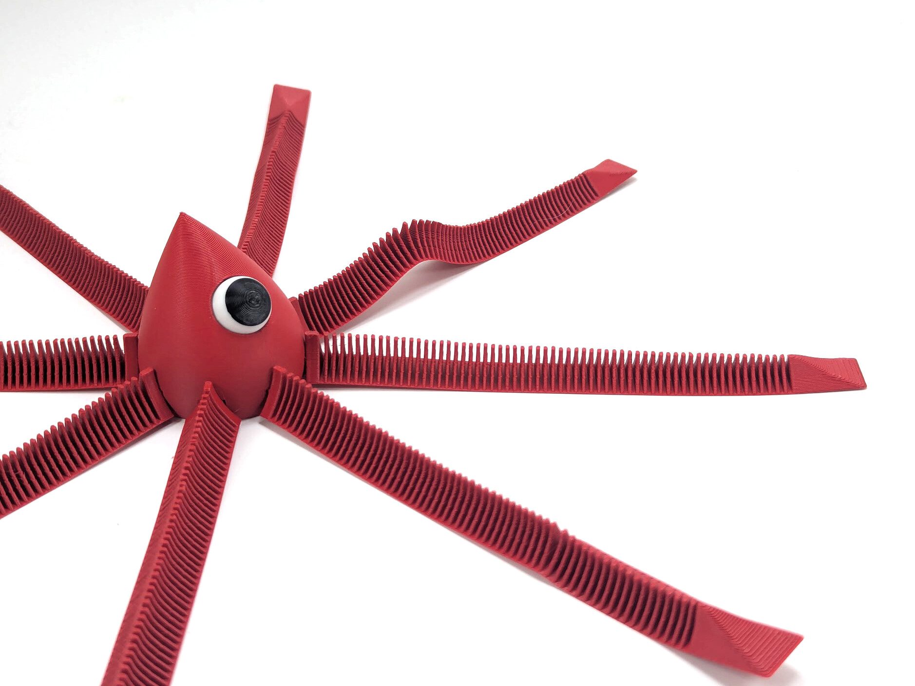

Wanted to experiment with a new way to do flexy things. I’m still working through different filaments to see which one seems to do best.
BambuLab Matte filament seems to work well.
Generic PLA (Sunlu) was too stiff and cracked.
BambuLab basic PLA was ‘ok’, but doesn’t seem to be as resilient as matte PLA.
The model is posted here.
It’s an experiment and I’m sure I’ll get some low ratings. It’ll be worth it FOR SCIENCE!!!
Edit: I like the caterpillar more.

I don’t mind at all! Would be great actually. I’m really curious to see how others use it. I’m working on a caterpillar that uses the same method.
For the sake of disclosure, this way of flexing seems inherently fragile, but it has a very interesting feel.
A bottom layer of .2 is very flexible. .4 is a bit stiffer but seems a bit tougher. I think I’m going for .2 for now until complaints arise lol.
FWIW I tried PETG and while it’s more ‘springy’ once it reaches the deformation point it just snaps instead of deforming. For this design it doesn’t have an upside imo.

I tried a few versions with petg and I did not think it made that much of a difference. Past a certain point it just snaps instead of deforming like PLA does. I think the ideal material would be TPU, but I don’t have any on hand to try.
