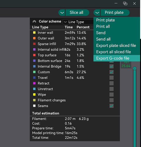

The way I would approach it would to export the G-Code. Let’s say you want to freeze everything because you got your print into a perfect state that you want to preserve. Then for that, you want to export your G-Code. If you haven’t worked with a G-Code file before, think of the G-Code as being a pre-complied version of your model description.
After you’ve sliced your mode, drop down the “print plate” and export G-Code
A basic experiment involves taking a simple shape like a cube, reshaping it into a smaller, unique form suitable for experimentation without excessive filament usage. Then, position it at an unusual angle and create a sliced version. This will confirm to you that when you reload the file, it will retain its original settings as you wanted them.
Next, export the G-Code and open it in the slicer to become acquainted with the G-Code’s constraints. Please note that once you export the G-Code into the slicer, you won’t be able to make further edits. It’s a one-way process, but if you have your original model files in a 3MF format, this won’t be a problem.

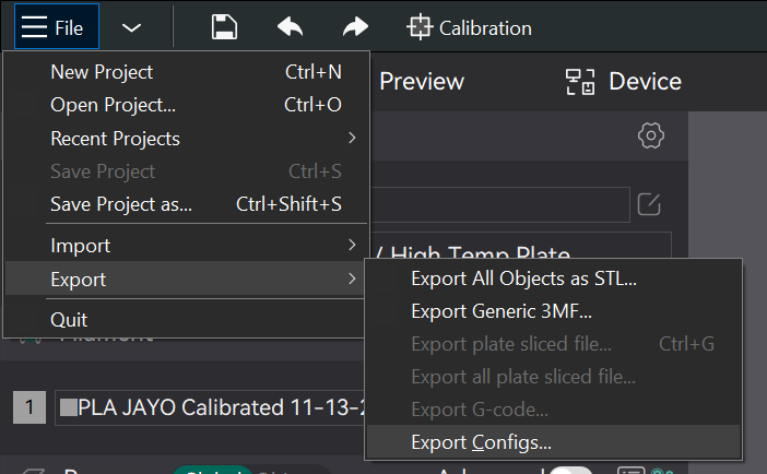

Sorry if I’m confusing. I’d like to save the parameters of the project , ie; slicer settings, but not the objects. If I save gcode, that only saves the executable code for the project and the ability to print another exact duplicate on the same machine. I would like to load the current slicer settings, with no objects, then import new objects so that they get the same slicer settings. This type of project uses a lot thin layer colors, thin wall sides, and modified fill settings. As a bonus, Id like to be able to save and reload the negative objects I’ve created.
Do you see this option under File menu?
Orca Slicer
Bambu Studio
AFIK the export configs is for exporting your system configuration files, not work files.
