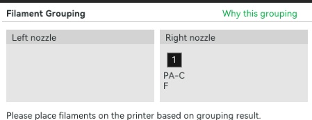

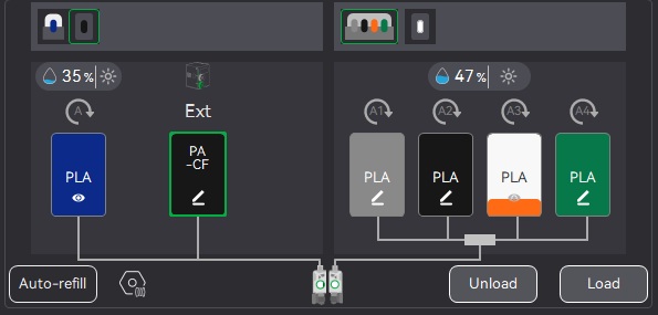

Hello,

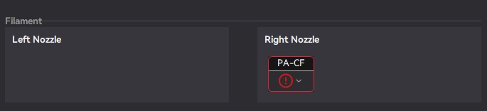

The external spool shows on the filament configuration on the printer and in studio by default to be connected to the left extruder. I therefor connected it accordingly but when slicing and printing it now shows connected to the right extruder and when printing it indeed uses this one.
Is this a known bug?
When you slice, try slicing with the “Convenient mode” not the “Filament saver” mode. I have made this mistake a few times. I need to see if we can default to the Convenient mode on all prints.
Thanks for the hint! Convenience mode didn’t work but manual mode showed the correct assignment to start with and allowed me to change it.
