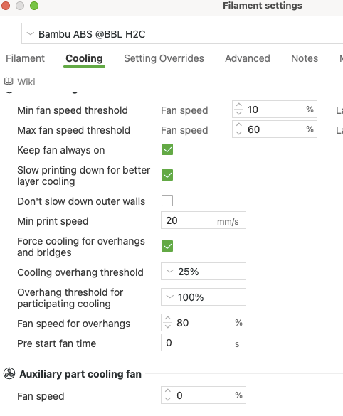

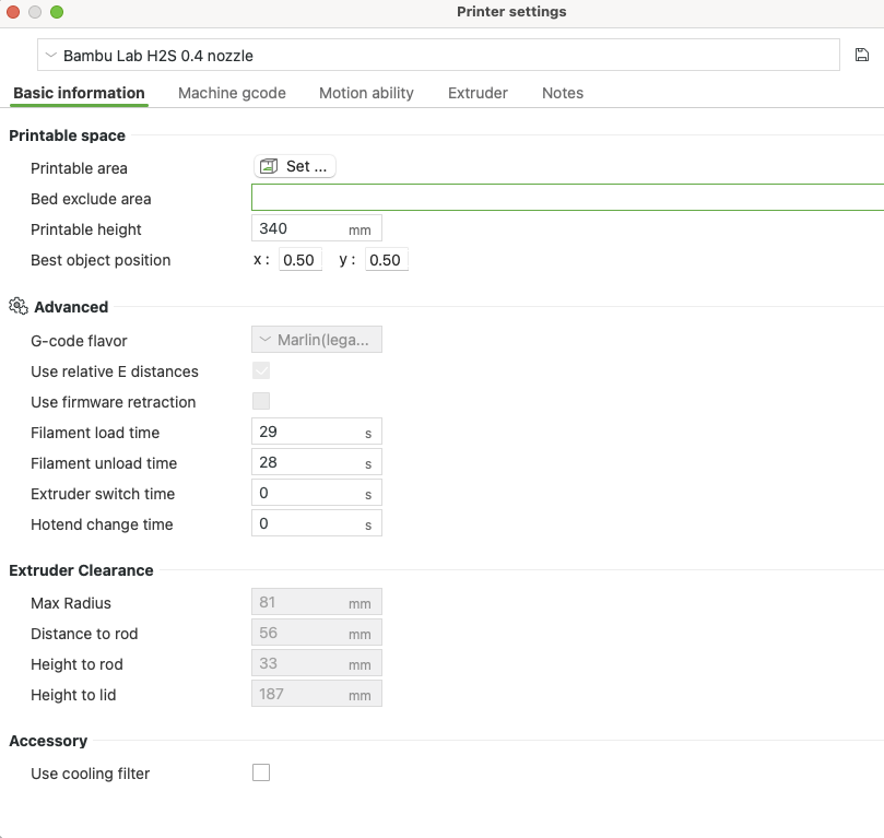

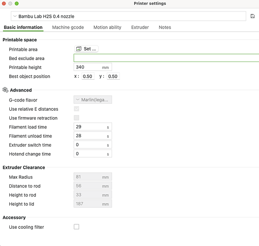

The H2 series does not have an “air filter enhancement” option. It only has “Use cooling filter,” which has no effect.
My P1S and X1C both include an “air filter enhancement” option, but not H2C.
Could you share a screenshot of your BS H2S showing the “air filter enhancement” setting?

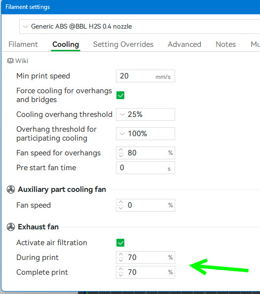

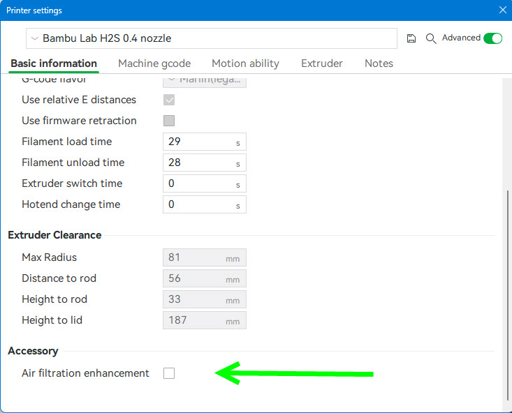

These are from default Bambu profiles for the H2S w/0.4mm nozzle and a Generic ABS. Not my modified ones.
Check this box for air filtration enhancement and you will get the items at the green arrow in the filament cooling section below after checking active air filtration.

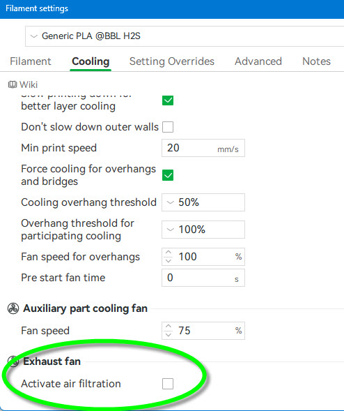

wow here is my screen grab BS ver: 2.4.0.7 could it be windows ver having different options?
I’d say at the bottom, use cooling filter.
I tried it doesn’t do anything…

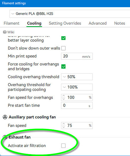

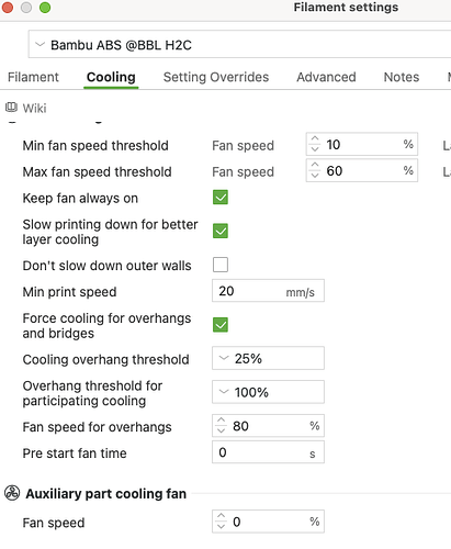

Once you check mark that area under the printer properties, go to the filament you want to use and go to the bottom of the cooling page/tab and add a check under exhaust fan to active air filtration.
Possibly need to restart studio in between.
that check box doesn’t do anything.
Odd, it gives me the extra fields below auxiliary part cooling fan.
It would be a little surprising if a Mac and PC version were that different.
For anyone that has a H2C (and possibly H2D) that is missing the “exhaust fan” settings (because BBL removed them), you can get them back by doing the following:
If you don’t already have a user printer preset, create one. In the top left where you can select your printer, press the edit button, and save this under a different name, making a system preset a user preset. This saves the user configuration to disk as a json file, which on Windows is located here:
C:\Users\{your-user}\AppData\Roaming\BambuStudio\user\{user-id}\machine
It will have the name you’ve given it. Sorry, I don’t know where this would be on Mac or Linux.
Edit this file and add the line below to the collection:
“support_air_filtration”: “1”,
Save, restart Bambu Studio, voila, settings will show up in the filament settings under cooling if you have this printer selected. Swapping to the system preset will hide the setting again, but comes back when selecting your own user preset.
Hope this helps.
Do you know if it still works? I’ve tried, but I can’t get the option to appear for the filaments.
