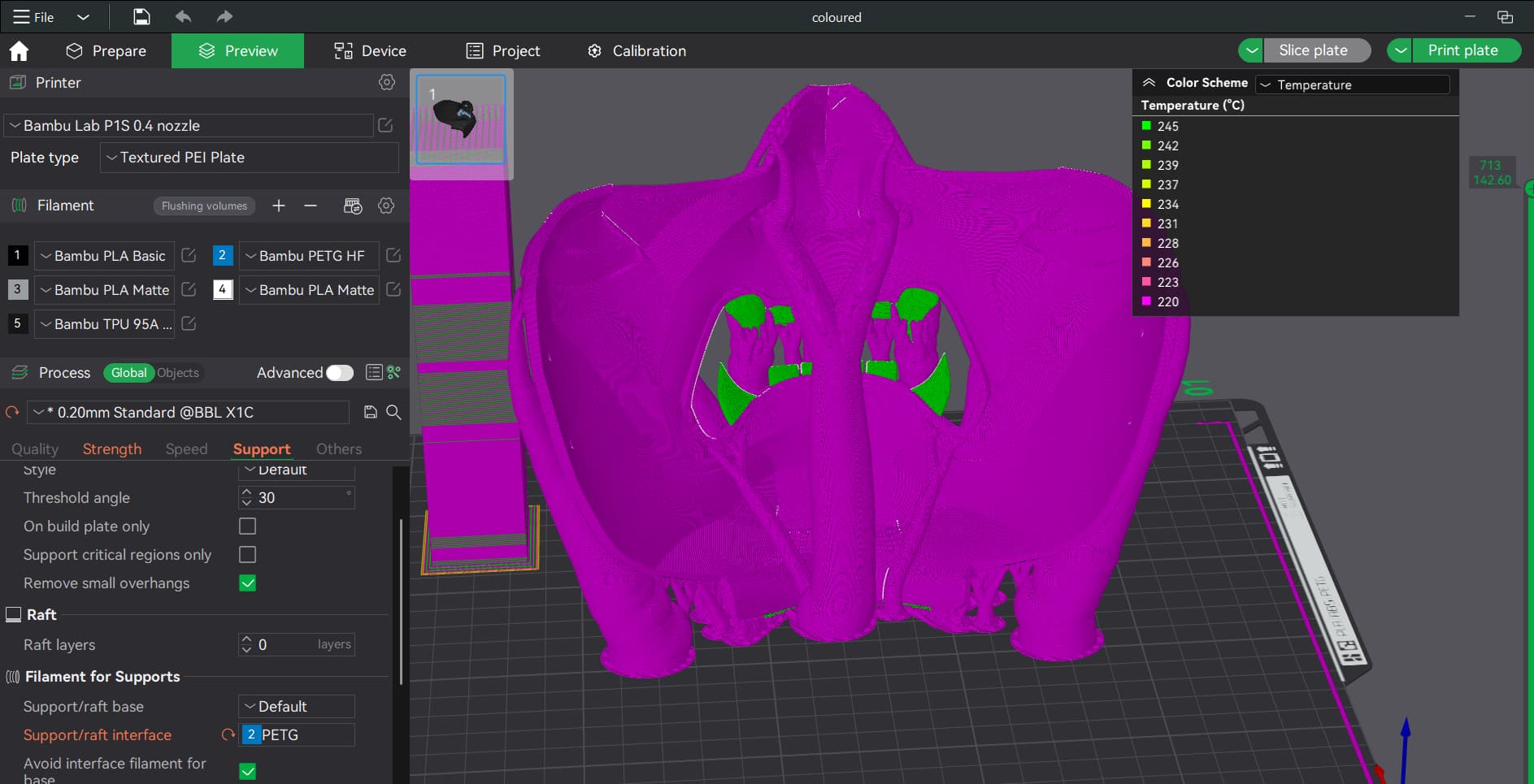

Try printing PETG using PLA for support material.

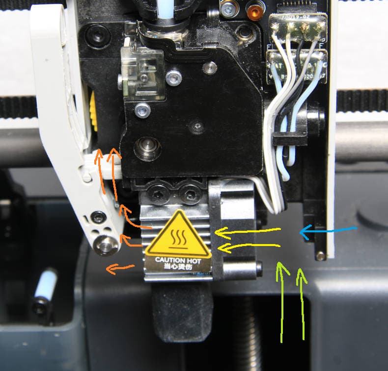

This is what I think

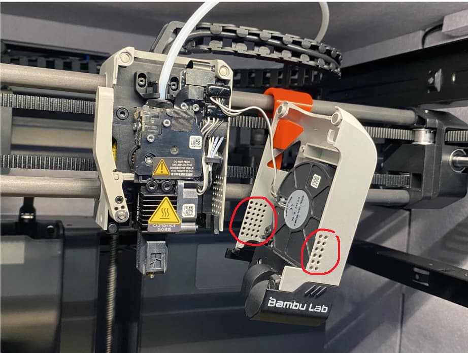

These vent holes are too small and it restricts air flow quite a bit
From what I can see, it just takes the heat away from hotend and dump a bit of heat into extruder.
Because of this, chamber temp can be 40C but inside the toolhead could be 10-15C higher
Explain how the printer get’s to the point where the petg print temp raises the internal temp so high that it causes the pla to hit glass point enroute to the extruder.
As you can see in the above image PETG won’t get over 245. About 20 above the temp for PLA, but only for a few seconds as it’s just for the support interface layer. This isn’t for every layer, it’s for the interface layer.
The temp is never high enough to raise the chamber temp above 40 max. The extruder is not getting hot enough to push PLA to the glass point. If anything is heating would be the nozzle past the heat break, which would cause a jam at the most near the top of the nozzle.

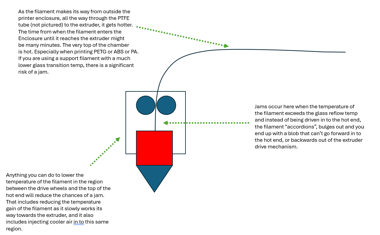

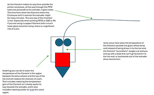

You’re still not getting it. Go re-read my example again. I’m not saying the filament melts in the PTFE tube. That’d be stupid.
I’m saying the filament gets pre-heated by the chamber temp on it’s way through that tube to the extruder (which is why, in part, lifting the chamber lid reduces the odds of a jam - the PTFE tube isn’t sitting in as-hot air).
The hotter the filament gets from the chamber, the less additional heat needs to be added in the area above the hot end to generate a blockage. So if the filament is cooler when it enters the extruder, it will require more heat in this area to get the filament hot enough to soften and cause a blockage.
So pumping cooler outside air down the PTFE tube will keep the filament cooler during its traversal of the tube, requiring a longer “exposure time” to the heat above the hot-end before it can melt. If the exposure time is long enough, the filament feed rate moves the filament faster than it can reach that critical temperature and you don’t get a jam anymore.
Also, the air that exits the PTFE tube at the extruder will, to some extent anyway, be discharged in to this area where heating leads to jams. That would remove at least some of the heat from this area, too.
This idea would have to make a difference. The only question is whether or not it’d make enough of a difference and that’d have to be answered empirically.

There are two much larger holes on the right side, plus a very large opening on the top of the cover and another around the opening for the filament cutter. Air flow is not a problem.
