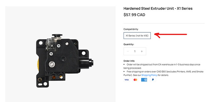

I’ve been looking for an extruder unit for my X1E.
All the ones I have found state they are for the X1C. Can I assume that they will fit?

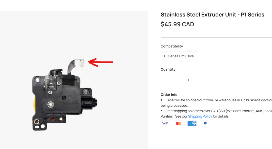

I don’t think it is a drop in replacement.
I think that the connector is the issue.

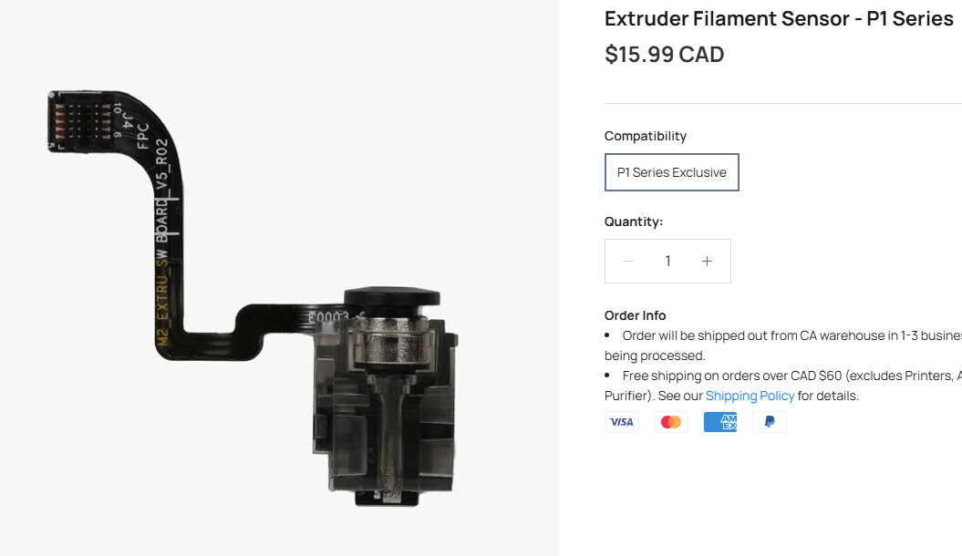

I’m pretty sure that the X1E has the P series connector on the extruder
I can’t guarantee this will work, but you can could buy the P1 extruder and swap in the X1 hardened gears or buy the X1C extruder and swap in the P series runout sensor.
Not endorsing or recomending for/against but I did come across this:
