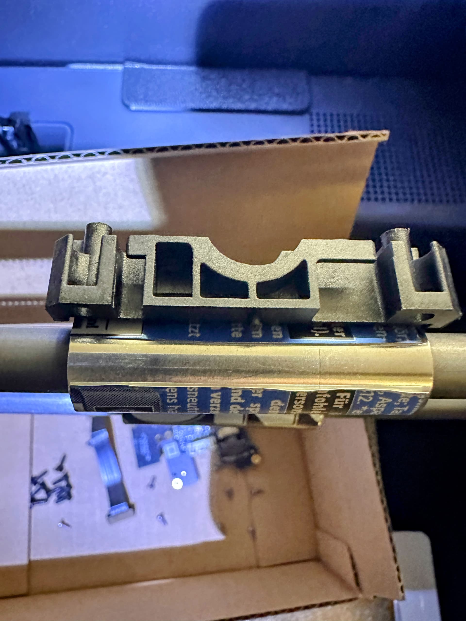

It seems to me that it would be more prudent to create a half split printed bearing that would sit inside those two cavities, using the open slots to keep them secure on the X axis so as not to try to shift, at .33 to .35 mm thick to secure the housing to the bearings. when squished via screws. The fix is on their end to increase the tolerance of the existing part and re-cast them, or provide a printable STL/3MF to the users to modify.
For the record, the play came back. I’m going to disassemble it again and use metal tape as shim, but I’m thinkig of ordering a new carbon rod assembly which hopefully has a better fix implemented. I’m not sure how those threads in plastic are going to hold up if I have to do it again.

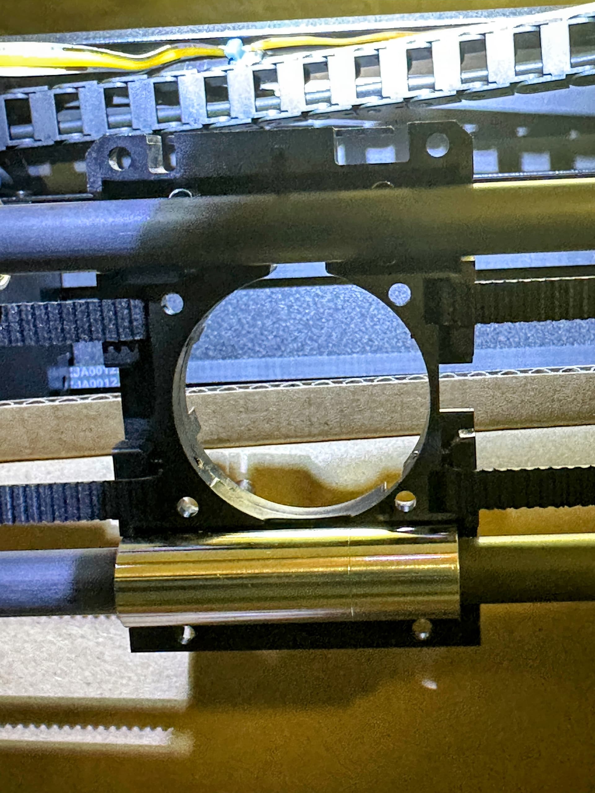

I shimmed it more, maybe even too much, and tighteneted it. One of the screws didn’t feel right, I think I overtightened it.
It has a bit of play now (it has been printing non-stop), and I already have new carbon rods and plan on changing them this weekend.
Taking it apart and shimming it is not too bad. Changing the carbon rods is not too much fun (I changed my belts previously which is 99% of the work), mostly because you have to remove the panels, get the belts out and back through, and in the process you should clean everything, the idlers, any debris, and hope you don’t strip any screws. Last time it took me maybe 4 hours but I was taking my time, cleaning everything, also readjusting the Z belt and tramming the bed and my idlers were very dirty and had to be almost scraped off… I hope I’ll be done in under 2 hours this time :slight_smile:

You know you make your bearings not round?
The bearings are round and with shims you make the wrong way. Its not a solution, in time you habe more problems

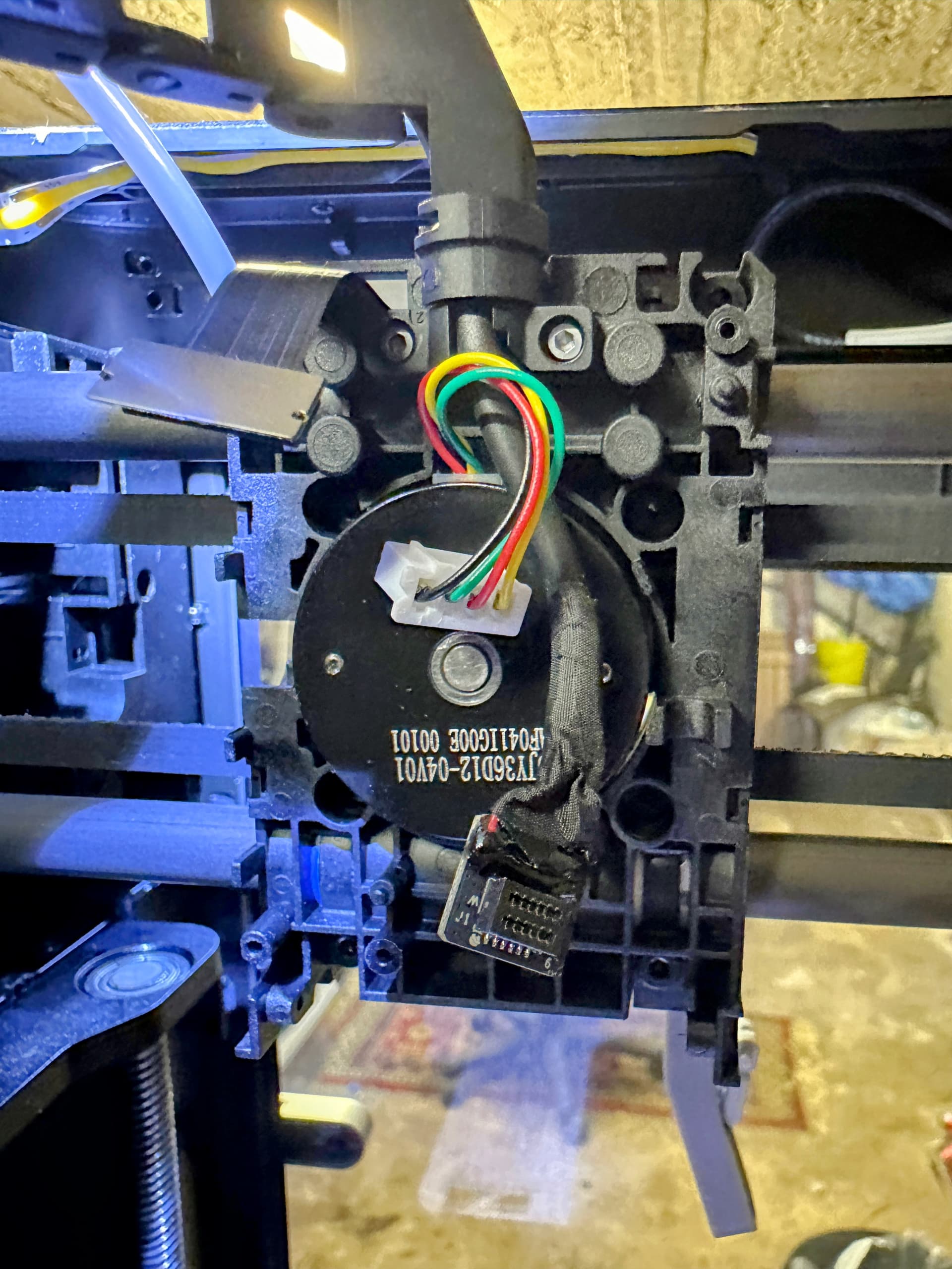

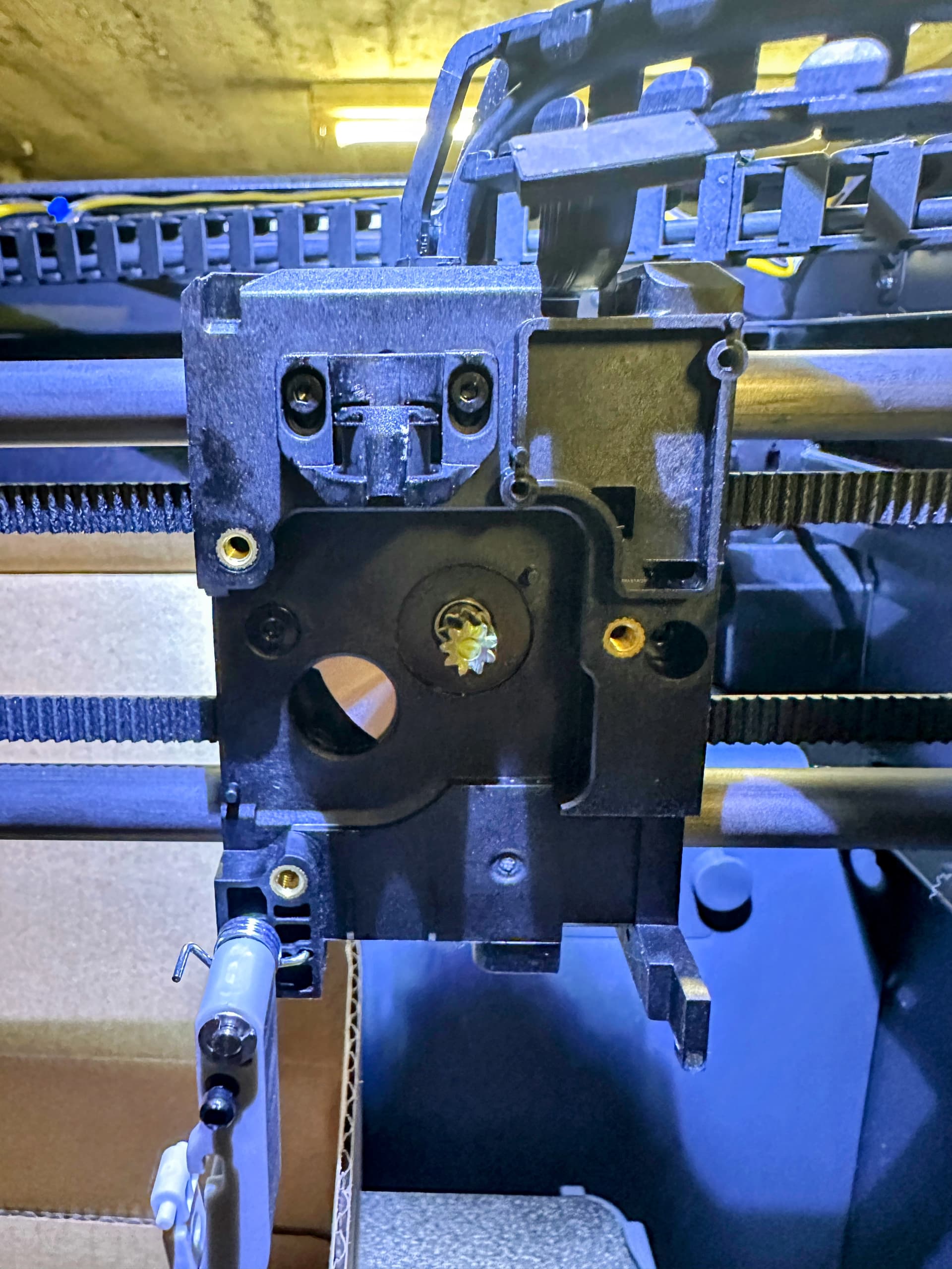

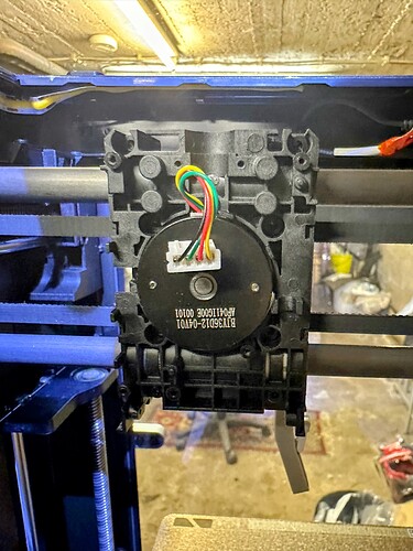

For the record, I repeated your procedure.
The screws are really filmsy. Clean your hands thoroughly before starting this. I think it doesn’t help much because for me the play is already in the bearings. Also the Extruder now has springs which press on the rod bearings. That together with input shaping could be enough to compensate for play.
Thus I recommend you don’t repeat this procedure. The damage to plastic threads is high, and you’ll touch the PCB with your fingers, they don#t have conformal coating and you will not improve the printer.
I used ~100um energy drink sheet metal as shims.
After all that, it’s important to clean the carbon rods from skin oil and sweat.

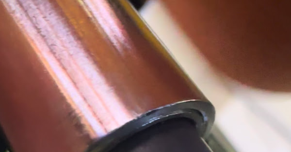

Does anyone know how much play is reasonable for the carbon rod bearings? Here a video, it’s very difficult to see, easier to feel and hear.
To end my problem, I bought a new X-Axis assembly 2 weeks ago.
No more play, especially the nozzle doesn’t move front to back anymore.
I can’t really tell if the quality has improved much, but at least I can now forget about this problem.
