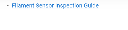

Filament Sensor Inspection Guide | Bambu Lab Wiki
P1 Series | Bambu Lab Wiki
Thanks! Especially concerning the Filament Sensor! I’ve not had to deal with it in the past and the info I found previously wasn’t convincing me it may be the problem–so I wasn’t looking very hard at it. But your first link is a good one. Appreciate you posting.
Contacting support and uploading a log file will help, they will be able to offer confirmation of an issue like a sensor fault ,
​I replaced the sensor this morning and that did the trick. Thank you for pointing me in that direction!
