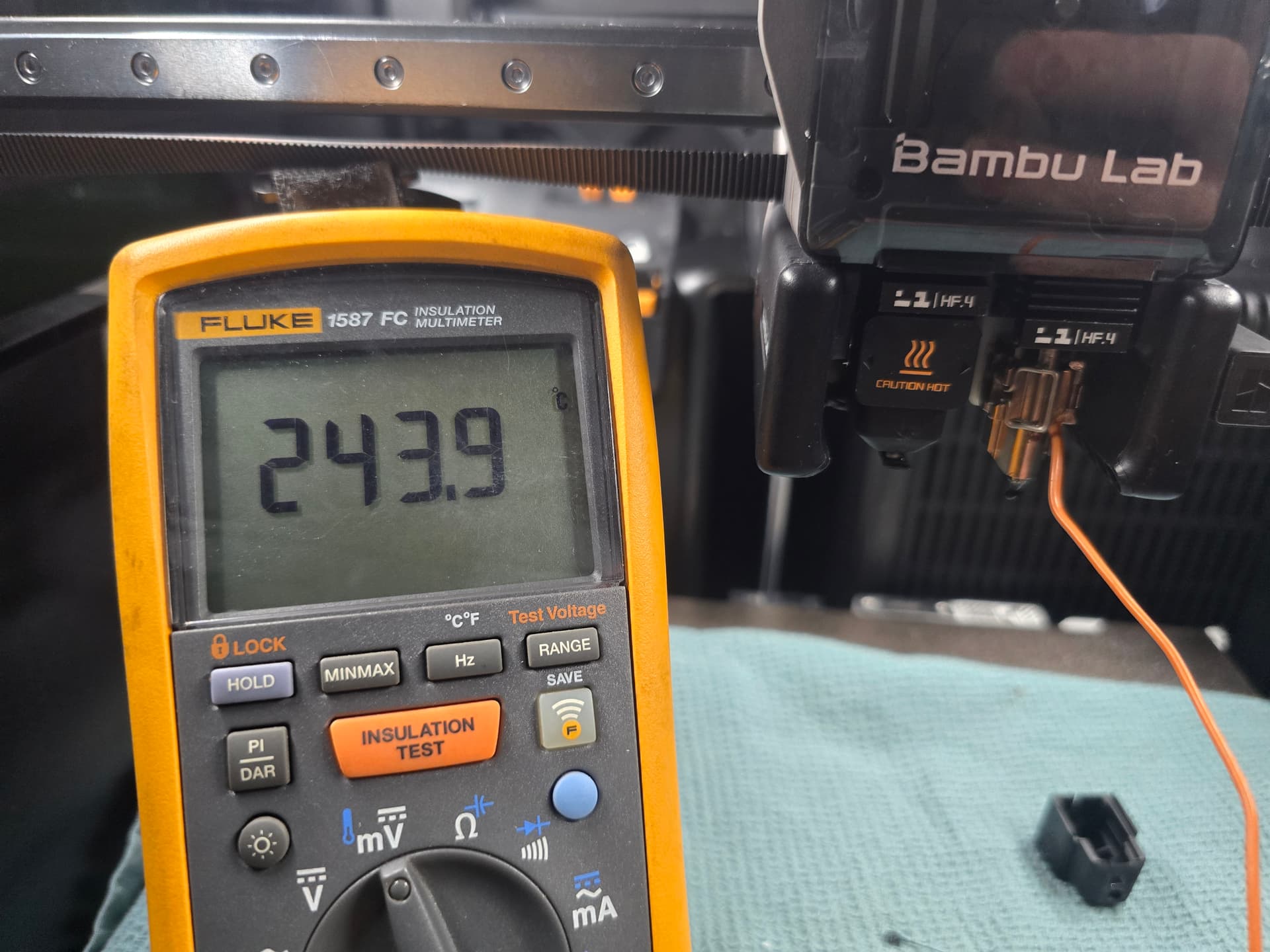

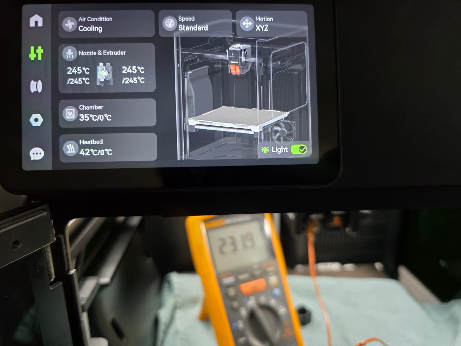

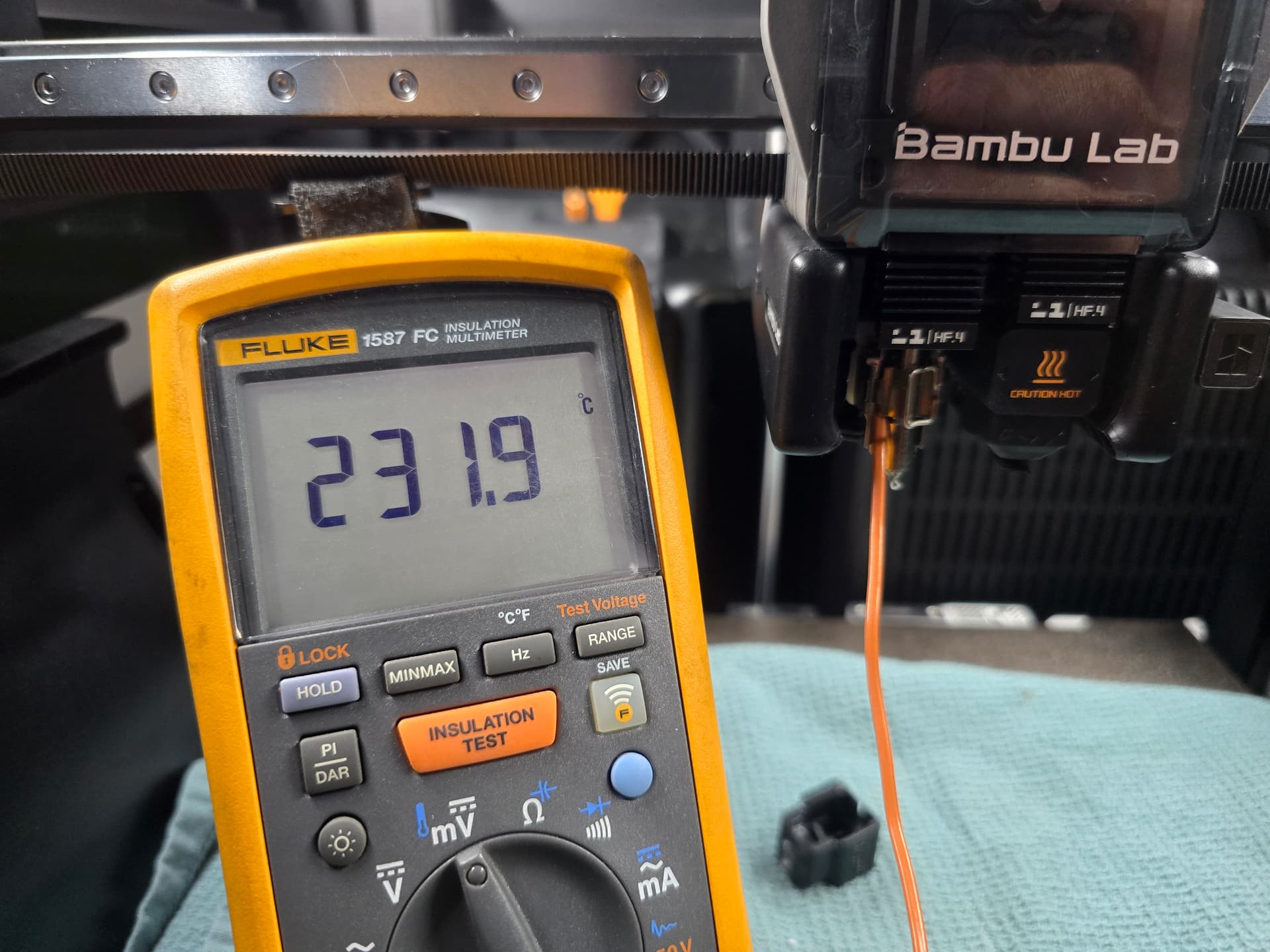

I recently found mine doing this on the left nozzle only. And that nozzle is not reading the correct temperature. Maybe try raising your temperature for the filament 10° and see if that fixes the issue. If so then you might have the same issue I’m having. If that works I wouldn’t say it’s a permanent fix, but just a troubleshooting measure.

Just wanted to write back. I was hesitant to raise the temperature any further because I was already at the manufacturers recommended maximum temperature but shortly after posting decided to raise the temperature on the PVA print that had been stalling with this error. It has been printing overnight without problem. This appears to be the solution for my issue. Thanks!
Did Bambu support do anything about this or is it just a quirk of the H2D that needs to be accounted for with print settings moving forward?
With the various issues I’m having they just confirmed they are going to send me a new x-axis and toolhead. I would definitely not accept this as a quirk. You have some sort of mechanical or software issue.
