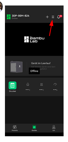

In bambustudio 1.9.7.52 the printer is marked online, but the wifi logo is shown grey with red sign. In the app the printer is marked offline. I checked the network (is privat mode), logged off and on, turned printer off and on, tried orca slicer (same behaviour) nothing helps. Really frustrating.
what can I do else?
now printer is online in the app, but does not show any temperature etc. It´s shown in idle, but in reality it prints.

How? It shows this
as you see it´s online & offline!
Go into the hamburger menu.
Go to “Firmware Version”. Scroll to the bottom, select “I want to downgrade to a previous version”. Follow the prompts.

Well I do not have this Options
then try Settings-> General->Restore to factory settings, then see if it works. Eventually, you could update to the last version (prior to the beta one they’ve launched on 16 January). The firmware can be downloaded and installed via your sd-card, so you don’t need to go online with your printer. It’s the version I’m currently using and not updating it until Bambu decides to release one where LAN only mode is fully enabled.

Now Something strange happens, the printer does not respond at touchscreen anymore. Shut down and turn on, it works again.
Firmeare is 01.08.02.00
Now it connects itself.
