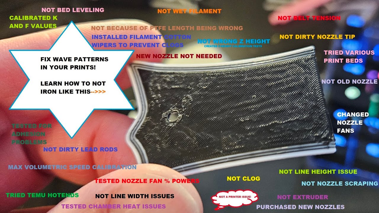

Failed print every time I use other plate
YES…
I FINALLY CAN PRINT lithopane and it is great quality.
ALL what I did is leaving door open for 10cm. And now all is ok.
this is a clear evidence of non-calibrated filament.
Also make sure MINIMUM layer height on textured plates are set to 0.12mm, not 0.1mmstrong text
