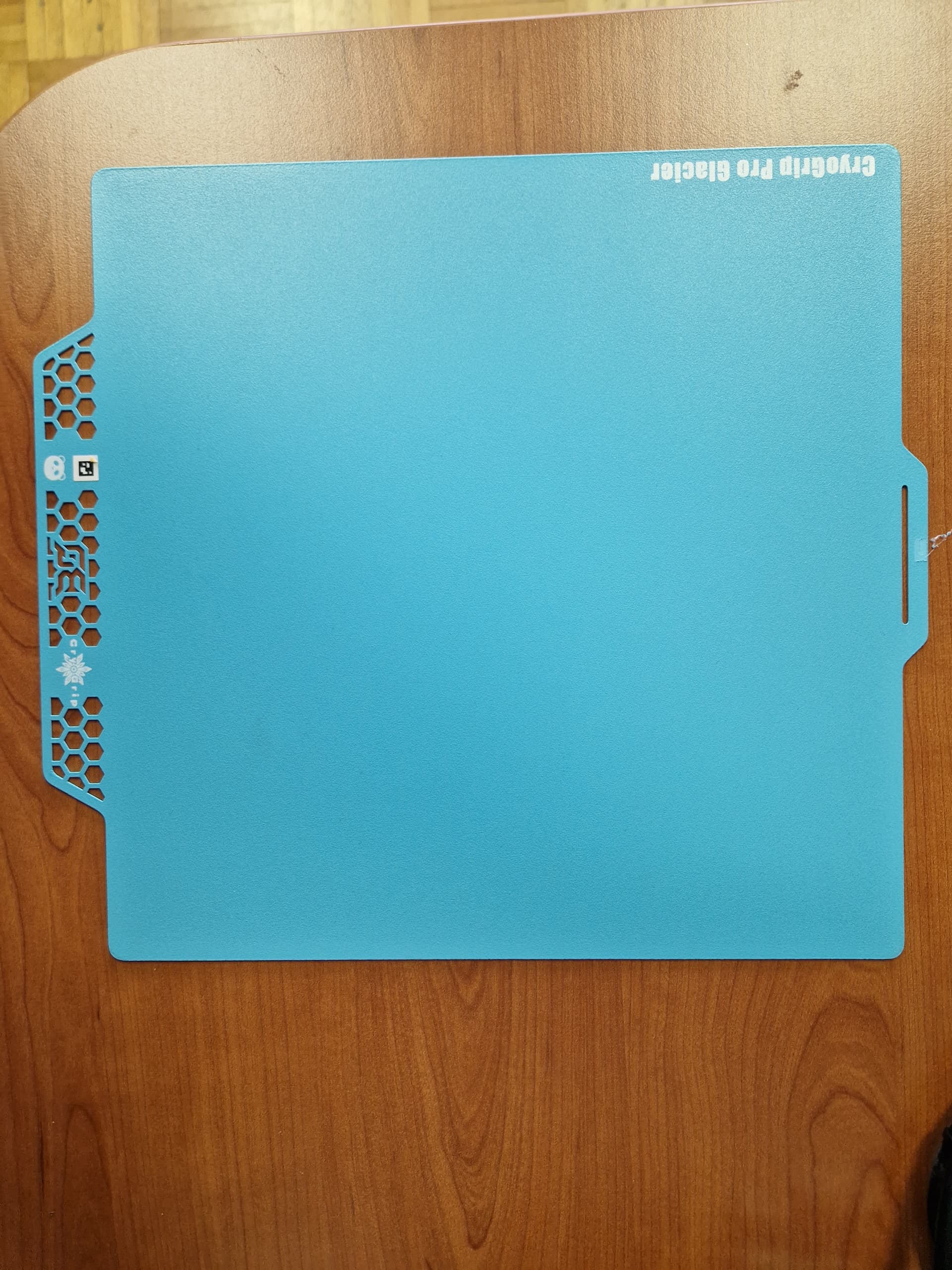

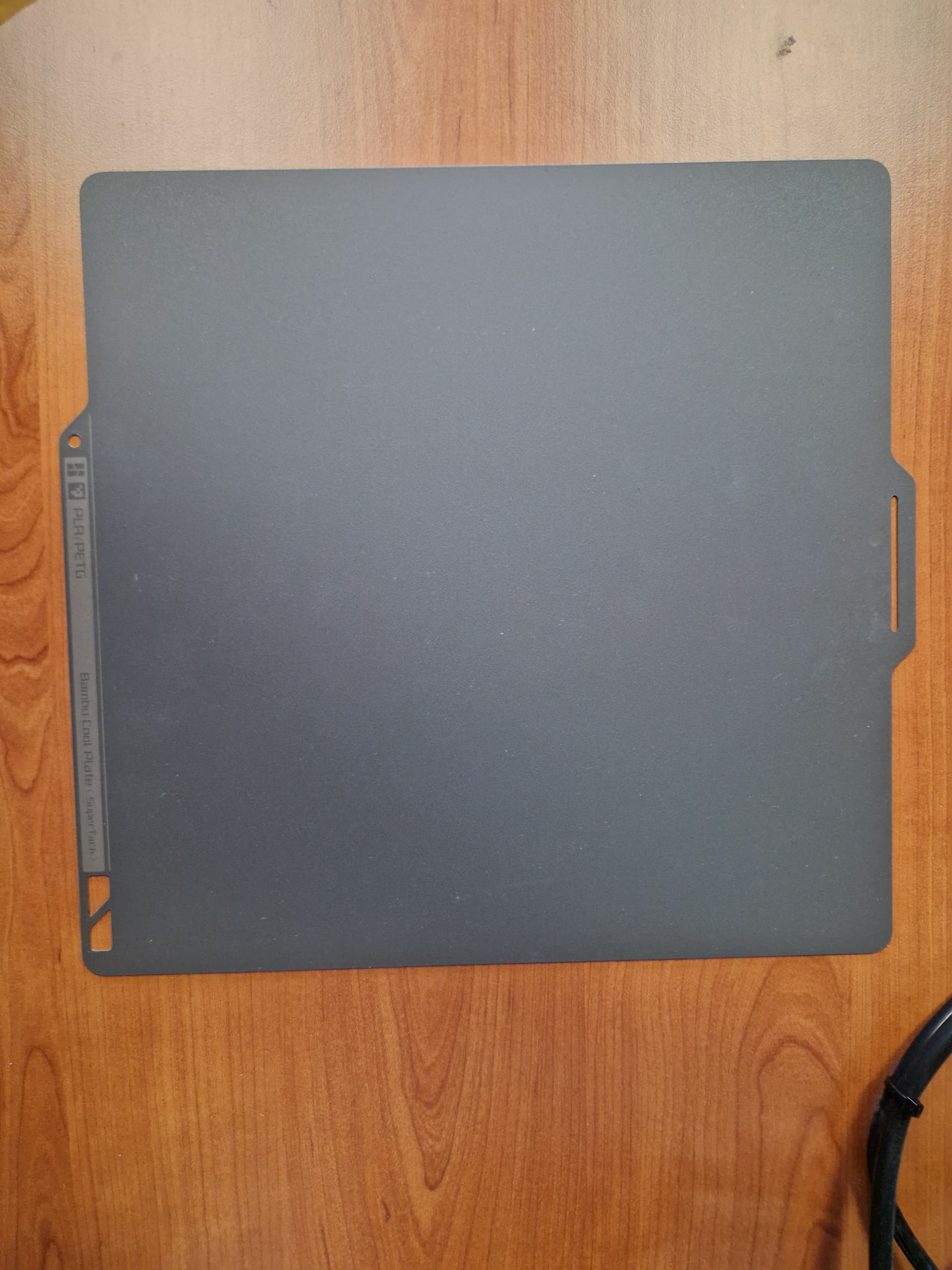

X1C. If I use default heatbed plate I get perfect first layer, but when I use cold plate or any other plate first layer is bad or really bad and that is everytime I print. Any idea what can be wrong???
Have you resliced for each print for the different plate?
with default you mean the textured pei plate? As @JonRaymond said, It is crucial to select the same plate in the slicer as you actually use. Especially the textured plates use a different z height than the other plates. That alone would fully explain why a print sliced for the textured plate looks terrible when you use a smooth plate instead.
I also level the bed again when I switch plates … :man_shrugging:
I never could get my cold plate to stick.
YES, every time, I did that for every plate
I did that I selected plate in slicer and than slice it and print it. Only I don’t know what to select in slicer for BTT cool plate.

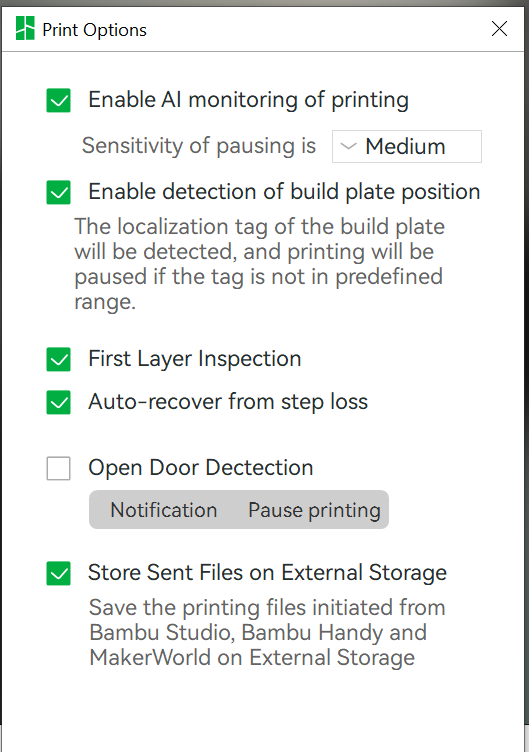

Make sure plate detection is turned ON.
I use many differend filaments and it was the same, like underextrusion or bad first layer print. I clean plate with isopropyl or sometimes with soap and water.
I have enabled this.
try to disable it, close program, open program and re-enable it.
I did it is the same, still not ok

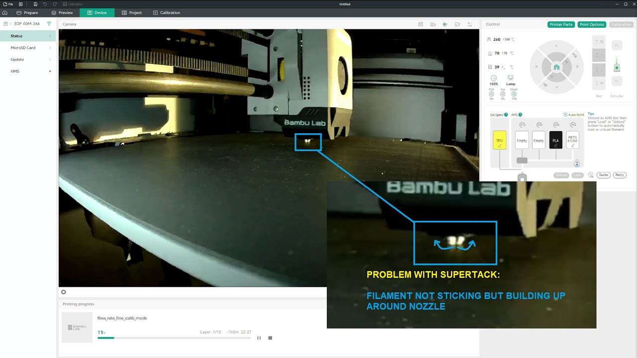

Here are new prints fo 10 times, every time failed, with nozzle 0.2
I really don’t know what is wrong. I cleaned nozzle fully 3 times and still the same.
Clean the plate with Dawn dish soap and hot water, using a soft-bristled brush to clean the grooves. Dry the filament and use a glue stick.

And it looks like nozzle gets clogged everytime. But before I printed 5 lithopanes but not now anymore.
Use Dawn dish soap!!! If you must use IPA, do it after the wash with Dawn.
this one?
https://www.amazon.de/-/en/Platinum-Powerwash-Spray-Fresh-Fragrance/dp/B01HJM6AY6/ref=sr_1_3?adgrpid=84648631080&dib=eyJ2IjoiMSJ9.w-gk9ElBNAM9JA_zPEV-0sPHo6gZuCAVaHvwd8d2OSkbkjgQo98lspotBaauCZcrvaiZCZHNHZyQDSNUe0_kL_zlwKxFFdgSNXvGm8A-qiZ3POBnZv6yuCtaCIcuCxh_14UP6UhdmeK8wH-pe5zIxD3srwjwH2uOR3yD79osTjqEieKG7ZQpNW9S_MECYYAve0pt9qasyljUGjD6eU53I4x9VoQ7VytKO7OWNgQSC2fzxfRI1NP_ca7HvsaYJCNeiCMyL5Mg2f7dPIRm_7W0QDt5MspIo6rOAzpcgU2WNIQ.-O0KsyV4oCiCF3b2qS69QoSDIR0fO30XT5nYHEtC0E0&dib_tag=se&hvadid=695801411465&hvdev=c&hvlocphy=9062555&hvnetw=g&hvqmt=e&hvrand=174842234669734902&hvtargid=kwd-1683753990&hydadcr=23806_2383553&keywords=dawn+dish+soap&mcid=39f2919ec7c03b3fa8a8b54dfcfe750c&qid=1751344403&sr=8-3
