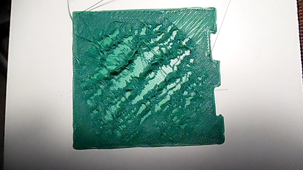

What is going wrong here. Have no idea myself P2S recalibrated and print worked as before. See photo of what printer made of it
Welcome to the forum.
The first layer seems to have been okay which would point at the printer printing too fast for the filament you are using or the temperature is too low.
What filament are you using?
Bambu Pla maretak green with the same settings als usual. Pla is dry 10%.
Check the thermal paste in your hotend as it does degrade over time (dry out) and won’t transfer heat as fast.
If you are performing a standard nozzle replacement on the P2S, make sure that the P2S uses a complete hotend assembly. However, if you disassemble the heating components of the hotend, it is necessary to apply a small amount of thermal grease for accurate temperature readings and efficient heating. At the moment there is enough fat present. In any case, thanks for your explanation.
I missed that you are using a P2S. They have a different nozzle system and the thermal paste thing isn’t as relevant.
