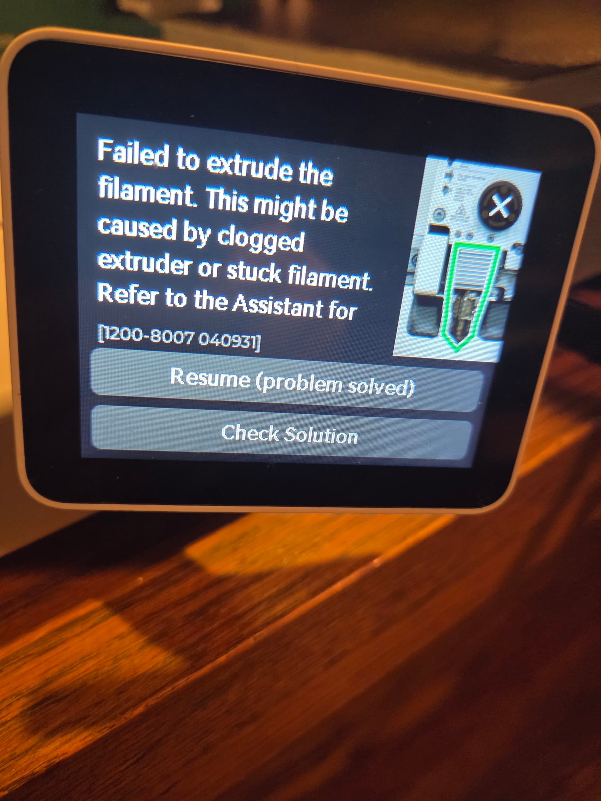

My A1 is saying “failed to extrude the filament” but the filament (Bambu PLA Basic) is definitely extruding. I tried reinstalling the nozzle. Didn’t work. I replaced the filament cutter. Also didn’t work. Even tried reinstalling the filament spool and that still didn’t work. What do I do? I’m using an AMS Lite too.

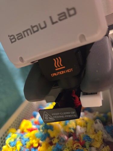

You can see in the 2nd image that the filament has been extruded successfully, yet the error message still pops up.

No, I did not install a printed extruder wheel. I disassembled and reassembled the entire exteuder unit but could not find a clog. Also power cycled but same issue.
