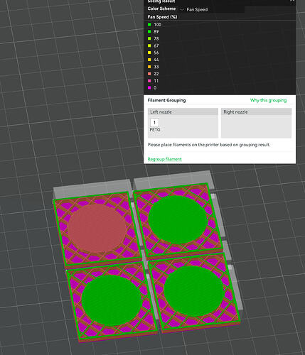

So I was printing something simple with a hole for a magnet.
The result was not great in terms of bridging so I spend a little time playing with Bridge Flow, Bridge Speed and Fan Speed for overhangs.
Doing so I noticed something that I don’t understand.

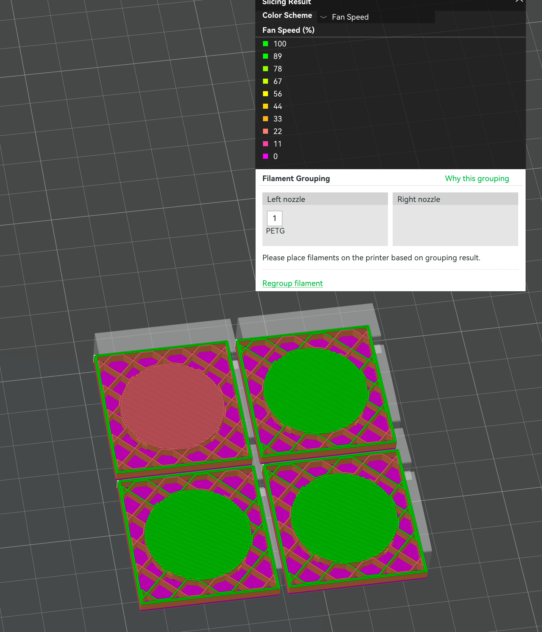

I sat the Fan Speed for Overhangs to 100% and when I sliced it and looked at Preview-Fan Speed I can see that indeed the fan is set to 100% for the bridging.
What I don’t understand is that when I then clone the part and slice again - Fan Speed at 100% is only applied when printing the second part.
And no matter how many clone’s I add - the first part that prints has default fan speed whereas the remaining parts has fan speed at 100% during bridging
If I select Print Sequence By Object all parts print with default fan speed (i.e not at the 100% Fan Speed that I entered in the filament settings.
Is this the normal behaviour and if yes - is there an explanation as to why?
Are there other settings that I need to configure to have all parts print equally?
My printer is an H2D with the latest released firmware and Bambu Studio is 2.8.2.60 ( I did not try this on earlier versions of Bambu Studio)
This is probably a bug in your version of Bambu Studio: When I open it and slice, it displays it correctly:
The difference appears in the first 2.8 series beta release, v02.08.00.50.
In the preceding public release, v02.07.01.62, and previous versions, the fan speeds are shown correctly.
