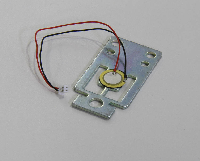

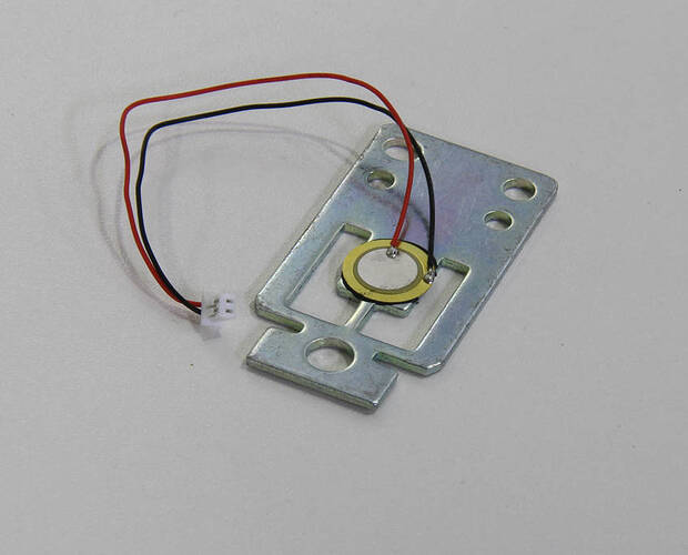

That’s physically impossible. There are no load cells. It uses three small piezoelectric transducers as sensors which react when nozzle bumps onto the build plate. They work on a rapid change only, cannot output any DC or measure actual force.
But I agree they could do tramming process better and integrate it into the firmware rather than running a very dumb G-code. They could at least run verification after tramming was done.
Also known as a piezoelectric load cell.
Not at all. Load cells are generally made of force-sensing resistors mounted on a special frame. These piezoelectric transducers are basically buzzers like used in electronic watches and other stuff to emit simple sounds. But they work both ways and can sense vibrations too. Over your wiki link, if you read description those can only work for dynamic loads. An nope, these are not piezoelectric load cells, these are glorified buzzers glued onto steel frame. Piezoelectric speaker - Wikipedia

I stand corrected, thank you.
I did a little experiment. With the bed lowered, I activated “return to home” on the printer. As it was lifting I placed a heavy weight on the bed. It stopped briefly, as one might expect, and then started to lift again, ignoring the load. This just about proves you right.
