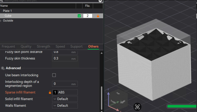

Can’t choose inner walls, but you can pick material for infill. This was added in the most recent release of Bambu Studio. Bambu Studio V2.4.0 Release Note | Bambu Lab Wiki
Oh nice, I missed that. That’s a step closer in the right direction. In fact, with a modifier the same shape but slightly smaller you could set 100% infill for the part adjacent to the wall and then whatever percentage you want everywhere else. Will have to give that a try!
Thanks for pointing that out - I would have missed it simply because I didn’t know there was a “developer mode” that had to be enabled to allow advanced settings.
