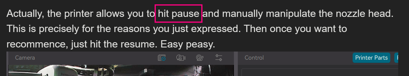

Actually, the printer allows you to hit pause and manually manipulate the nozzle head. This is precisely for the reasons you just expressed. Then once you want to recommence, just hit the resume. Easy peasy.
button

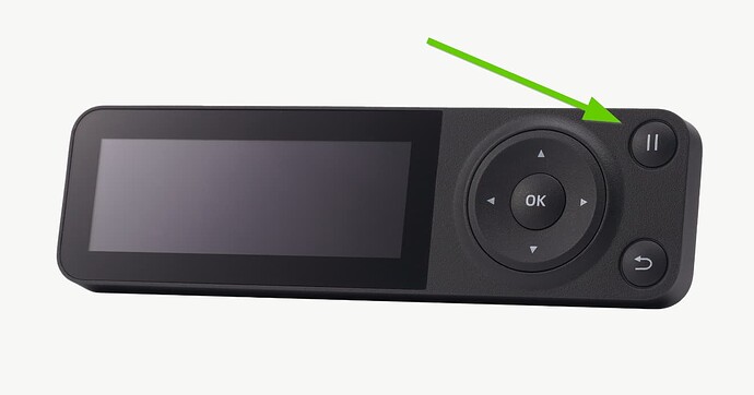

I would like to put in my support for said feature. When the filament pileup happens, I get a display on my screen that does not indicate that it’s possible to pause the print and then move the printhead with the navigation buttons on the control panel. I’ve been afraid that interacting with that error message will cancel the print job, and that’s the last thing I want to have happen. An option button to “pause print” would be helpful, I think.

is that just an x1 thing then, because my p1 just gives an error: printer is abnormal, unable to operate
If you can elaborate on what you’re doing before the error shows up, I might be able to help.
