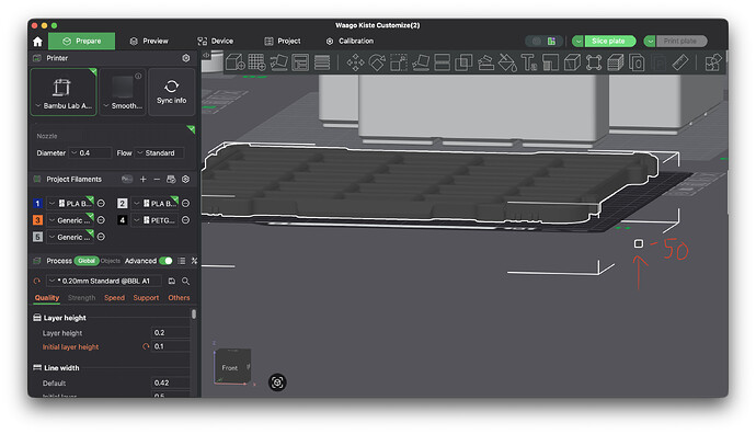

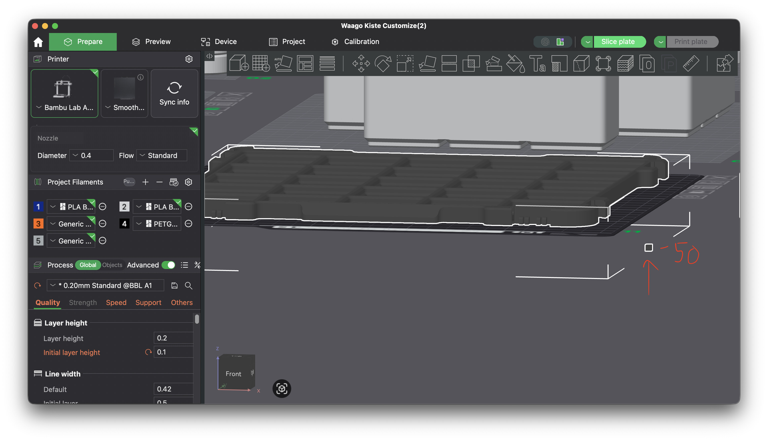

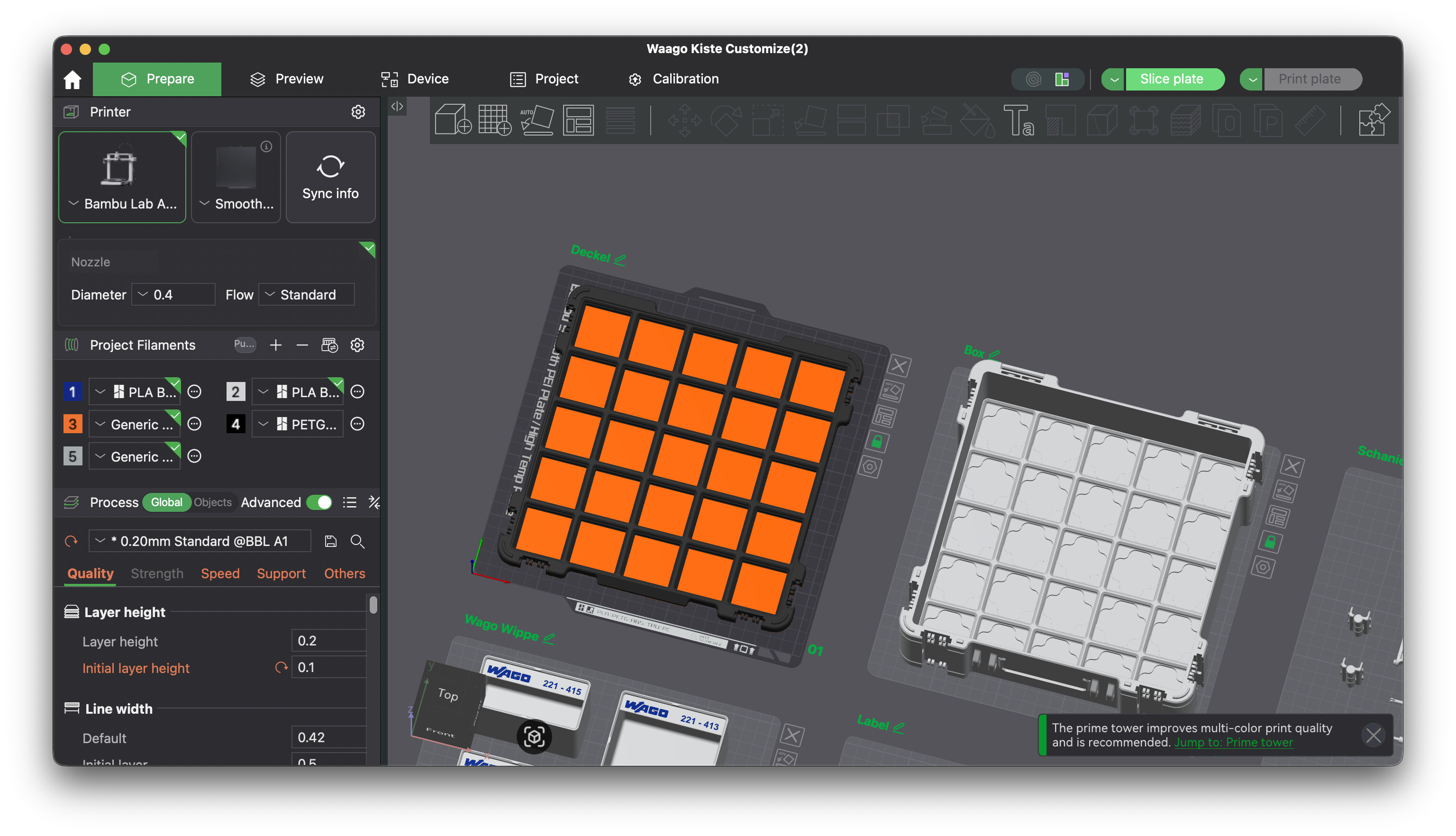

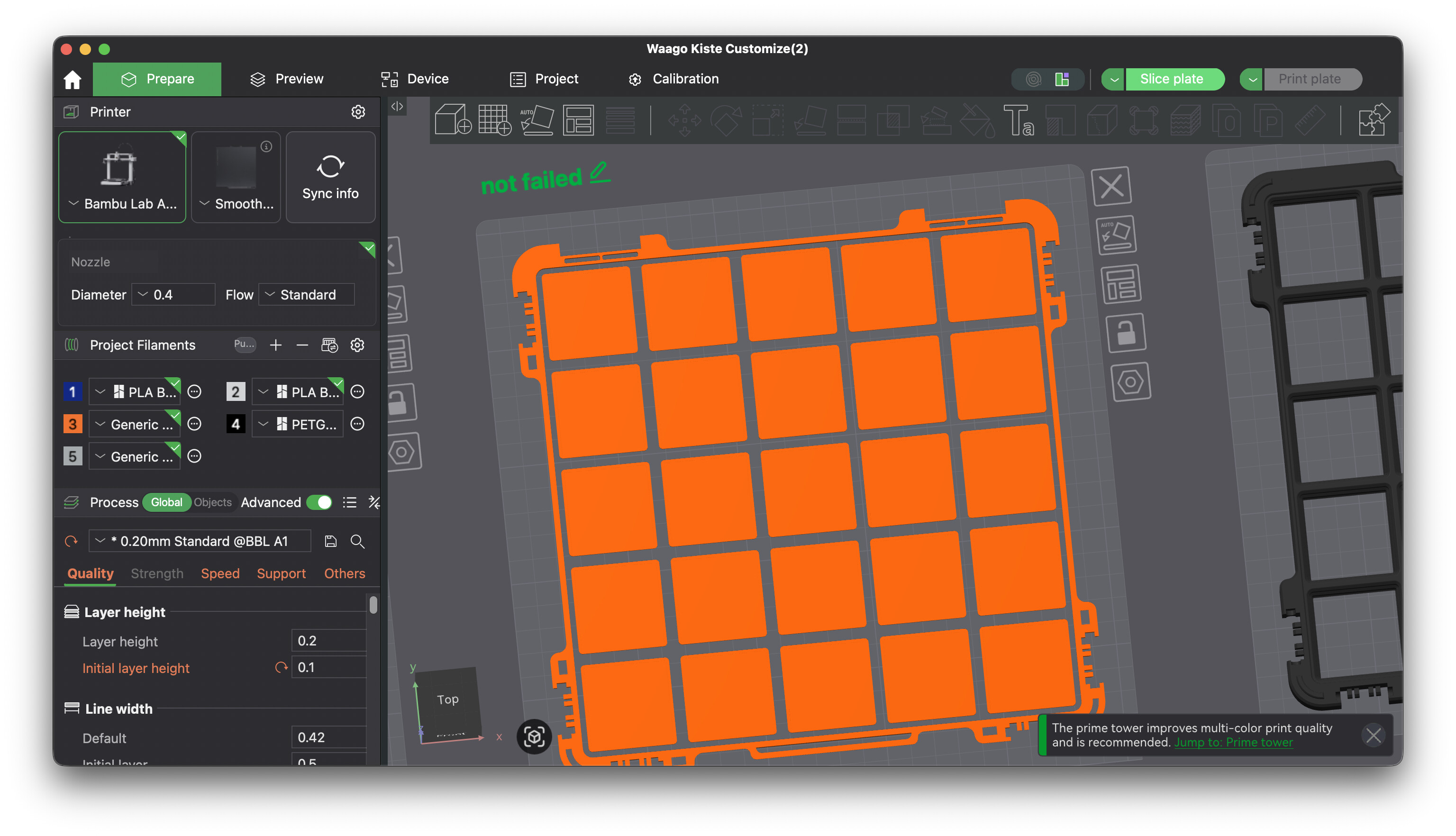

There I sliced the plate, but made sure the missing part was where it was before, floating in the air. To do that, group it with a small cube or anything really, and move the cube to below the print plate so as not to print it. This stops the object from falling to the build plate and keeps on floating.
