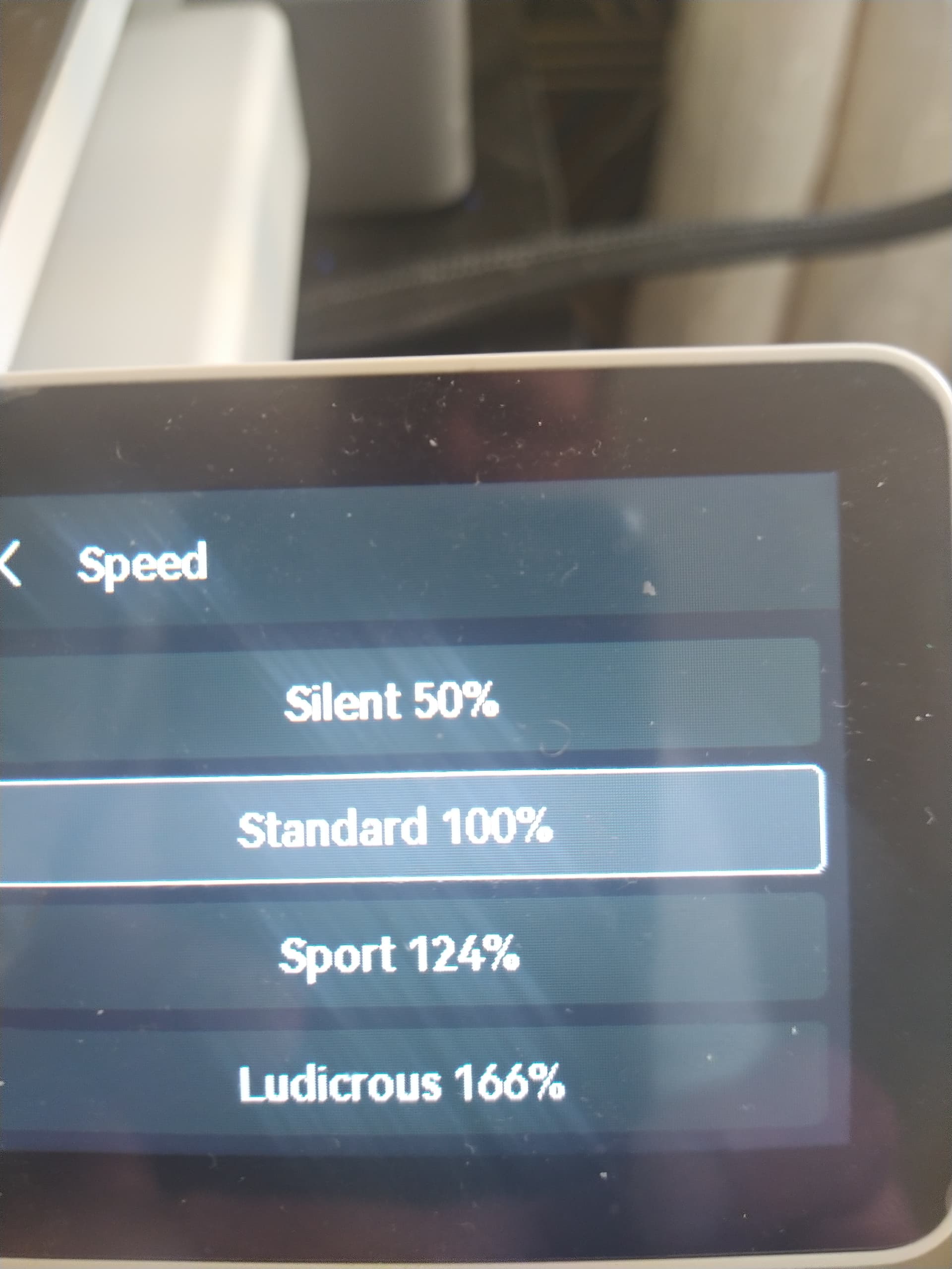

As far as I know there is no way to select Sport mode or Ludicrous mode other than manually selecting on the printer(or in the slicer) after each print has started or each time you open the slicer and there is no way to do it for certain parts or layers of a print. I can change certain speed settings for objects with modifiers but it would be nice just to say print this model in ludicrous mode as it seems to change a lot of things that just work. Ludicrous mode on the H2D with HF nozzles prints insanely good.

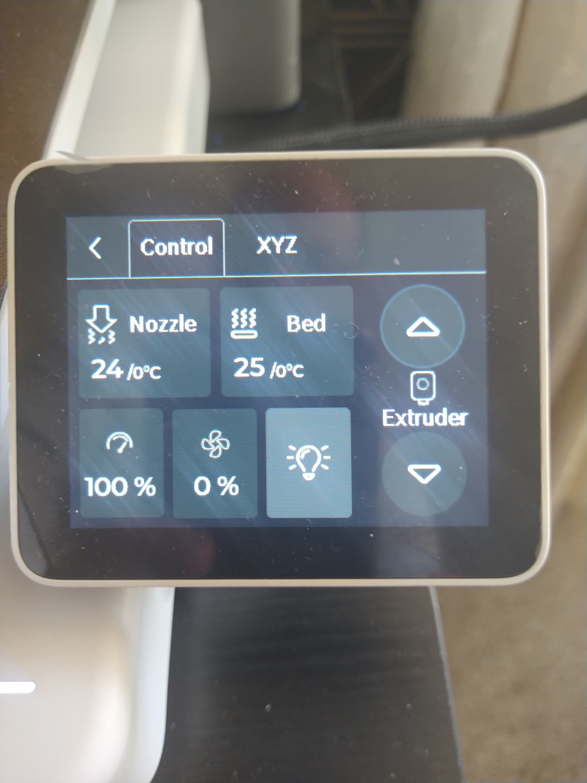

Bear in mind i use an A1, i changed speeds using my printer settings , control , 100% , speed, doing it manually offers the user more/better control
even more so during a print

I think you can achieve exactly the same by adjusting speeds and accelerations for that part in the process settings.
There should be no difference between activating ludicrous mode or increasing all speeds and accelerations by 66%.

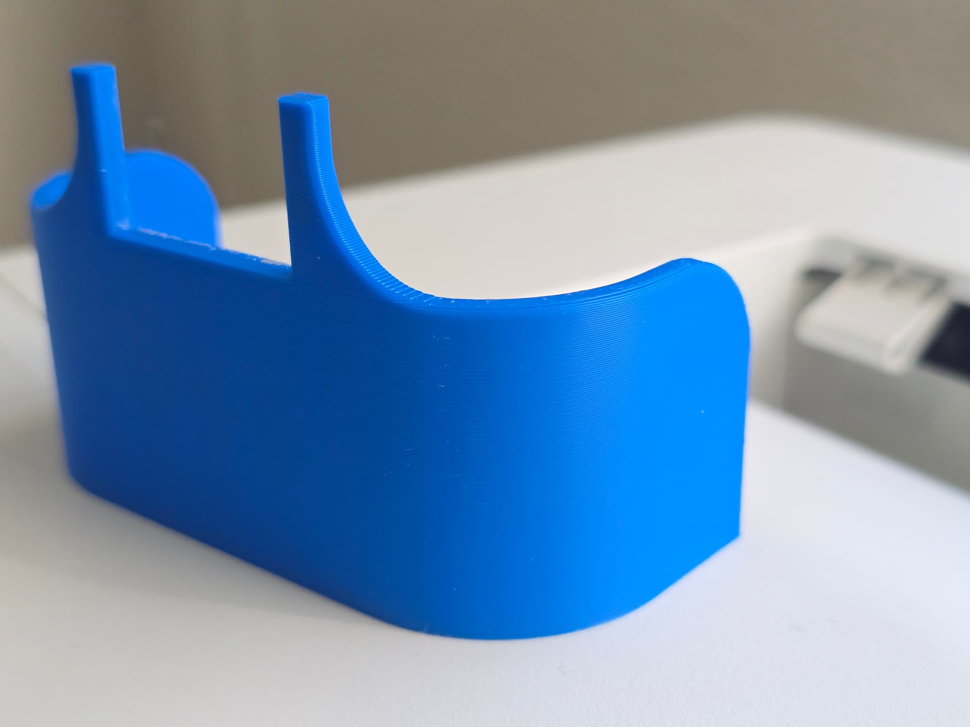

I know on my A1 mini Ludicrous mode is terrible. But with the H2D is prints really really well. Better than some other non Bambu printers print in normal mode. So for me on prototypes or functional parts the quality can be more than good.
Quick example from yesterday with the H2D.
This was printed out in Ludicrous mode with PLA, its a part I used to line up other items so there is some adhesive from the tape on the inside of the square section but this parts looks amazing.
For this part its not a big deal to hit ludicrous mode. But was merely showing it for the quality on the H2D. My A1 mini would need temp changes, etc to get it to print in ludicrous mode and I still have not had good print results in ludicrous mode on the A1M. Sport mode Yes. H2D different story.
