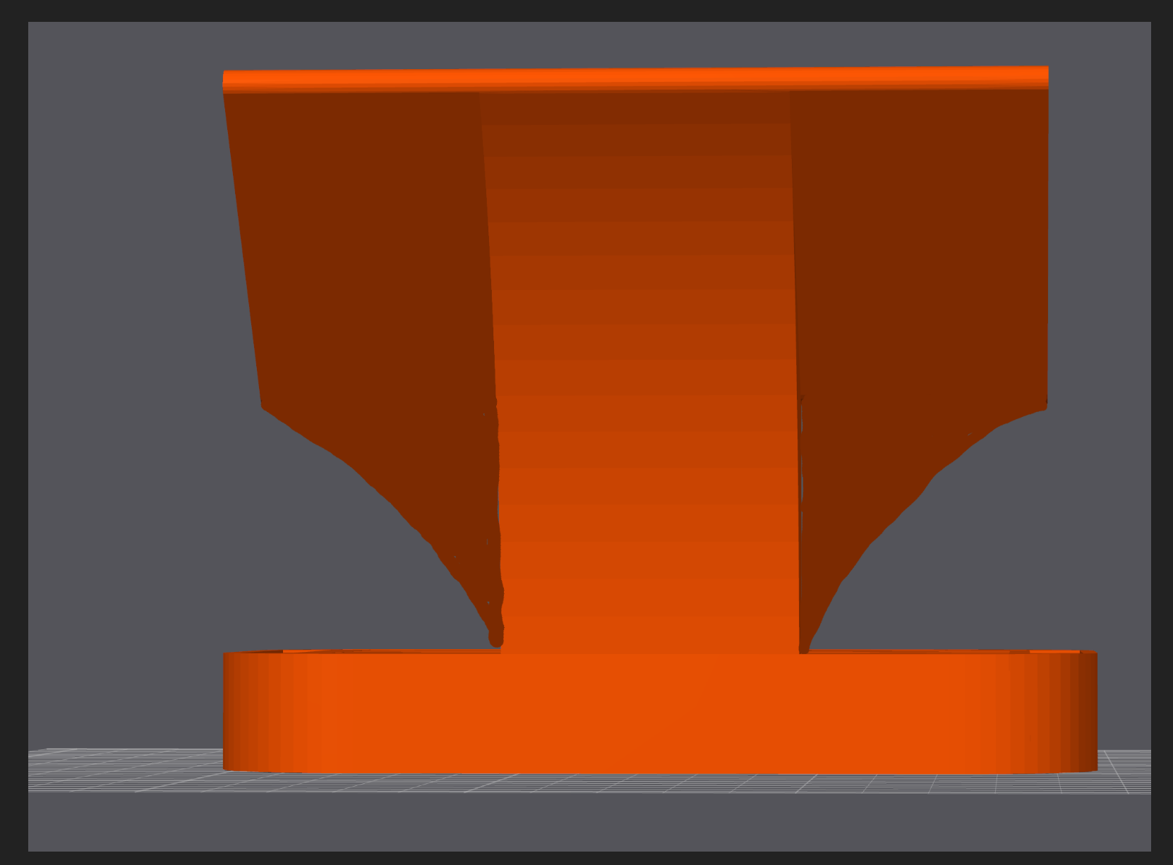

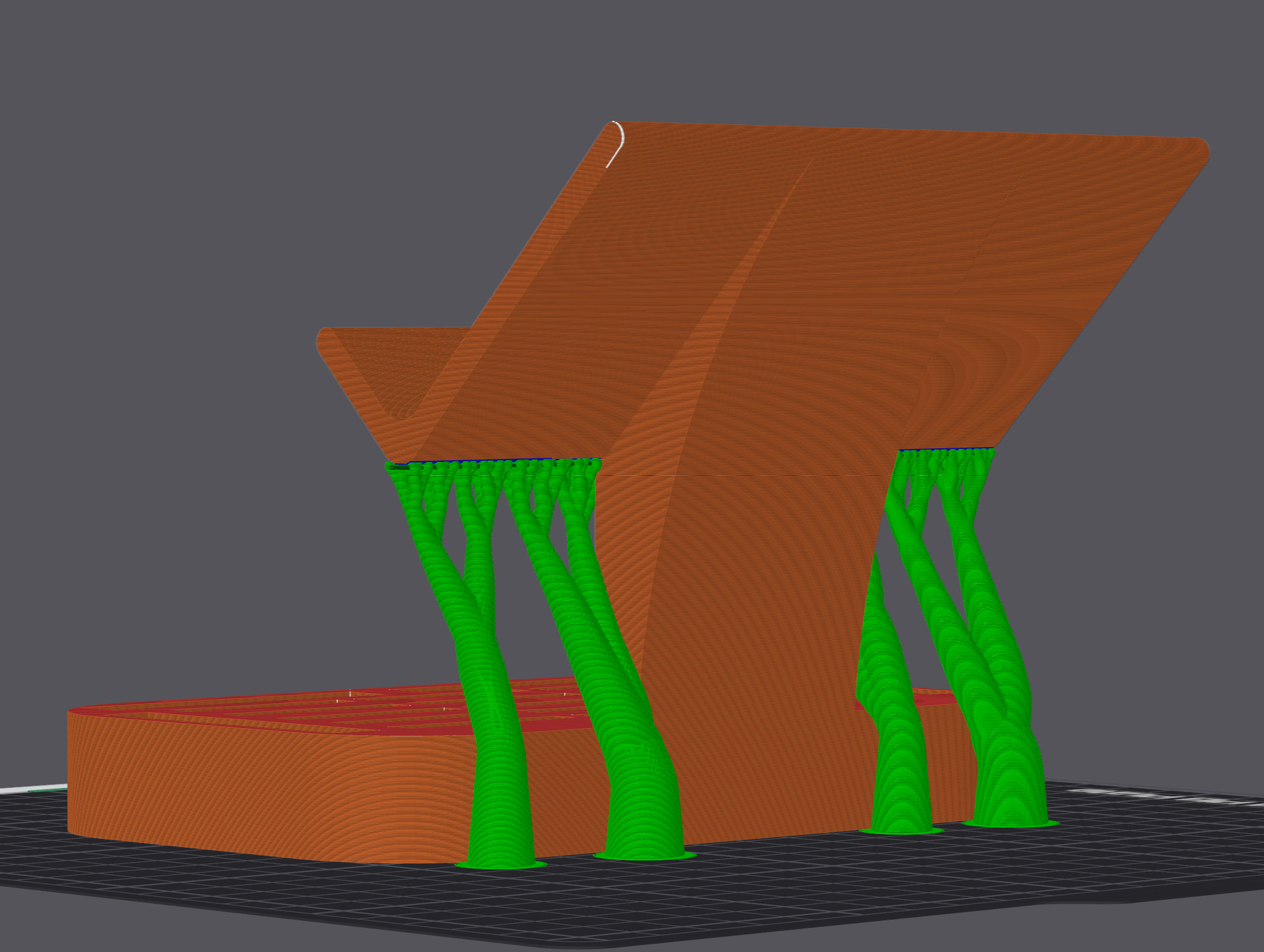

Let me explain what I mean using Ds Lite Holder as an example:
The holder needs support, but that wouldn’t actually be necessary if you make a few small adjustments:
If you round that off, you can print without support entirely:
You’re already on the right track and showing a lot of skill in CAD; all you need now is to start thinking a bit more like a 3D printer: What’s possible? How can you avoid supports? What orientation should you use? Should you round off the edges? And so on. Definitely keep at it. :+1:
