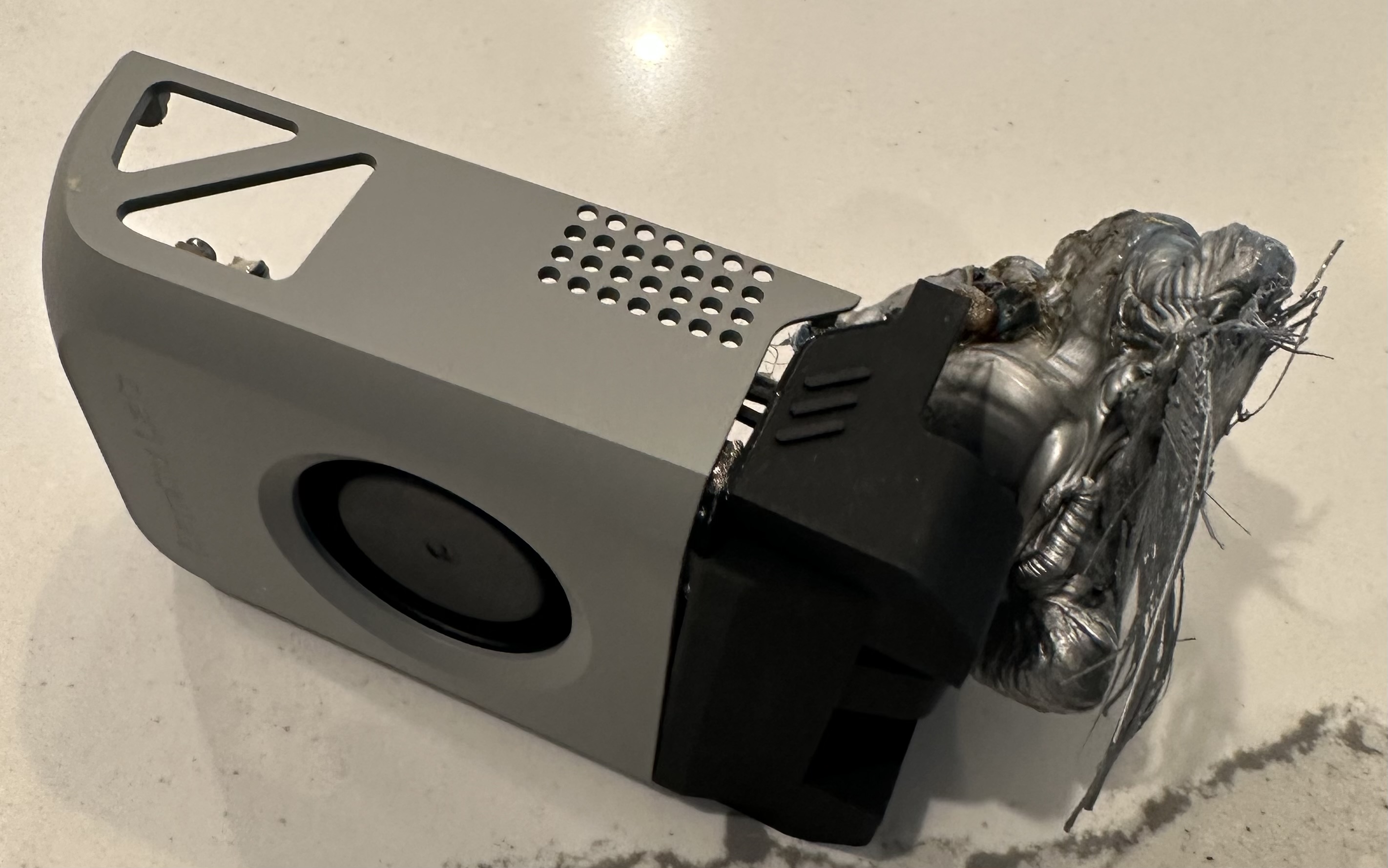

Filament buildup on head
—said as Arnold Schwarzenegger— it’s not a tumor.
Well actually looks like it is.
How does this even happen? I thought there was a sensor if the front of the tool head pops off??
I’m not even sure how to get this off of here.
Ouch.

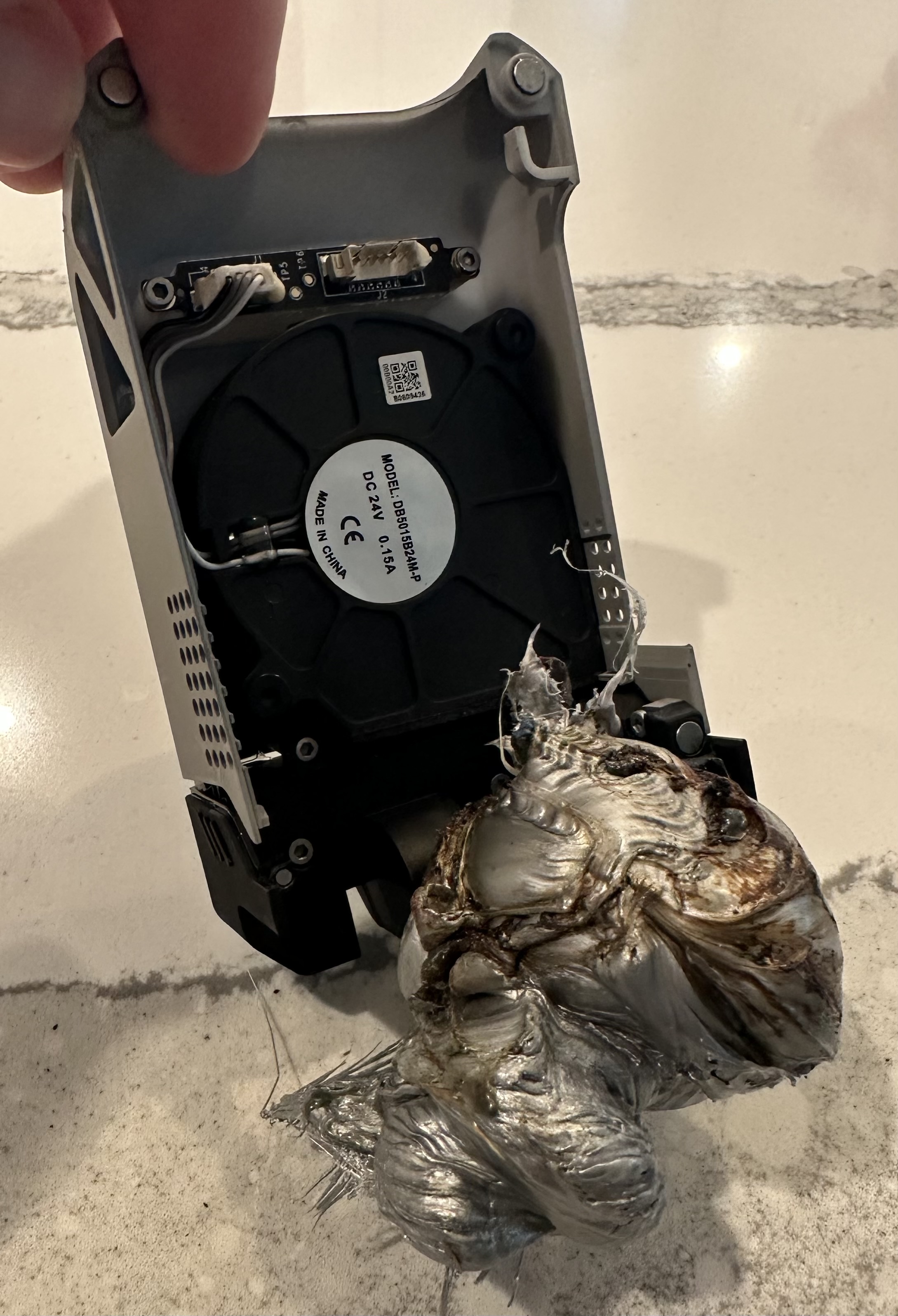

It looks like you are missing a magnet. If it is still stuck to the print head then you may have the misfortune of 1:4 chance it is a mag switch and that one told the printer the cover was still on.
Anyhow…

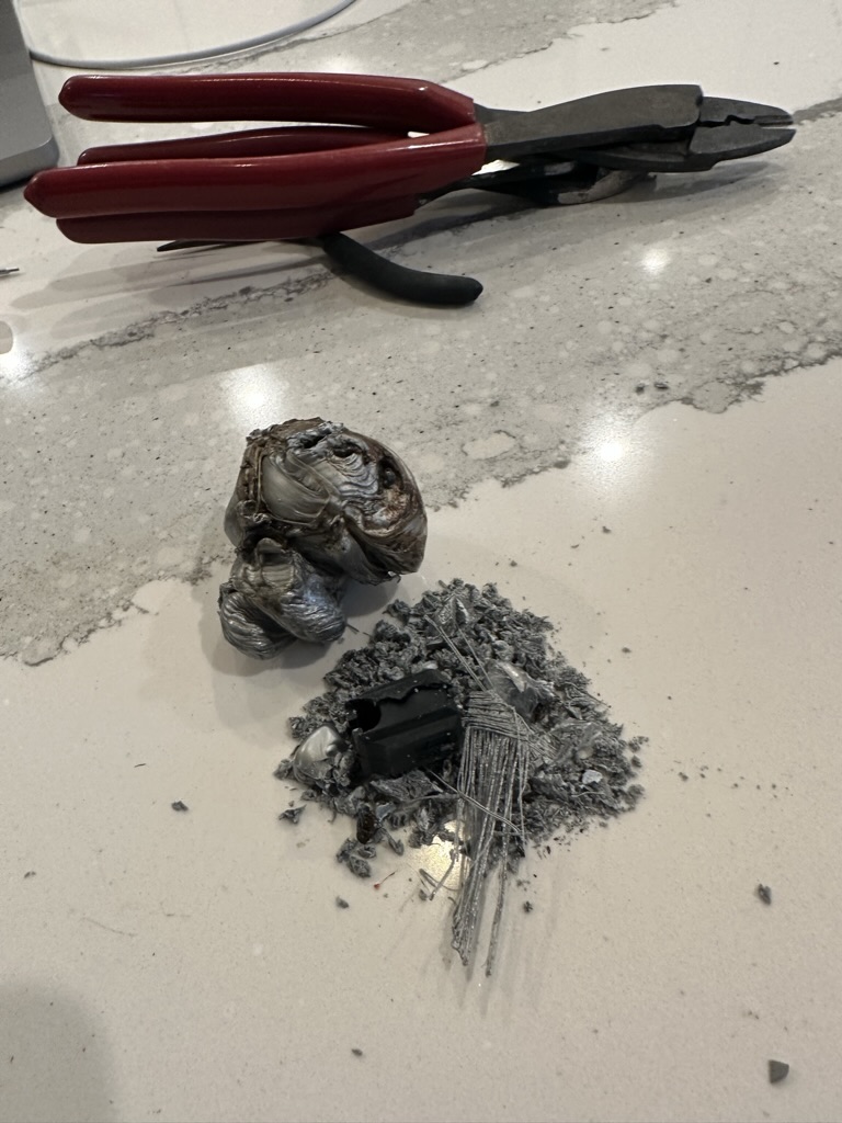

Start by cutting off the bulk of it.
When you get closer to the organs :face_with_peeking_eye: be careful. If it got into the fan, the it is a write off and get a new one. A heat gun and needle nose pliers may help to soften it and separate it from the housing.
There’s 35min of my life I won’t get back. LOL
Back up and running. I’ll have to look to see where the mag switch is.
Please don’t share those pictures again. They gave me nightmares. :see_no_evil:
In all seriousness, did you figure out what caused it?
Basically it came down to a 1st layer issue. And it just kept going. I need to figure out why the sensor didn’t trip when the front cover came off.
