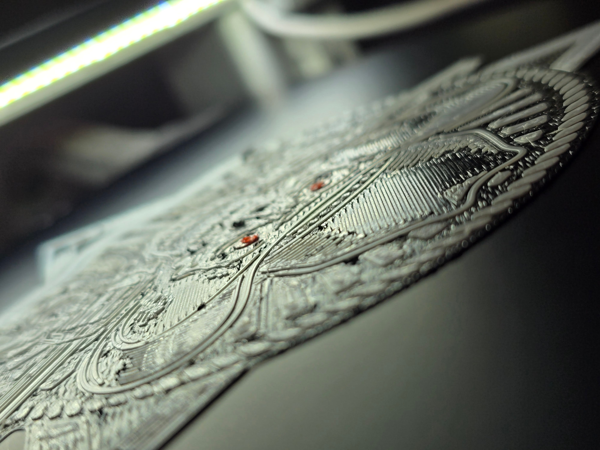

A1 Mini, PLA, Bambu PEI Smooth Plate, 65 deg bed, 220 deg 0.4mm hardened nozzle. Ran it at 100% speed and at 50% speed for the first layer. Pic is of 50% speed which looks way better than the 100% was. See filament “bumps” in pic.
I’ll be honest: I can’t make out much in the photo - it’s so blurry and taken at such a weird angle.

Are you referring to the red parts ? that looks like its the same layer height as the rest ?
stop and start of a small singular layer part , the rest looks pretty nice , is the original an engraving ?

maybe an arrow or a highlight to what you consider wrong? I see layer 1 completely on the plate, and of the next layer there was a filament change to white, laid down, filament change to red, a few small extrusions. pressed pause and now we’re here? The white is a little stringy on the top right, maybe a dry or flow calibrations are in order[more common] and/or retraction tuning [less common]
Got some more info.
It only happens on this model. One A1 Mini I have 1100 hours, the second I have 480 hours so I have been around the block a bit. It seems this model has the nozzle put “dabs” of filament in the model’s first layer, so sometimes the filament leave a little “tuffs” or “peaks” rather then a clean break.
The second layer I see the nozzle “knock off” the little peaks onto the desk. I have reprinted some complicated designs with no such issues. It is a minor inconvenience but I can’t lay it at the printer’s feet yet. I will, however, look into “retraction tuning” as maybe that could be an issue. I am not sure what that is so I learned something new. Thanks for all the input!
