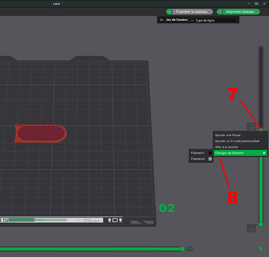

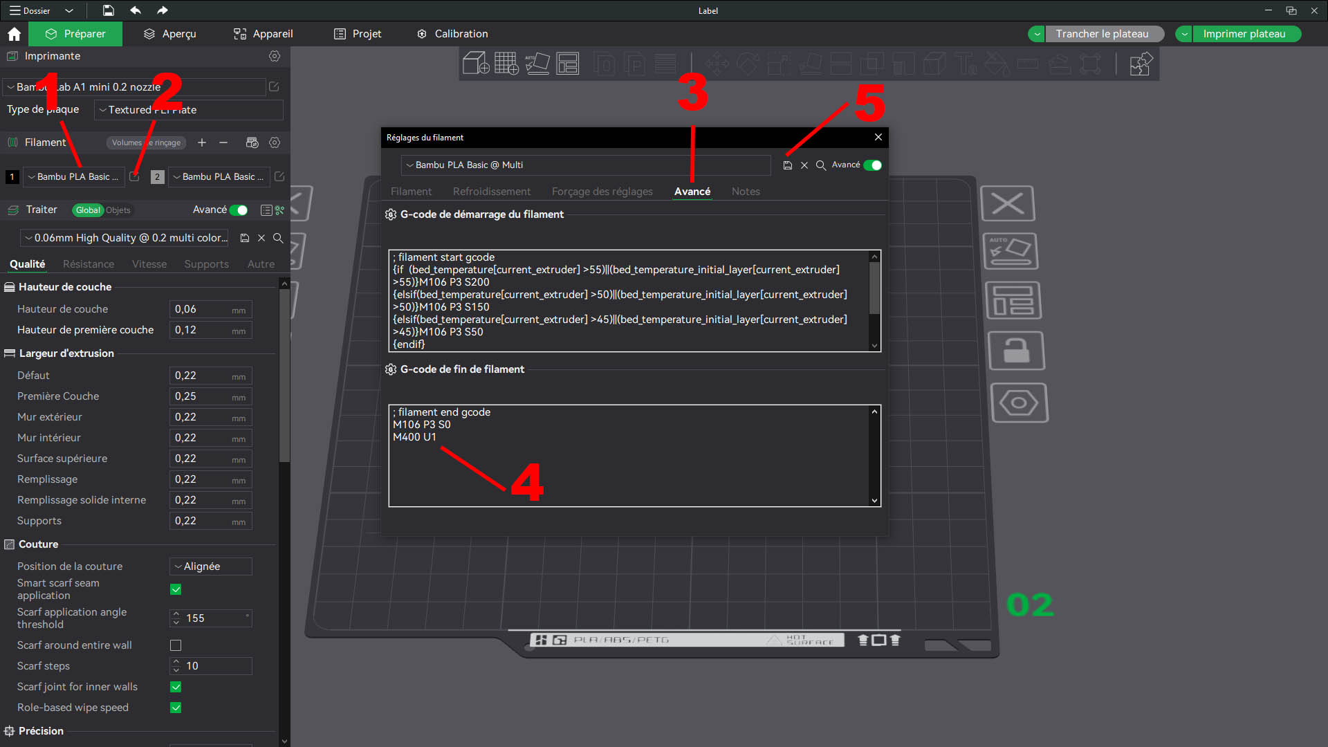

There is a very simple method to change filament during printing.
1 - Choose the filament you want to use.
2 - Click on the filament settings button.
3 - Click on the “Advanced” tab.
4 - At the very end of the “End filament G-Code” window, add “M400 U1”.
5 - Save the setting by adding “Multi”, for example, and select this filament.

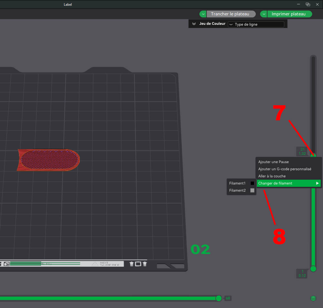

6 - Slice the plate and choose the layer where the second color should start.
7 - Right-click on the “+”.
8 - Choose “Change filament” and select the second filament.
Start the print, and when it reaches the selected layer, the printer will pause.
Then, simply change the filament as usual (through the printer’s filament menu) and once done, click “Resume printing”.

Technically the M400 U1 method works, it pauses and let you change the filament, also you just need to put it on the filaments you are switching from so if you are only using two filaments one to start with and one to finish you only need it on the first.
But it doesn’t seem to change any print settings related to filaments.
I did a small experiment, started with PETG-CF which prints faster and at 255c then I switched to TPU that prints slower at 230c but after switching filaments speed and temperature remained the same as the first filament so all it really did was pause the print to let you swap filaments but no other logic than that?
You’re absolutely right, the last filament must be a “normal” filament that doesn’t include the “M400 U1” command. It’s a mistake on my part, and unfortunately I can no longer edit my post.
Regarding the use of different types of filament, I confess I haven’t tried it, but this command only manages the change itself, not the change in printing characteristics linked to the filaments.
I tried this filament change g-code instead and it works like a charm!
It actually changes all the filament parameters, I had to lower the flushing volume multiplier in Bambu Studio settings (you are purging anyway when doing manual filament change) or it would be flushing for quite some time.
