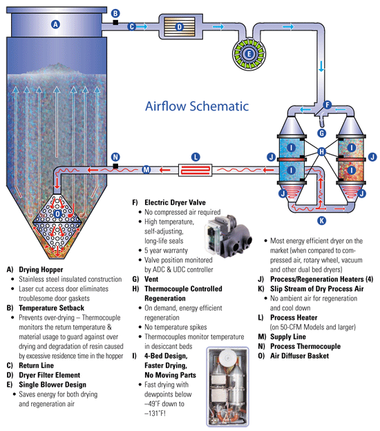

Hey @NeverDie - was looking to see if anyone else might use air drying in the plastics industry and yes they do. They don’t have much in the way of real details but use desiccant beds to dry air that is used to condition plastics before injection molding. They have all sorts of sizes and capacities and the customer testimonials are interesting. There’s even a truck fitted with their units that is available for companies that get “wet” plastics or something happens that raises the water content. They automate desiccant regeneration with a dual arm / 4 bed design. They also have compressed air dryers but not much detail. They want to talk directly it seems. Still, it looks like this was all pioneered years ago.
https://dri-air.com/
When I last went looking the least expensive brand new ones I could find cost around $1,000. IIRC, that delivered around 5 CFM of ultra dry air and achieved continuous duty cycle by switching between columns. When one was depleted, it would switch to the other and recharge the depleted one.
Worthy of note in the picture you just posted is the “Fast drying with dewpoints below -49F down to -131F.” Left unsaid is whether it dries the plastic pellets all the way down that low, or whether it uses air that dry merely to speed up the drying process. I still haven’t found a satisfactory answer to that question.
The dew point defines at which temperature would be able to condensate.
It is NOT any fixed temperature you could measure in the system.
It is a very important value with no real merit - sort of.
In a humid environment water will condenses on a surface or on particles/droplets in the air once the temperature goes below the dew point.
You can see this nicely in the summer when you grab a cold drink from the fridge.
In a closed system not only the dew point matters but also the air flow and possible restrictions where turbulences might form.
Your system might be still far away from the dew point but in a few small spots it might not - condensation happens.
A large difference between operating temp and dew point ensures that all moisture that is released will stay IN THE AIR - it can’t condensate anywhere.
The benefit of that is that the removal of this moisture can work much faster and far more efficient than with a dew point hovering 20 or 30 degrees higher.
