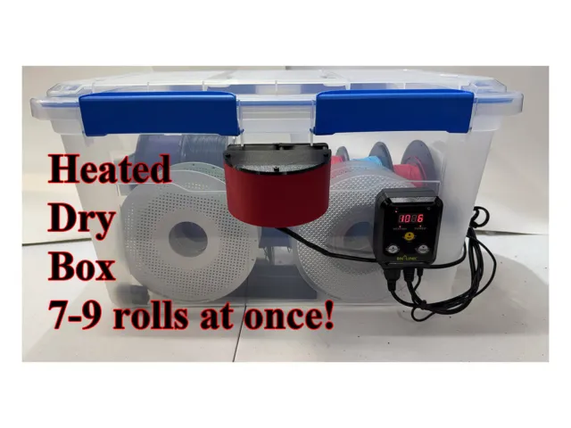

FWIW, I just today noticed this guy plugging his closed loop system on the anycubic models collection:
He claims it works, at least to his criteria of success. He says he’s heating his interior air to 75C. I have my doubts as to how thorough a job it does at drying, given the temps and the seemingly small amount of desiccant, but to his credit it’s also the first closed-loop hobbyist build I’ve seen to date.
He doesn’t give much detail but it should work. He did say he got humidity in the box down to 15% - fairly low but there are some issues I see. The fan is in the warm air flow and the desiccant gets heated. It’s probably hard on the fan and warm desiccant has reduced water capacity. I agree on the low volume of desiccant but he might be in a dry environment where he doesn’t have to change it out a lot?
Fans are happiest and last longest in cool air and at least silica gel beads have highest water grabbing capacity also in cool air. Never been a fan of heating silica gel beads unless you want to drive water out of them.
But no reason it shouldn’t work at least to some extent. I’d rather purge dry boxes with dry air rather than hang heaters and fans on them, though. Powerful heaters aren’t something I want to leave running unattended.
