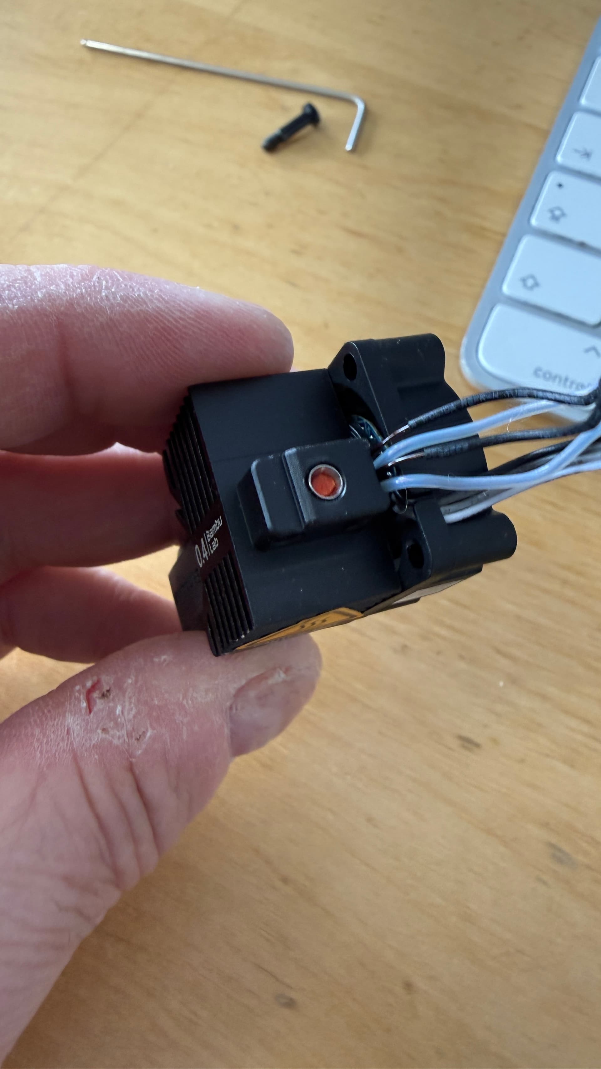

Is the hot end properly installed? Can you shine a light up from the nozzle and see it at the point where the filament enters the extruder?
That’s what I see in the new hotend… Isn’t the filament supposed to melt when it’s heated? I cranked it around 250deg. Could it be that simple? Now how can I get this outta there?
It does but the filament cutter can only cut the filament above the nozzle. This leaves filament in the nozzle which is purged out when the next filament is loaded.
You don’t need to but if you really want to get it out you will need to do a “cold pull”.
