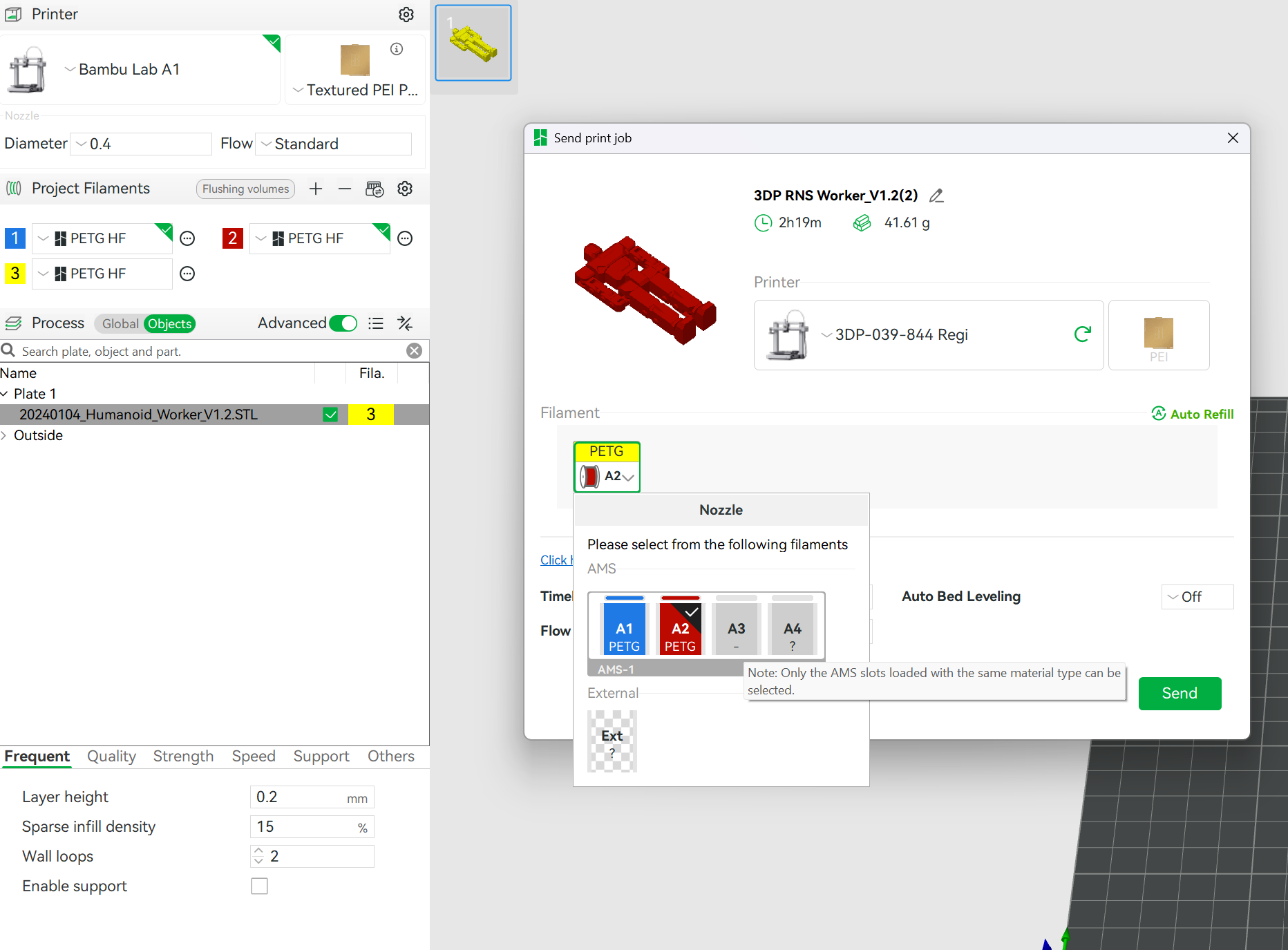

I synchronised filaments list and it showed it wrong, ok, then I did as you suggested and switched to the yellow filament N3, but still could see/choose onle between 1st and 2nd filaments only…
See screenshot below
Is it so that my printer has an issue or is it me who do not understand how printer and AMS should works together… :disappointed_relieved:
That, … is a bit strange…
Just to confirm: You have 3 filaments loaded in the AMS light? And assigned correctly through the printers touchscreen?
Then, this should display correctly on the device tab of Bambu Studio. This is important as in my experience with Studio (still using an earlier version due to increased bugs), it will synchronize filaments in the “Prepare” tab with those of the “Device” tab rather than the actual AMS. If there are differences between the physical AMS and Studio’s device tab, you’ll first need to correct that by double checking on the printers display that filaments are assigned correctly and verifying on the device tab.
Once assigned and synchronized correctly, you can actually use yet again another method to map filament colors: Select the model filament in the Project Filaments and a pop-up appears. Near the top are the synchronized AMS filaments.
Very quick and convenient, but it can get a bit confusing at first.
Thank you @EnoTheThracian and @DaLanMan for your help.
The issue with yellow filament was that I put it in the wrong one, it was in A4 instead of A3 so embarrassing… :joy: :joy: :joy:
So thank you all for your help!
