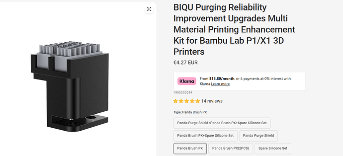

Ever since about 300 hours on my printer my filament poop isn’t going down the chute. Instead, it sticks the nozzle when it wipes and falls below the heat bed. I even replaced the nozzle wiper and the problem is still occurring. Any suggestions?

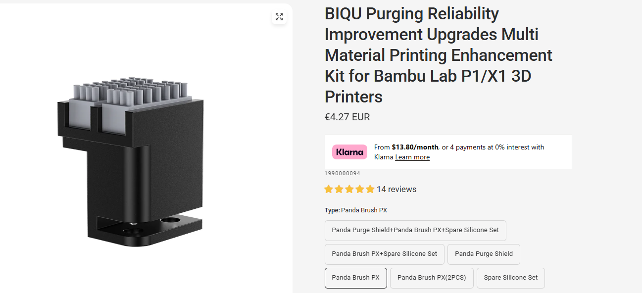

Ich hatte bei mir das selbe Problem.
Seit 2 Wochen habe ich den Panda Brush eingebaut und keine Probleme mehr …
The stock nozzle wiper is not the greatest. There are countless Nozzle Wiper models to choose from that you can print yourself and save some money over buying one.
I was having the same problem and decided to make one using an available model.
