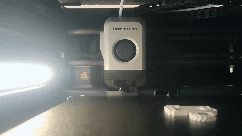

Filament leaking on Pause / Resume
Every time on resuming print after a Pause in Bambulab Studio, the nozzle is not cleared properly and the filament is leaking on the print, 100% time:ezgif-5f50147a92d18684

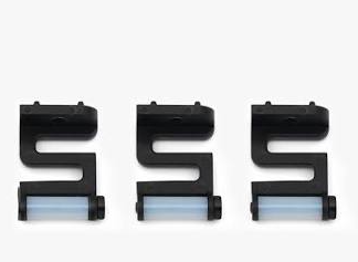

Change the wiping roller.
You should have a couple on the accesory box the printer came with.
Replacing the Nozzle Wiper | Bambu Lab Wiki
If you want to go aftermarket, check out @Leckiestein 's Steinwipe project. He designed a much better nozzle scrubber and accompanying machine profiles to give the nozzle a super thorough cleanup when resuming.
Also - oozing can be a strong indicator that your filament is wet, moisture is literally boiling in the hotend and expanding into steam, which pushes noodles of material out like that.
