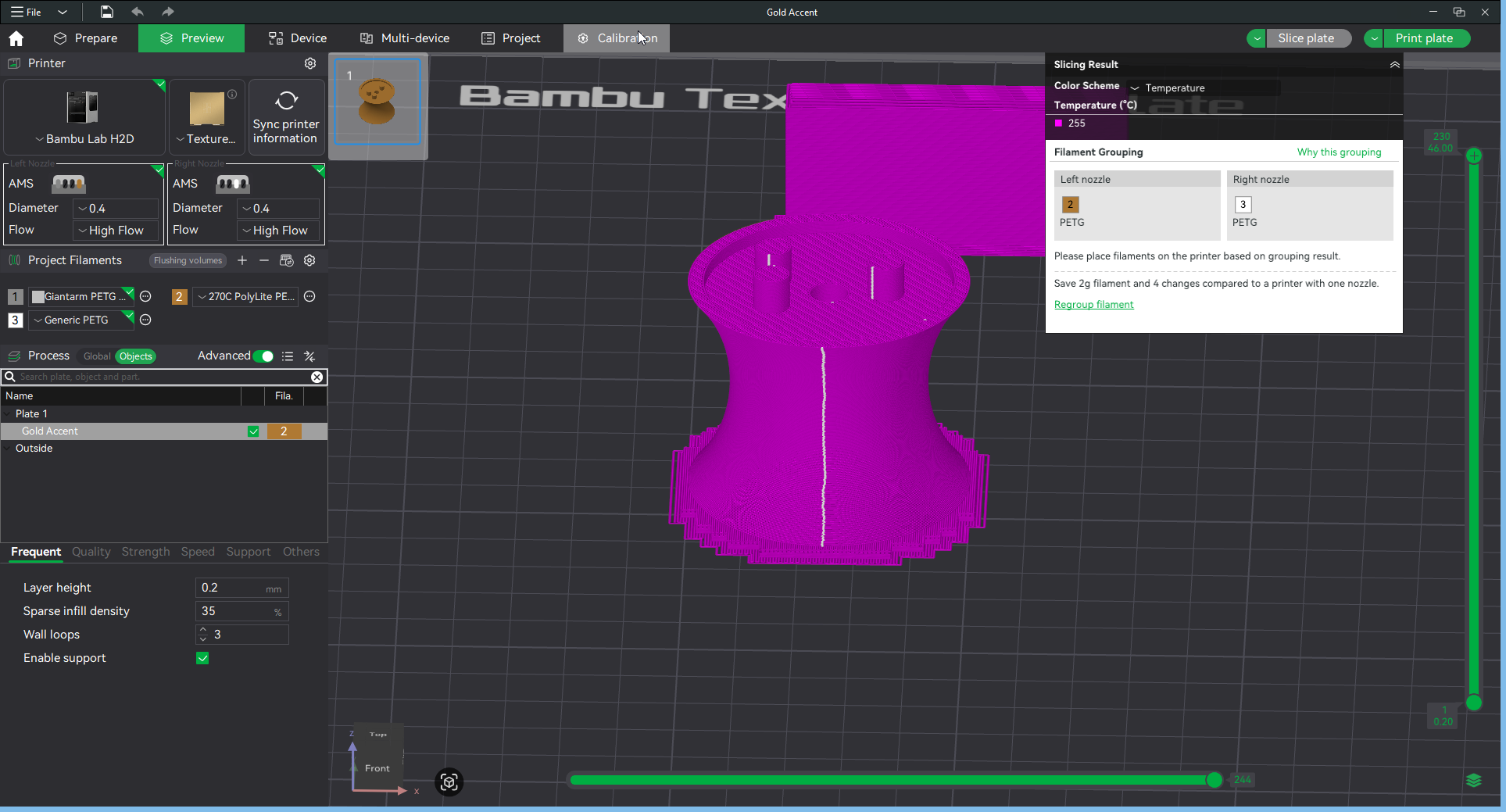

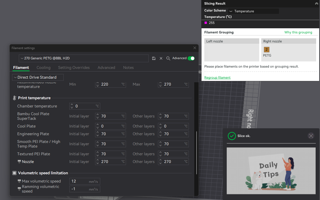

I’ve made a custom filament profile and I cannot get it do any temp other than 255 for the entire print, not sure if I’m just missing something obvious or it’s a bug? I just printed something at 270 and now with this file it just doesn’t work. 3mf file attached below
Gold Accent.3mf (409.0 KB)
Have reverted back to 2.0.2.57 and the issue remains. Tried making a generic cube and cannot get that to change either, however choosing a generic ABS profile does change the temp. I tried the live chat but was told that they aren’t technical staff and to submit a ticket. I’ll do that tomorrow and submit a bug report on github as well. I don’t see a ton of this here or on github so I’m curious if it’s something I’m missing? I feel like if we couldn’t easily change temps a ton of people would be commenting on this

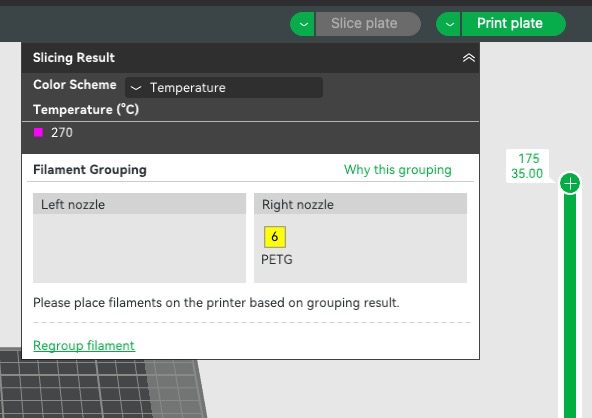

Well, I just tried it, using 2.0.3.54 and it seems to be working for me.
That is so weird, I don’t understand. What did you change? I also tried a cube on a blank file as well and nothing.

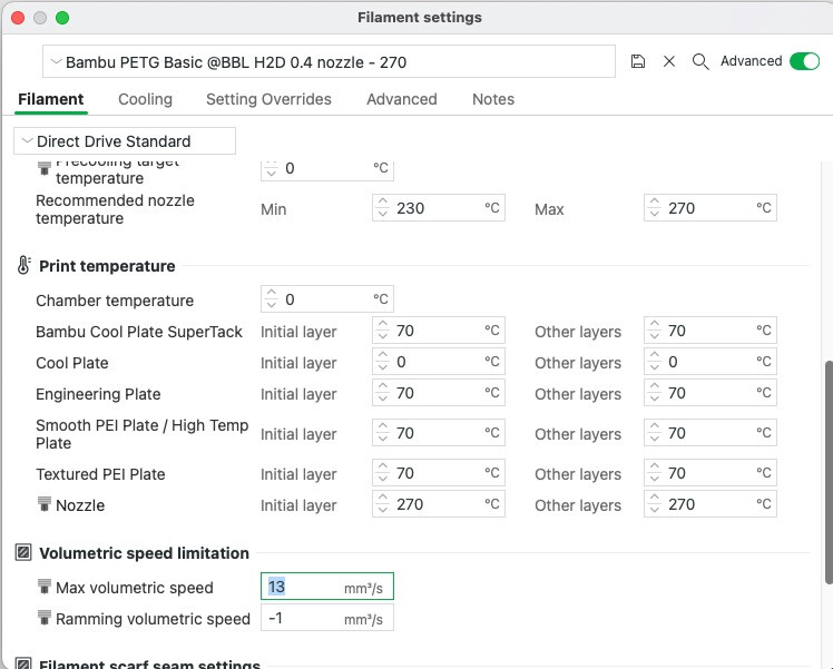

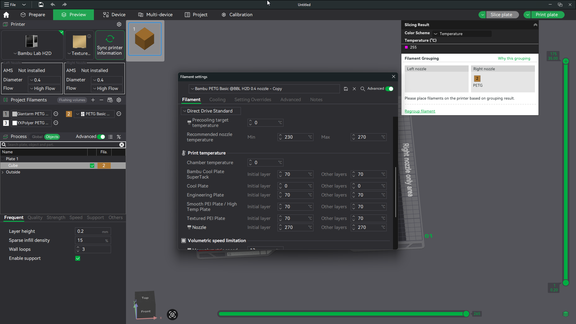

Literally just opened up studio, made a cube, saved a modified preset of generic PETG to change nozzle temp to 270 and saved it, sliced it, and it’s still 255
I used the Bambu PETG Basic and only changed the Nozzle temperature.

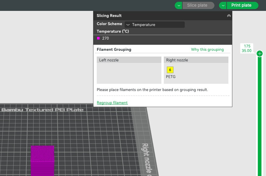

I’m going to uninstall and reinstall again and maybe clear out my user folder
Sounds like a good idea, I just tested Polymaker and it’s still working for me.
Well it must have been something broken with my user folder. Full reinstall and now it’s working. I knew it must have been a me thing because everyone would be complaining about this. Thanks for testing and confirming it was just me!!
