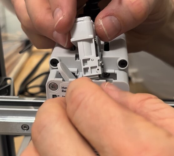

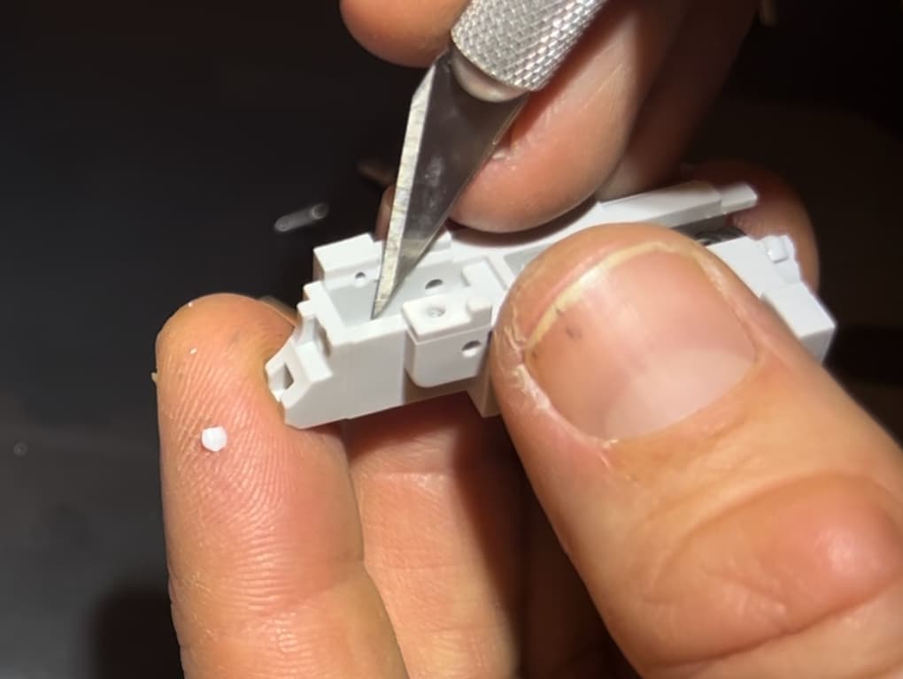

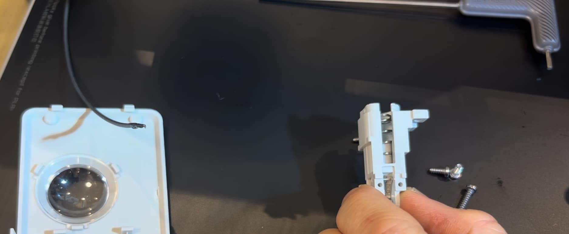

Hey folks, if this is what I thought it was, you don’t need a new extruder, nor a new filament sensor, since the problem is a design flaw! It turned out that there’s a little lever the filament pushes off to the side as it enters the extruder head, and that lever acts as a switch to detect whether there is filament in the extruder or not. Due to the mechanical design, this lever can get hung up on a ledge and stuck in the deflected position, causing the printer to think there’s filament present when there’s not. You can temporarily solve this by taking it apart, and permanently solve this by shaving off a bit of plastic to eliminate the flat surface the lever can get hung up on. A warning that taking that part apart is delicate, and putting it back together is a PITA because you have tiny spring-loaded lubricated parts that need to be wrestled into place at the same time. Below are some photos showing the major steps - the 3rd is exactly where I shaved off some plastic to permanently fix the problem.
I have never had the problem again since doing this. However, I suspect that if you don’t do everything described above, but just firmly flick the spring-loaded manifold just below the Bowden tube connectors, in the X-axis direction (so towards the back of the printer if you’re looking head-on at the extruder), it will hopefully shake that lever loose so it can reset and stop falsely detecting filament present. If you look down into where the filament feeds, you should be able to see a shiny metal thing in the way of where the filament needs to go. If you don’t, it may still be stuck off to the side.
