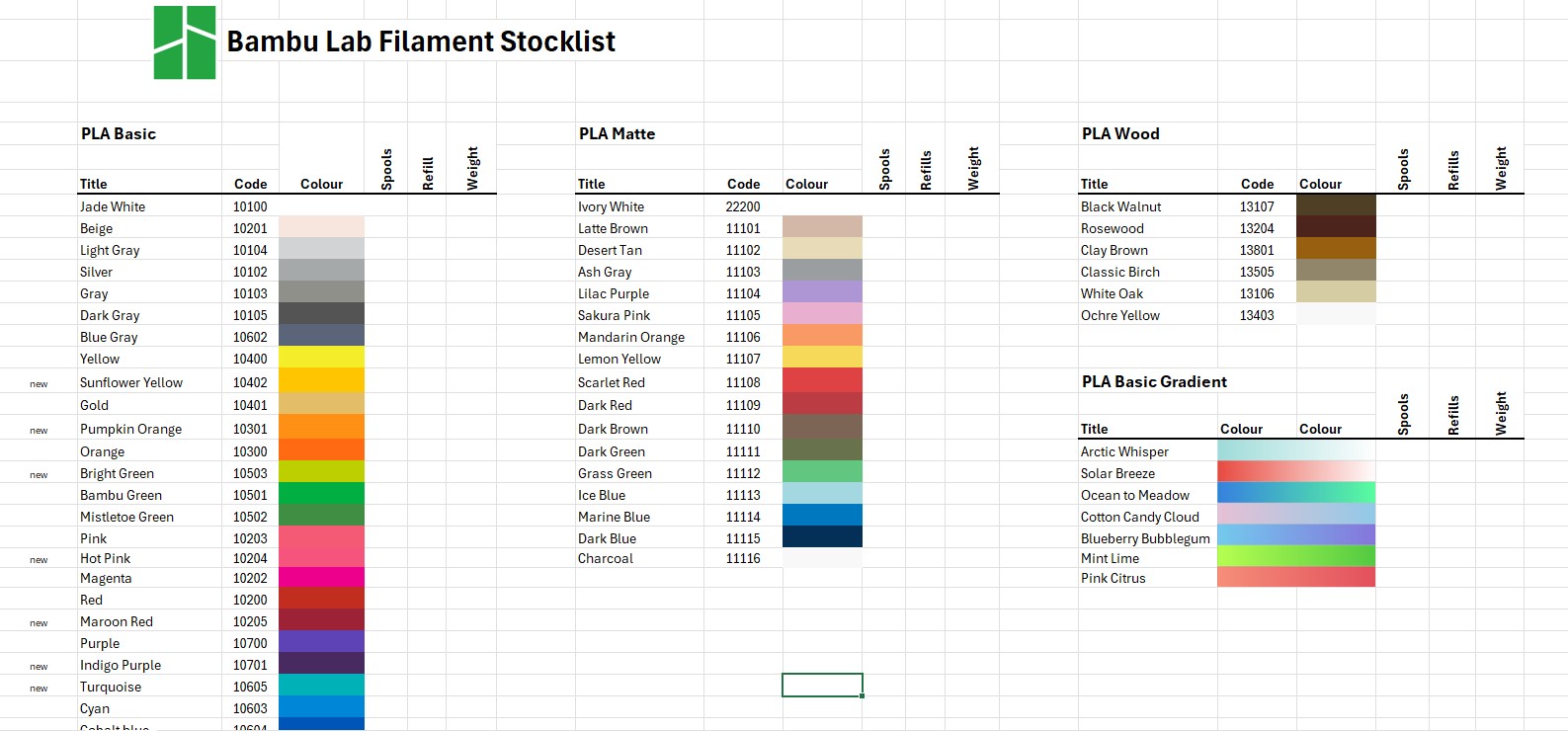

Hi Guys,
Maybe some of you can use this. I made a simple stock list excel sheet to track my spare spools and refills of filament. It’s a excel file and it’s free to download, edit, share etc.
Edit: 21.04.2025: Updated file with more filament.
You can grab the file here:
Google Drive Link

I think I would have entered the hex color code in the color square and then used a spreadsheet function to convert that to the background color. But the way you did it is portable to excel also, so that is a plus.
Good idea. I didn’t know that was possible.
I may try and add some formulas later to either show or highlight empty stock too.
You can add VBA code to your excel sheet for helping you converting Bambu Lab hex codes to cell colors. Just copy the Bambu Lab Hex code string in the cell you want to have the color and the cell color will change to the RGB color.
This will work with single hex codes (like #000000) as well as for gradient colors (like #E94B3C; #FFFFFF).
Safe your Excel Sheet as .xlsm.
Cursieve tekstThere are most likely better solutions, but this works for me…

For those interested I added a bunch of extra filaments.

I uploaded the latest version that shows where I keep track of my parts too. And I made it viewable only online, so you probably need to download it first in order to edit it. :slight_smile:

I used the hex codes from Bambus filament profile where available and used them to generate the background colour that you see in each field. So you could either take it from the excel or find them on Bambu’s Filament profile pages.
It’s nice having everything on one page but has the trade-off of being unsortable.
If you could break the rainbow colors into individual blocks and make the dual colors into a single block that contains both colors displayed, that would make it possible to cut and sort the filaments.
