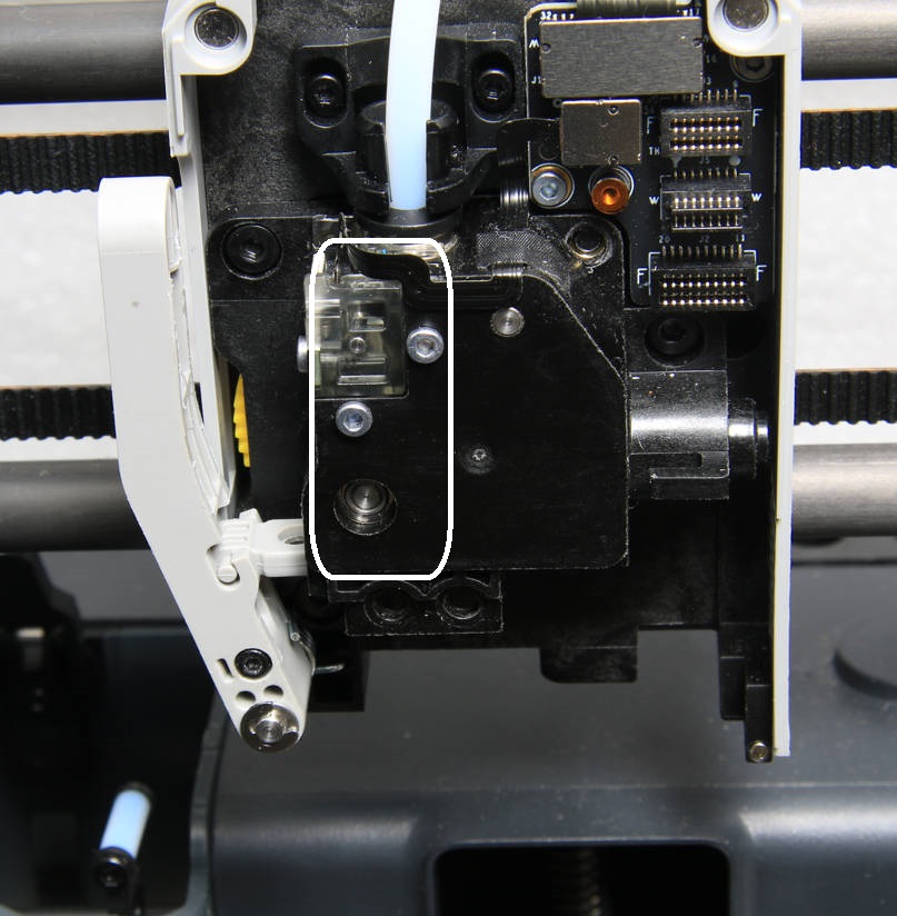

When printing a model that requires more than hour to print, the filament will stop feeding through the nozzle midway through the print. We have cleaned the nozzle and performed resets.
P1S
eSun and/or Sunlu filament

like it just keeps printing midair?
Is it happening at the same layer every time?
No, it just stops printing
What error code does it give you
No error code, just stops printing
the last one that was printed stopped on 44th layer out of 160, but it varies on each print
Is your filament spool possibly crossing over?
What does it say as far as print status on the touchpad on the printer?
Some of the replies are based on the filament stopping but is that the case or is the printer stopping mid-print. A bunch of folks have been experiencing the latter.
sounds like possible bad microsd card?
we checked the filament spool and it is fine
There is no message on the app or on the screen. I would say that it’s a case of the filament no longer be extruded, but the printer is still printing, just without the filament.
yes it just stops midair and no filiment is coming out
