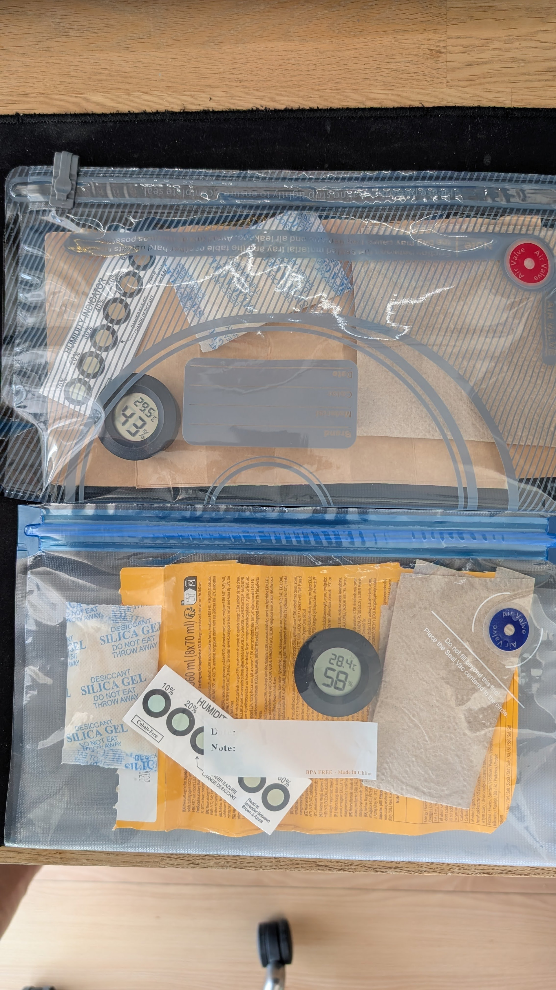

But you also say these cards are reversible and show the current humidity the filament is exposed to. It can’t be both.
The cards are reversible and really provide the same information as a hygrometer. The advantage with cards is no batteries. Some of the batteries in my storage hygrometers are so low now it’s hard to read the humidity values.
So really equivalent information but the real utility IMO is in storage they keep working. I prefer the finer resolution of hygrometers but no batteries is the big one for me.
Actually, if you want to know the integrated humidity a spool has been exposed to you can. Without desiccant, the humidity test will tell you indirectly what the moisture content is in the spool. Just test the spool itself.
