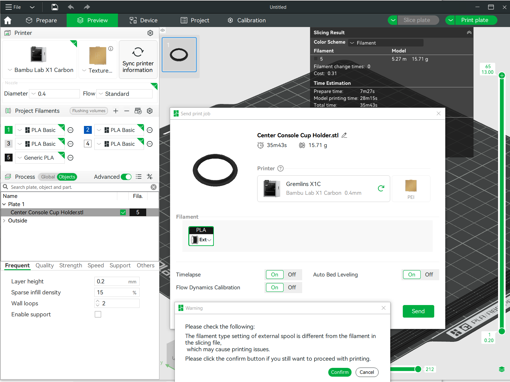

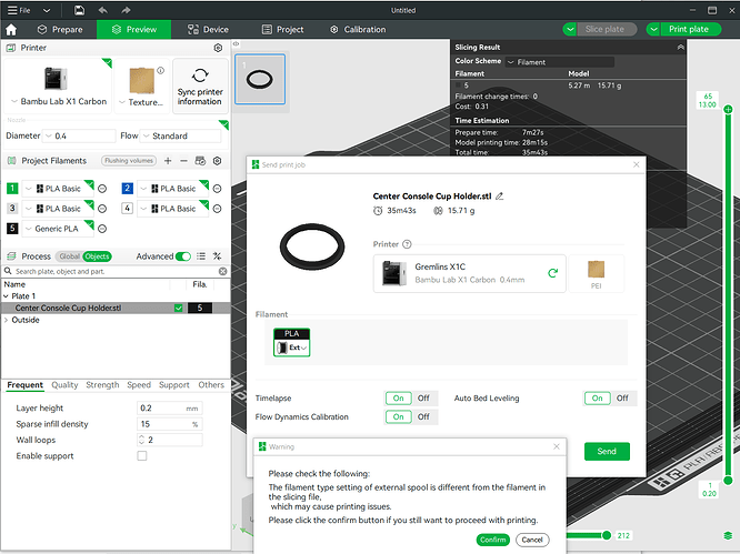

So with the latest version of Bambu Studio 2.1.1.52 I synchronise my printer wiht the studio and I’ve got externally loaded Generic PLA on the printer. I then select that as the filament to use for the object, and hit Slice Plate. Once the plate slices I go to print it and it asks me which filament in the AMS, and I again select the external filament, and it then gives me a warning that this isn’t the filament I’ve sliced for.

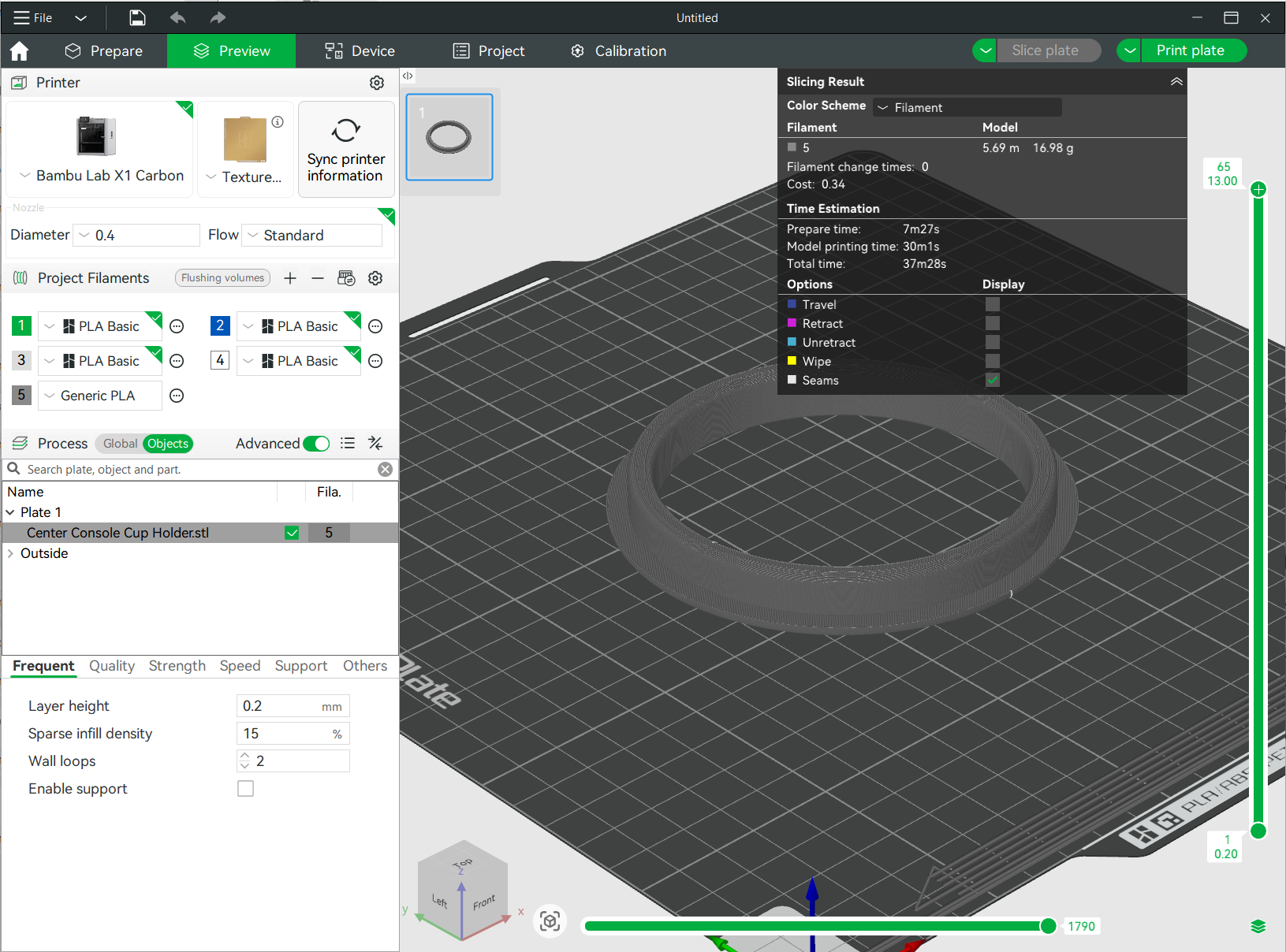

Looking at the process: Objects section it shows “Filament 5” which is the external generic PLA filament. And in the Preview mode in the slicing results it says Filament 5.
Why do I get this warning?

One clue is when I click on print plate it shows up with “Send my print job” and it’s picked another filament not the one I asked it to use, here’s a snip where you can see everything set correctly yet the warning.
