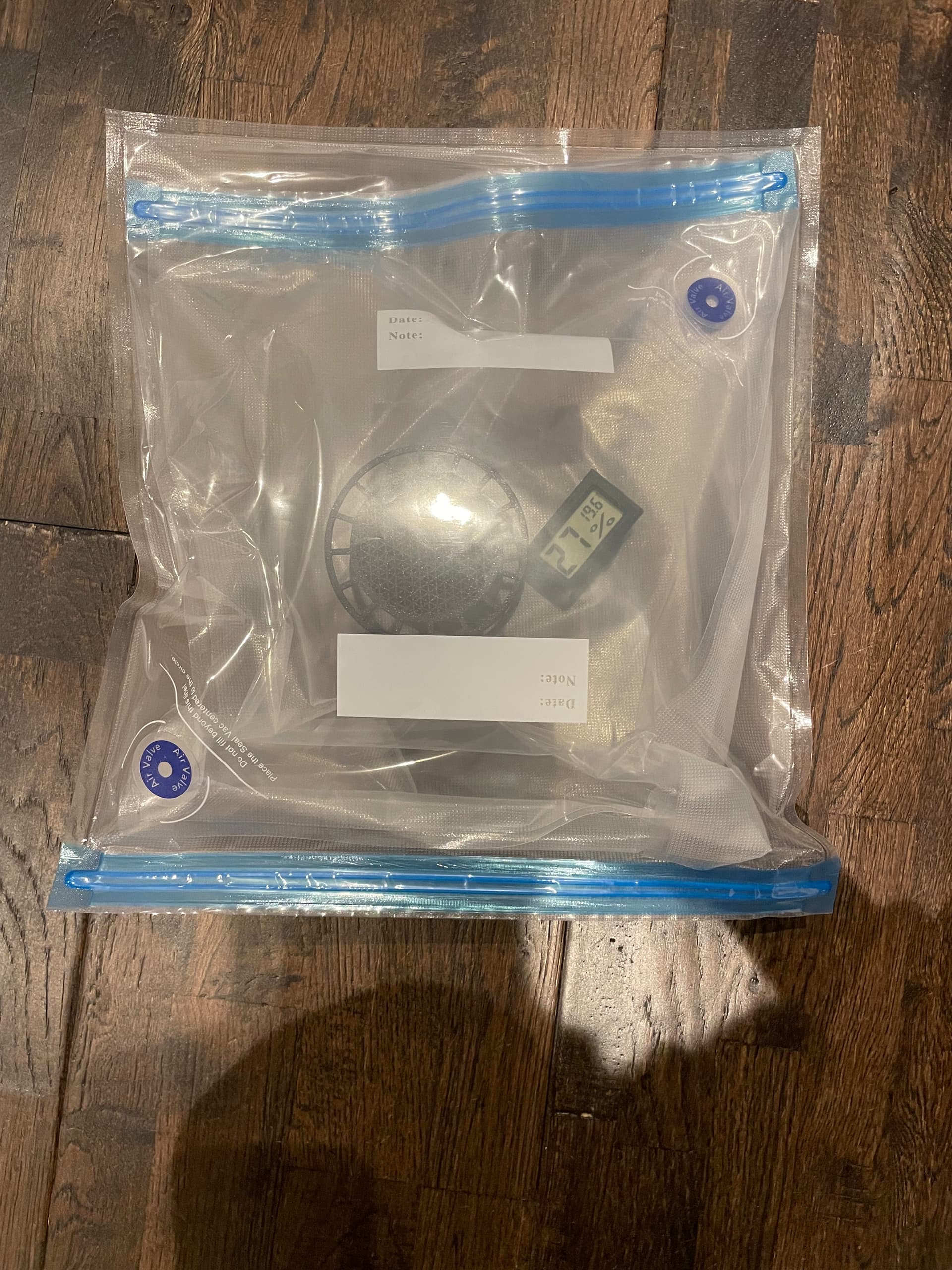

I have been confused why my supermarket freezer bags had been only getting down to 30% even with desiccant that would reach 10% in a dry box and I had assumed that water had permeated through the bag due to the bag not being strong enough to resist the forces of diffusion when the inside was under 30%.
I had heard similar things about these vacuum bags so I had to test it out in some way or another.
Test method:
I started by putting some desiccant into the bag and sealing it shut whilst measuring the humidity halfway to the other side of the bag.
I used a container of the fresh loose desiccant I had left in a sealed bag with some filament for a long time so this was not degraded by regeneration cycles with the rest of the desiccant but I dried it once after I found it in the bag.
Note: using a different desiccant does not make this an unfair test because I am using the same desiccant throughout this entire test and it is only different to the other tests which we are not comparing to.
an image from the start
10 mins
20 mins
30 mins
1H
24H
It seems that water does indeed permeate through the bags.

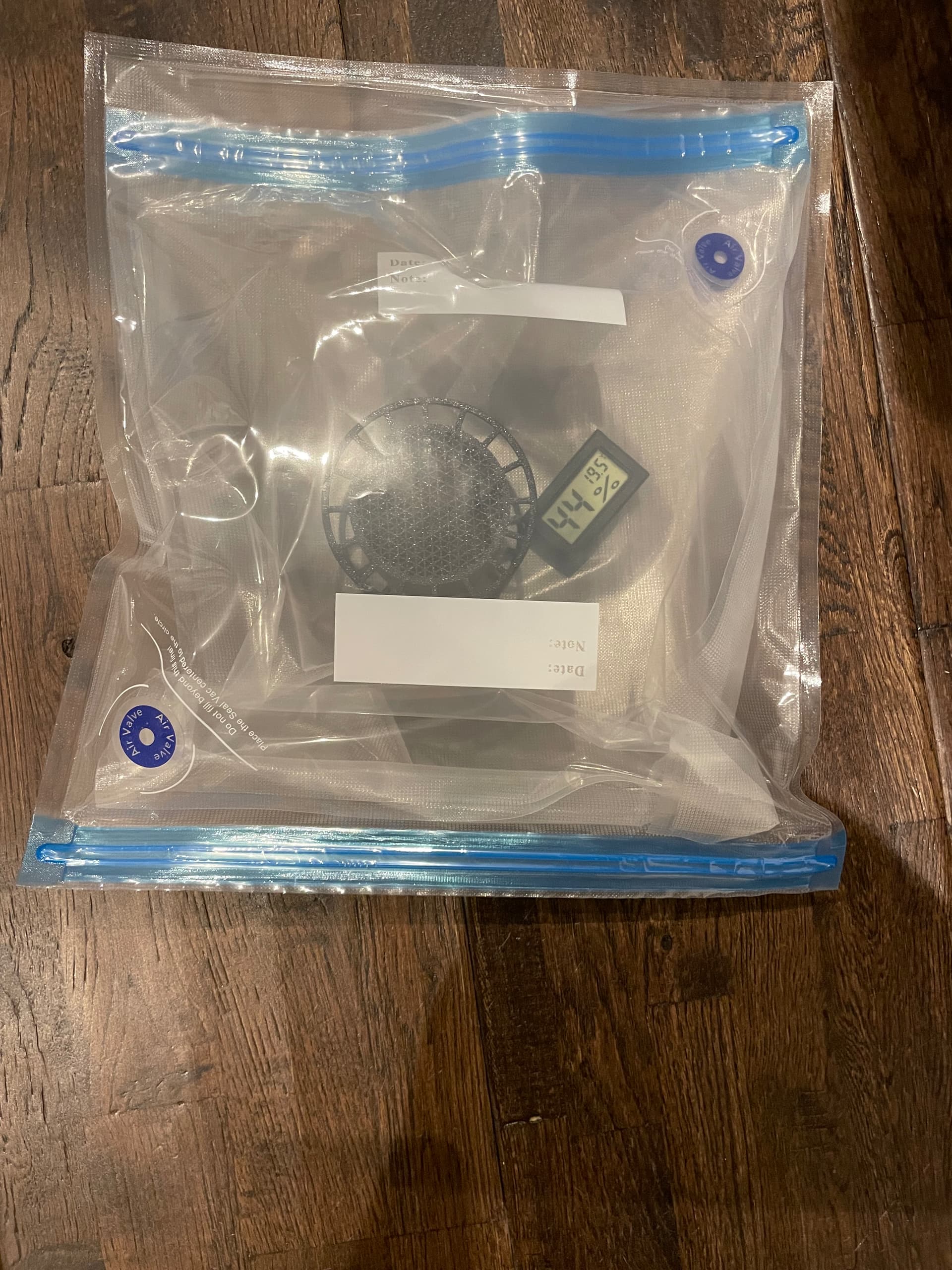

Now I wanted to see if double bagging is as effective as a dry box.
double bag after 5 mins (this was the first photo because it took 5 mins to put the bags in each other)
double bag after 10 mins
20 mins
30 mins
1H
2H
24H
from this we can see that a similar thing happens with the vacuum bags and water is definitely permeating through because a dry box gets down to 10%RH with this desiccant in this container within 30 mins so water must leak in somehow.
In conclusion this myth is confirmed and double bagging is an effective way to store filament and will not take too long to fit one bag into the other if the bag on the inside is vacuumed unlike in my tests.
