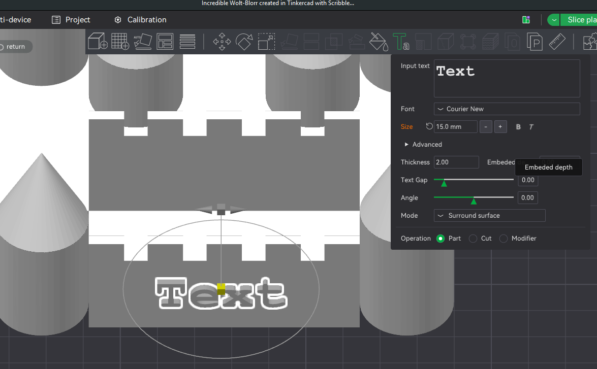

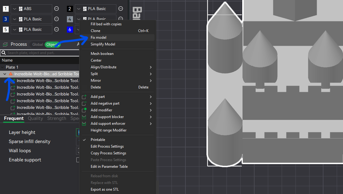

The ultimate goal is to place text on this object. The text on there now was done with the Scribble Tool in Tinkercad and exported as am slt file. I have a Mini Prusa (sorry! ) so I opened that stl in the Prusa Slicer 2.9.6 and it shows that scribbled text. The challenge is that when I cut the bg code to a flash drive and insert that flash into the Prusa, choose that file to print it prints the text like it’s all been balled up so you can’t see any of the characters (person’s name) on the object although the figure prints well.
I thought instead of using Tinkercad’s Scribble tool I’d just create text for it in the Prusa Slicer If Bambu Labs works better I’m open to that as well) but I can’t find that stil file anywhere and have no idea how to"remove" text from an exported stl?

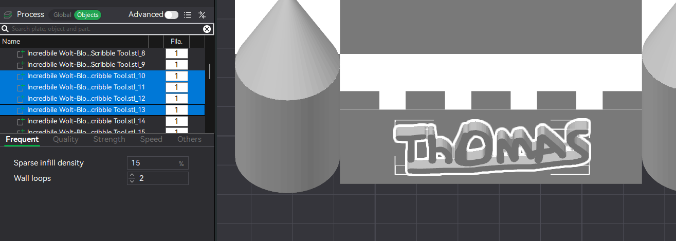

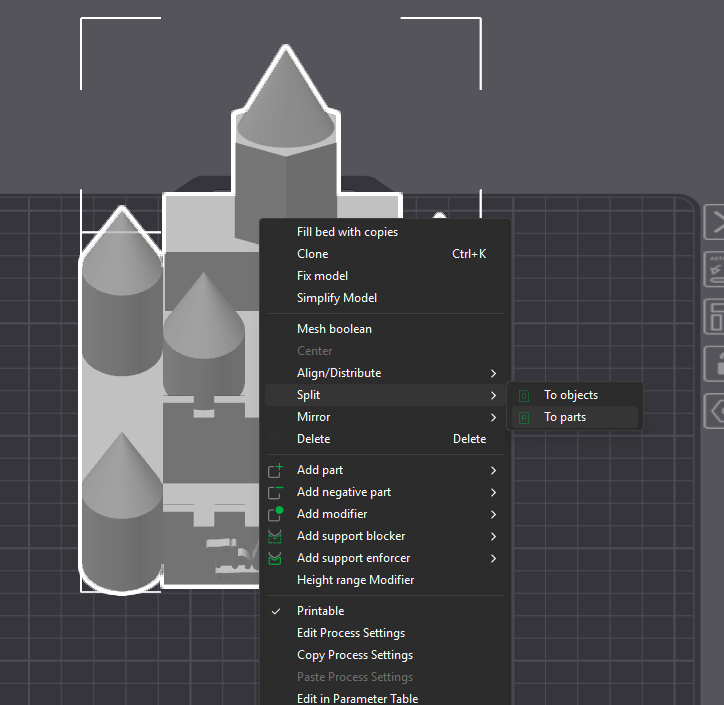

There are different ways to remove the text. You could slice it off, you could cover it up with a negative part or the way I did it was to “Split” into parts and then simply delete the text sections.
Find the text sections and delete them.
I would also suggest that you “Fix” the model as there are issues with the STL.
You need to have a Windows computer to do this in Studio.
Now simply add the text you want to use back onto the model using using the text tool
Incredible Wolt-Blorr Text Removed.3mf (173.6 KB)

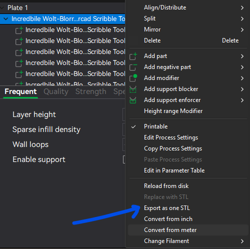

Finally you will want to “Export as one STL” to combine them all back together the “easy” way.

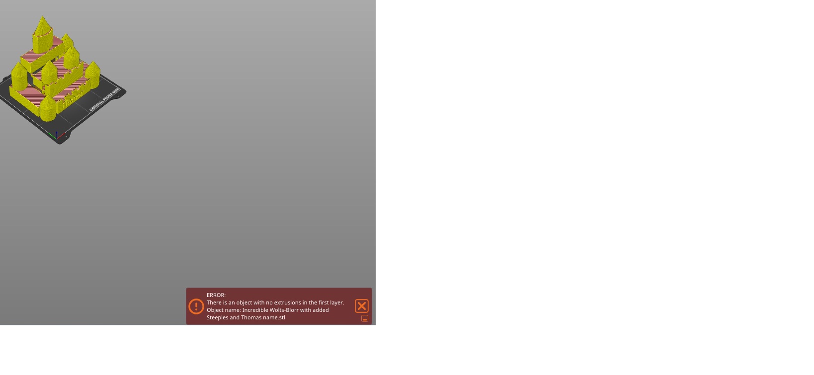

I just sliced in but i get the error that there’s no extrusion on the 1st layer.
I’m not sure what that means or how best to correct that?

Looks like your using Prusa slicer? Make sure your model is actually sitting on the print bed.
Hi Jon… does it look like it’s not on the bed in your Bambu Slicer as it looked like it was flat in the Prusa Slicer but I’ll use the lay flat on bed feature just in case.
