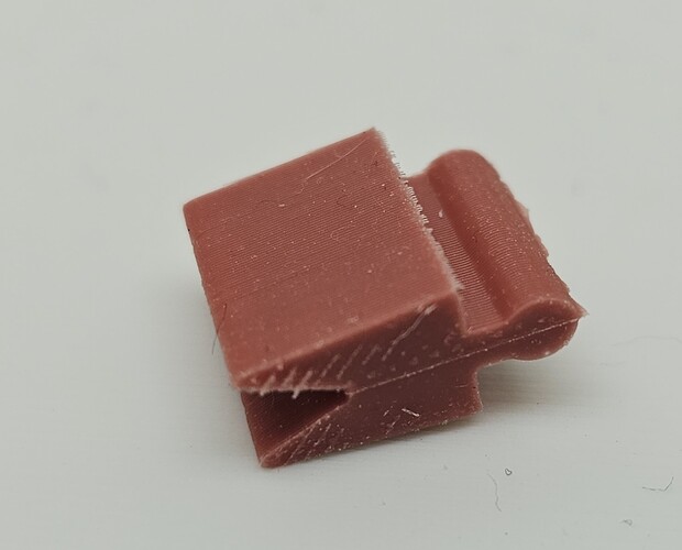

I’m in the process of making a mold to cast your own from 2 part silicone
. Its close, just making adjustments to the fit.

I am actually excited for this. I have a 2 part silicone wiper on my X1C and never looked back. Very interested in this mold!

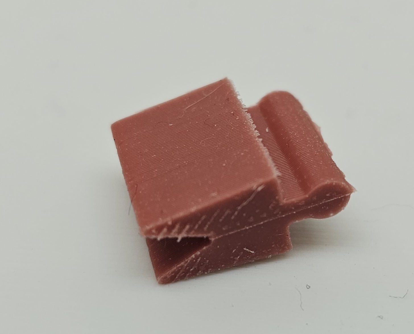

I have the mold made. Here is the link.

Nice, was hoping for more of an injection type mold. The two part silicone I used on my x1c is a high temp red type 3 HB which is pretty liquid when mixed.

What is the hardness after curing?
40A, as it’s mentioned on the makerworlds page.

33 A after 24 hours. It holds up to the heat on the X1C very well. I think I made around 20 wipers for my X1C 6 months ago and still on the first one. Here is a link to the product: Berliner Zinnfiguren | TFC Silicone Rubber Type 3 HB Heat Resistant 1:1 - 500 g | purchase online
The part I have that claims 40A is much softer than the H2D wiper. I really wonder if they will sell it by itself or only with the assembly? I dont know if the replacement assembly comes with more than 1 wiper?
