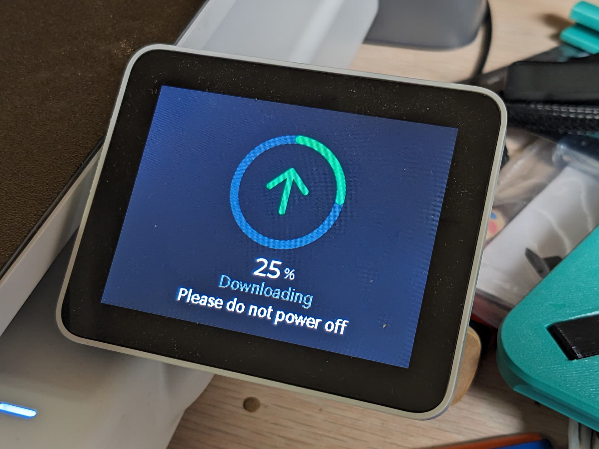

Firmware update stuck at 25%
I’ve tried twice now to update my A1 firmware and it immediately says 25% then goes nowhere. I’m not sure what else to try here…

Same thing happened to me. Three attempts to upgrade to latest all stalled at 25%.
I received my A1 with firmware 01.03.x and it would not upgrade to 01.07. I upgraded to 01.04.00.00 with no problem. Then I was able to upgrade to 01.07.01.00.
In the linked troubleshooting page this seems to fall under “Specific firmware version does not support cross-version upgrade.”
I’m currently on 1.05 and same issue again now not able to update to 1.07 lol. I don’t really care though, and for many reasons I’d rather just stick to 1.05, but funny the same issue happening again.
Same situation here. Stalls at 25% until it fails after a very long time, or I cut power.
Support ticket wants me to observe the lights on the mainboard, but I’ll just stick to 1.05 for now instead, that’s a lot of teardown I don’t want to do right now.
Factory resets, disconnecting AMS, hosting wifi from my phone have not helped.
Seems the latest offline firmware updates have not been published either.
Correction - seems like there’s a different location for newer firmware than the wiki has: Firmware Download | Bambu Lab

Mine got stuck at 32%, I turned off , removed SD card
and next time it worked.
Cheap SD cards have caused many issues for people. It’s not the printer’s fault if the SD card is faulty or doesn’t carry the necessary ratings. There are different ratings of SD cards that cost more or less. Many buy SD cards with the wrong ratings because they are cheap. Don’t know the issue but with an iffy card it may not be the printer’s fault.
