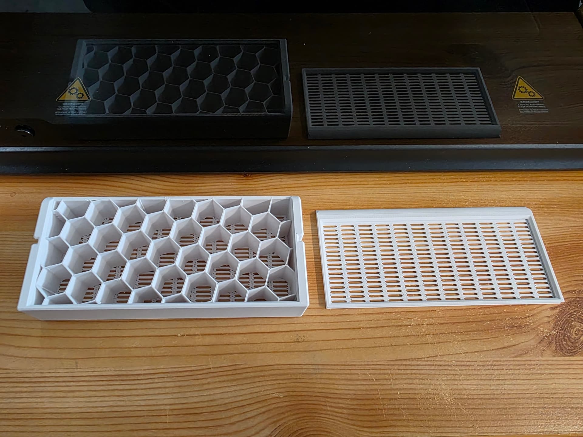

First ABS Print ever
My first ABS print ever. eSun ABS+, right nozzle, Generic ABS profile, Texture PEI. Very good outcome. I had many fears beforehand, but it really printed like PLA. But ABS printing is nothing for hot summer days (the H2D case and the front door had about 40 C)
Yeah, the H2D does high temp materials VERY good. The print quality of my ABS parts are better than my PLA prints.
