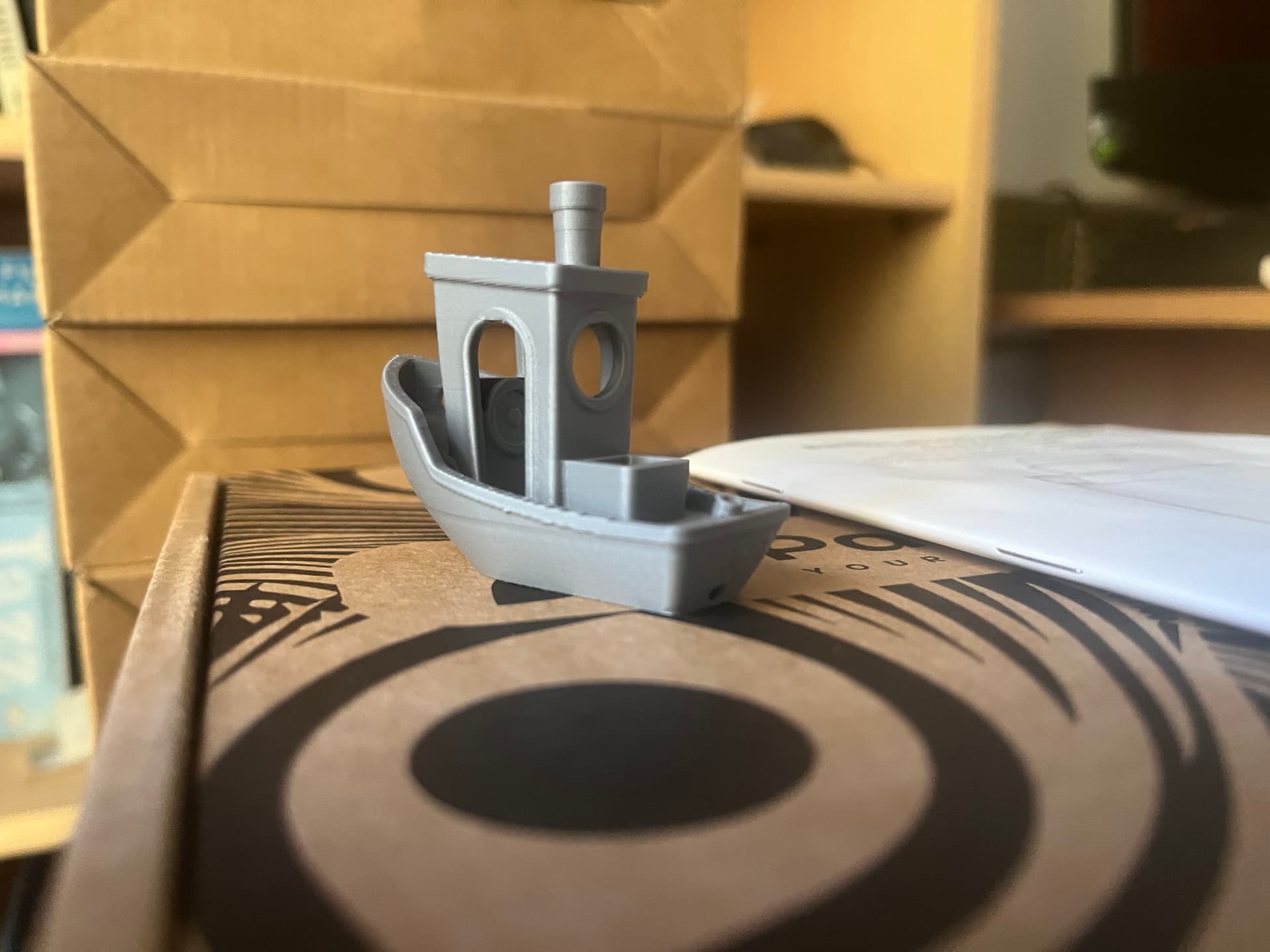

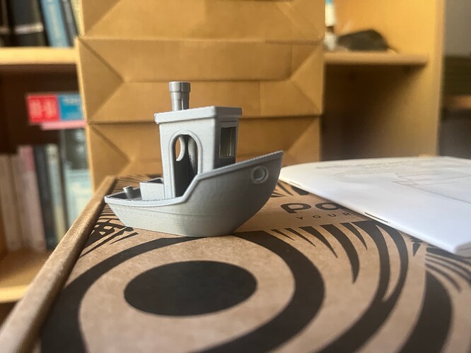

So I received my H2D today and printed a benchy. But there is one line across
it that seems like it isn’t aligned correctly, it doesn’t have any other errors though.
So I was wondering why this might be:

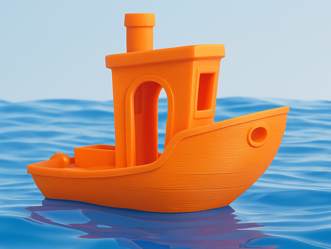

I printed this model:

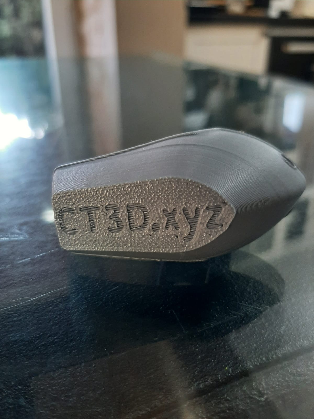

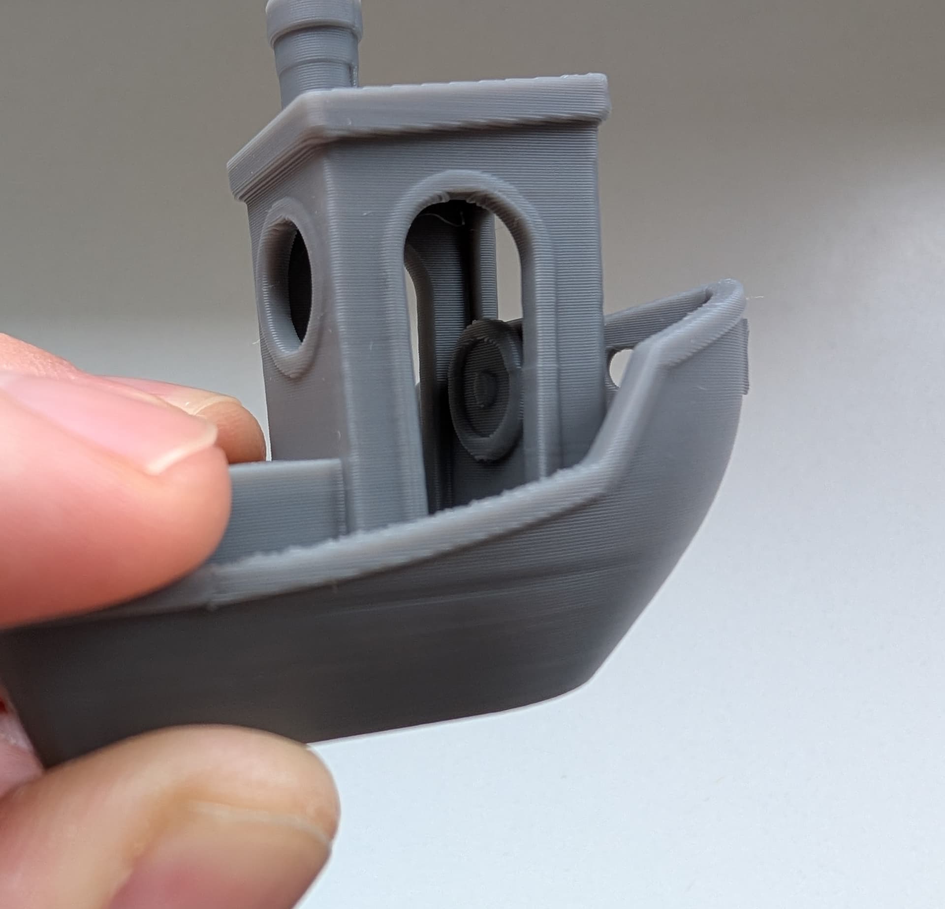

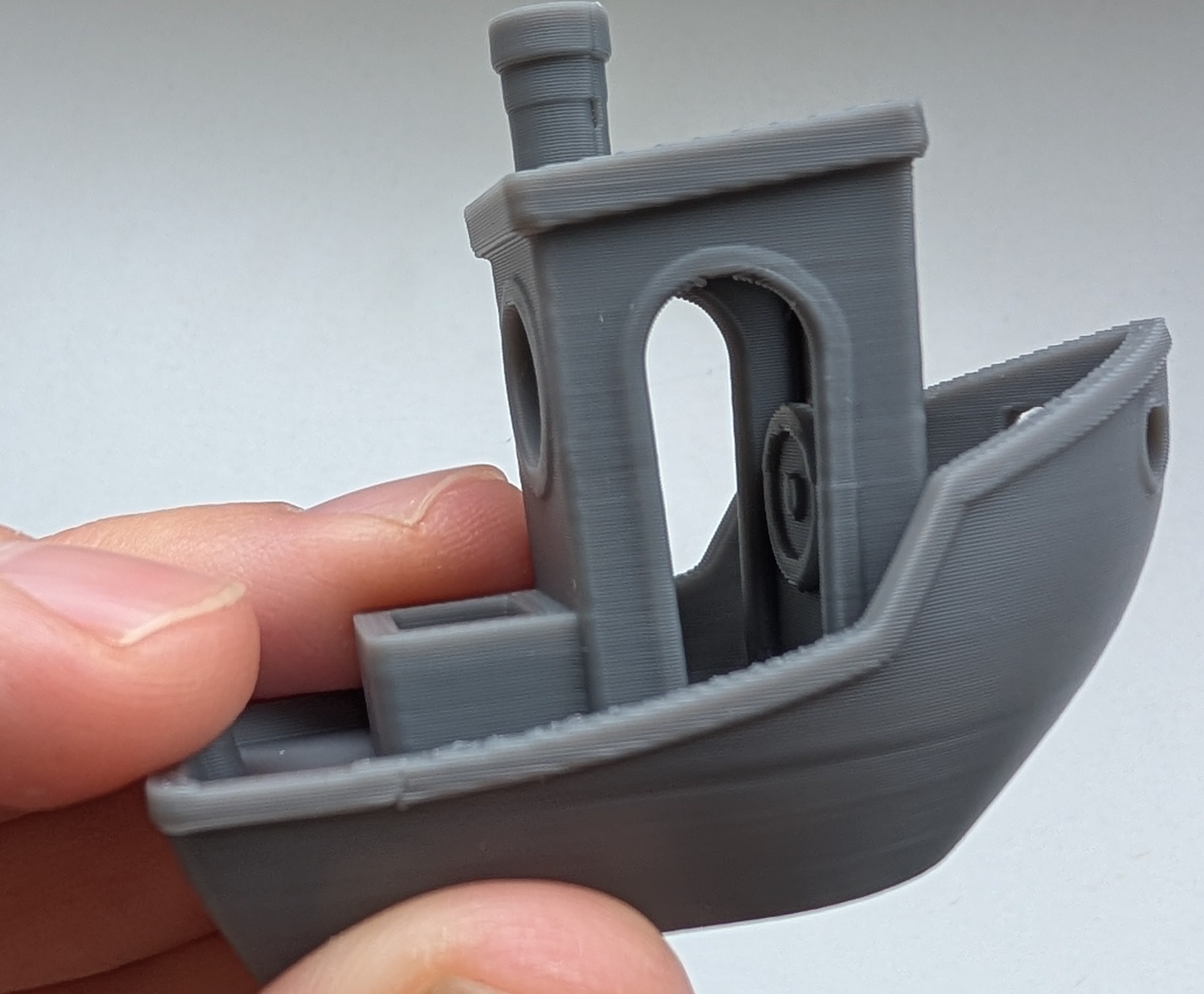

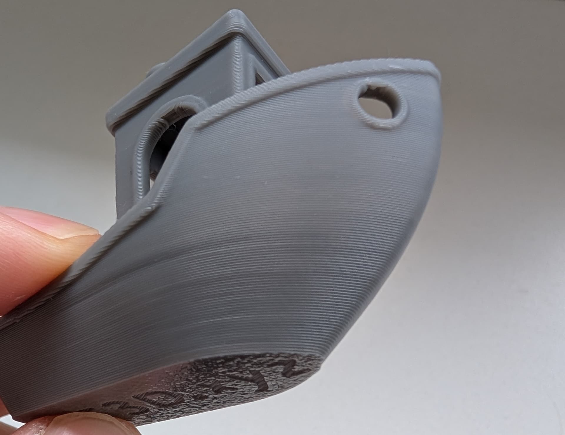

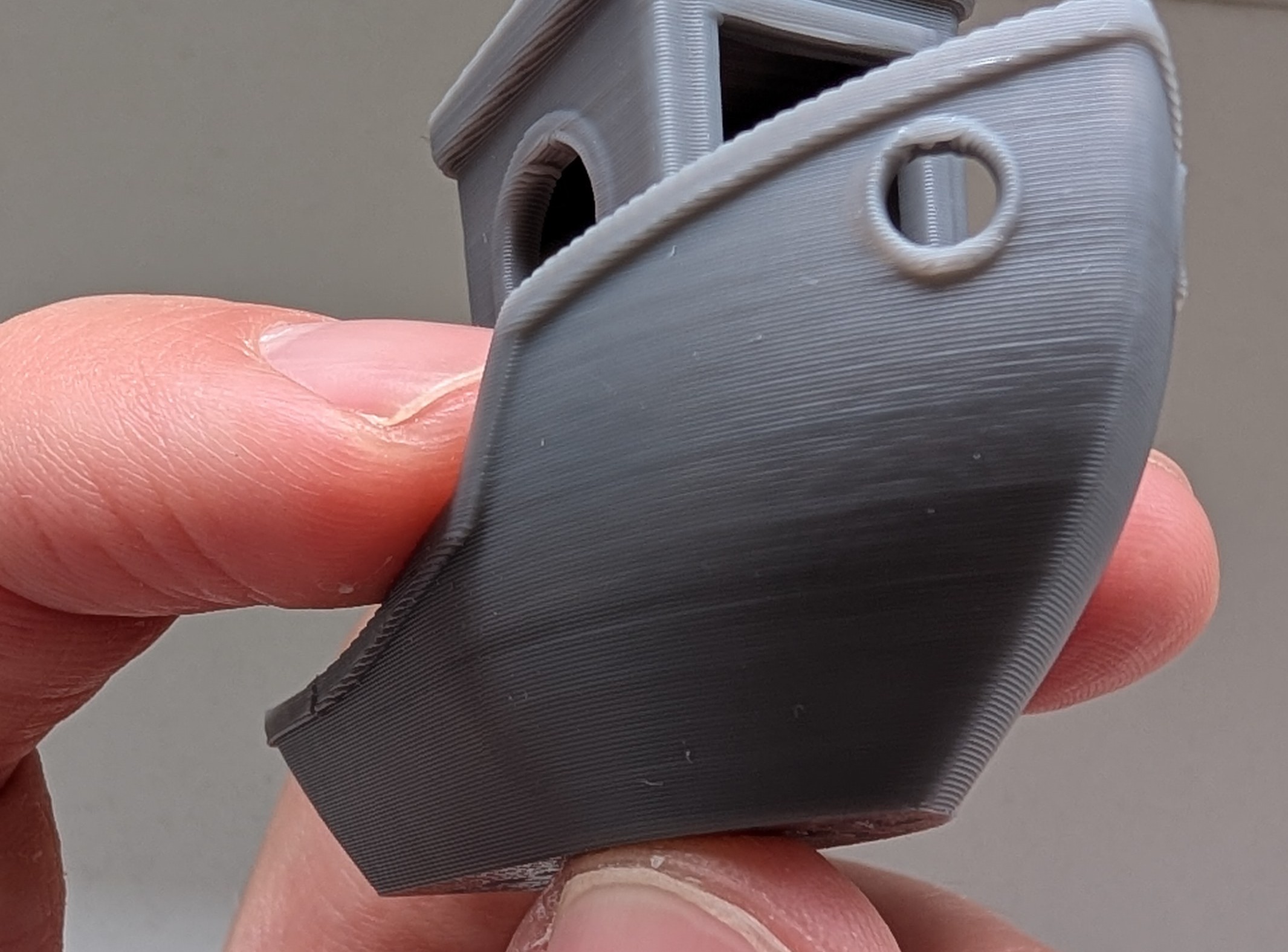

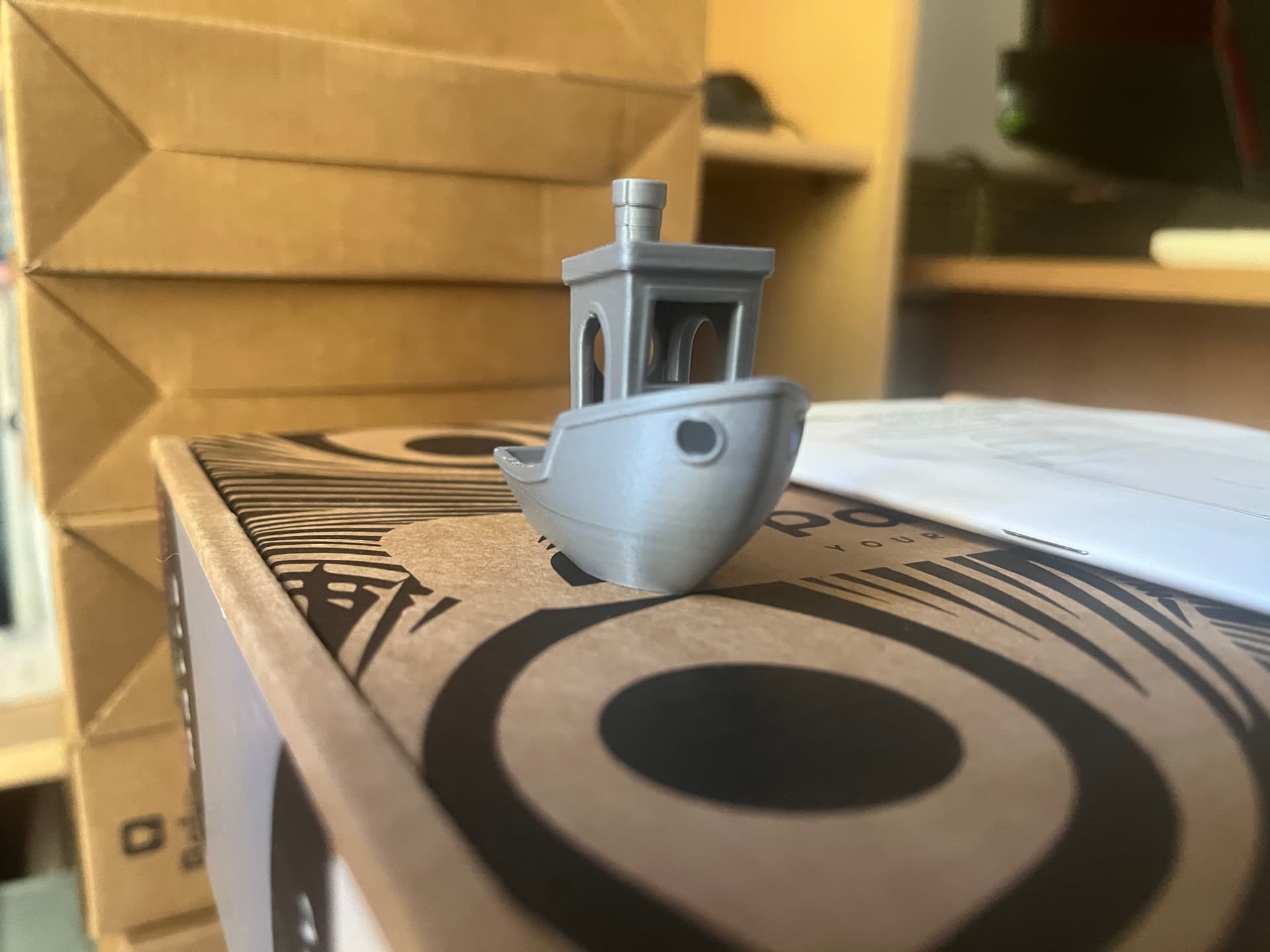

This is known as the benchy hull line and is totally fine. Can you make some picture with the light hitting from the top so I can see the lines better? Here is mine for reference (Sunlu PLA)
Thank you very much. My current lighting conditions are not good but I took this photo at the time that might help.
Okay I would say looks very similar to mine. I woul appreciate if you could add some photos once the lighting conditions are better again :).
