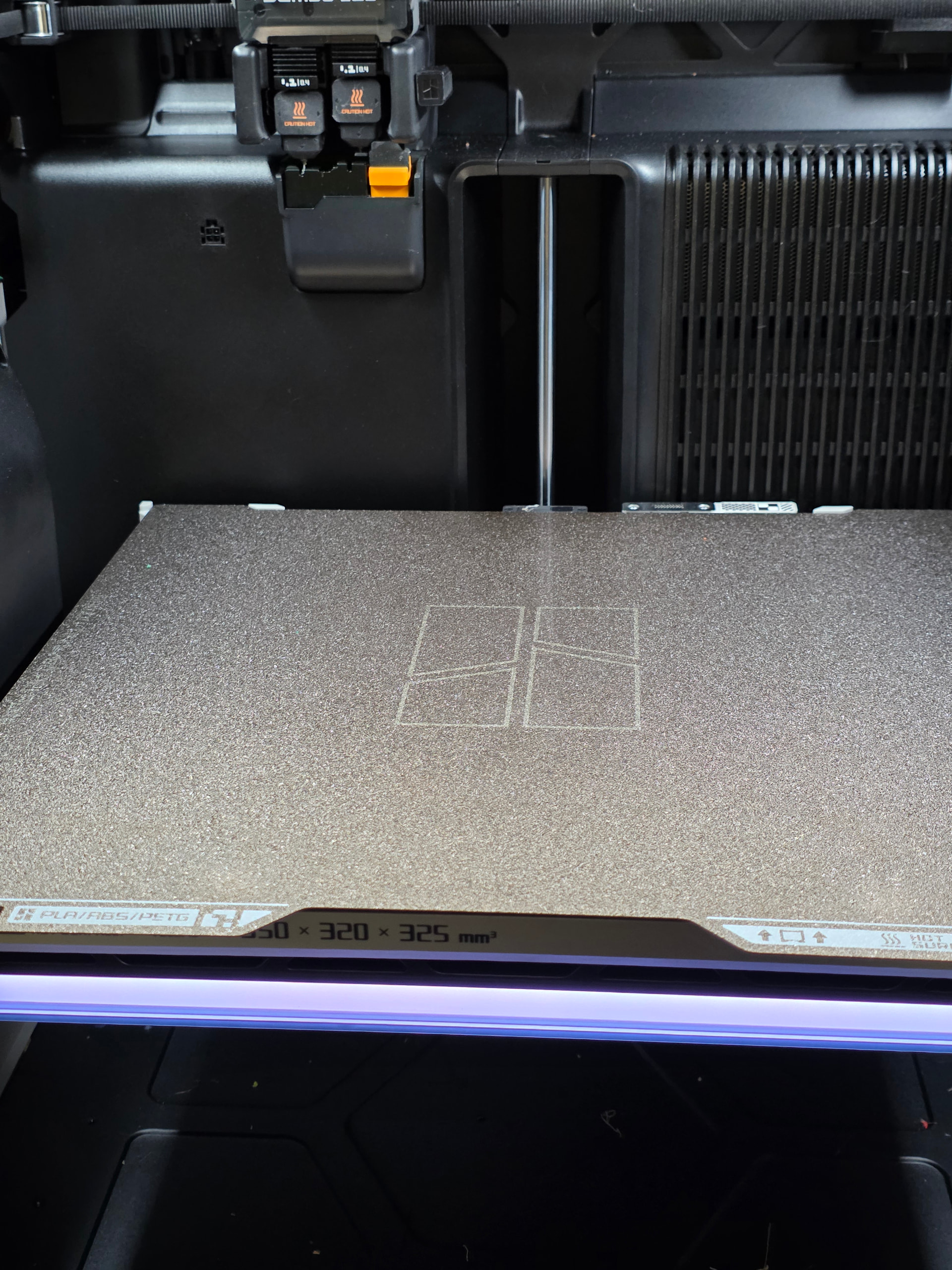

Are you able to post a picture of the plate and print? The smooth PEI plate is very picky when it comes to finger prints and smudges.

I’ve cleaned it with dish soap and warm water and tried the opposite side.
It’s the textured plate that comes with the machine not the smooth one.
I’ve washed it with warm water and dawn with a sponge several times to be sure it was clean. Filament was dry, I dried it in the AMS to be sure. I used the identical filament previously with flawless results.

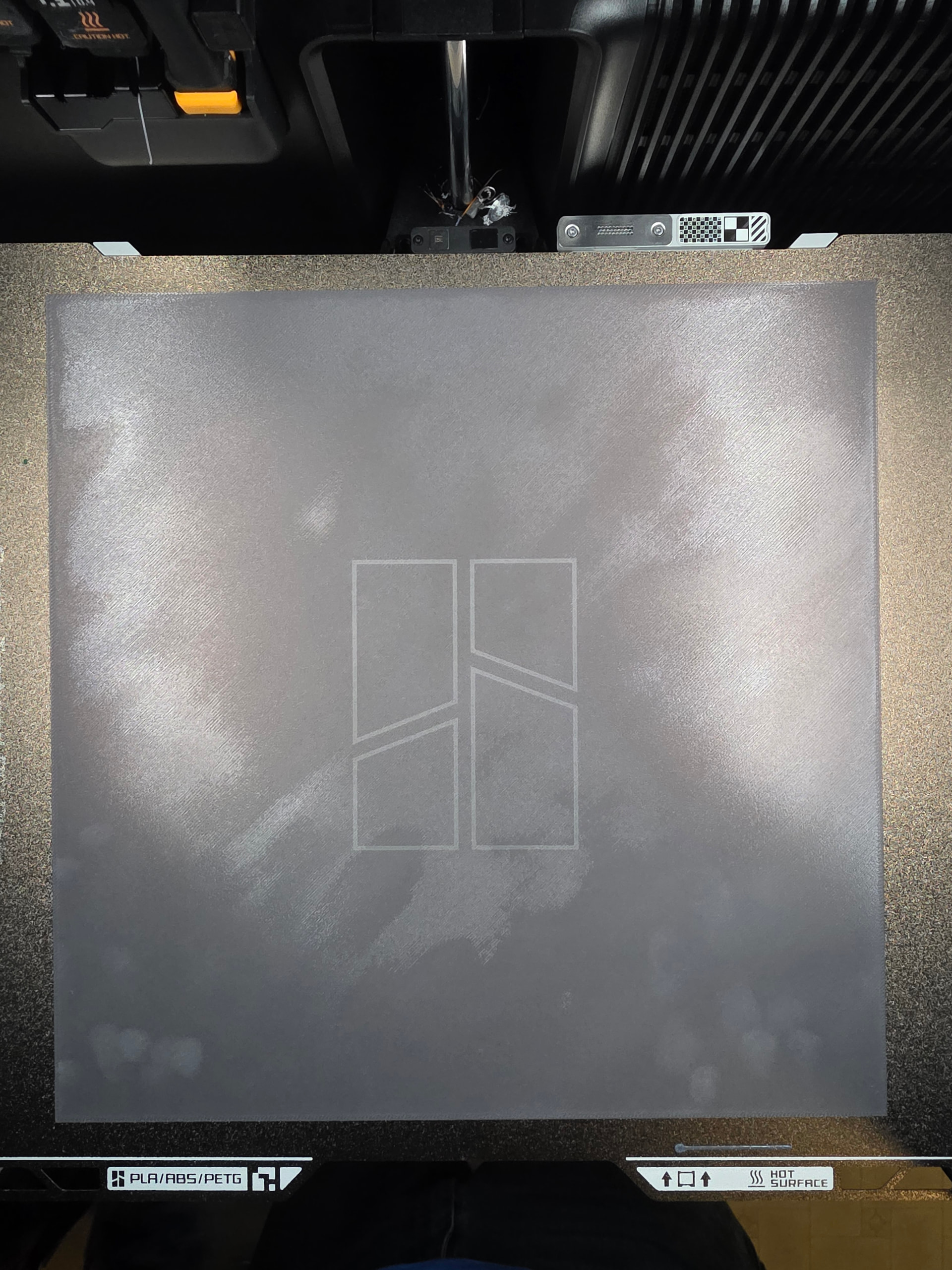

Can you print a single layer of filament across the entire build print?
  • Create a new project.
  • Right click the build plate
  • Add a cube primitive
  • Select it
  • Using the resize tool from the toolbar
  • Turn off the Uniform scale feature
  • Set the width and depth to that of your build plate maximum and a 0.2mm height
  • Make sure the line height is 0.2mm
If you have any obvious adhesion problems they will show up visually.
Share the resulting photo.

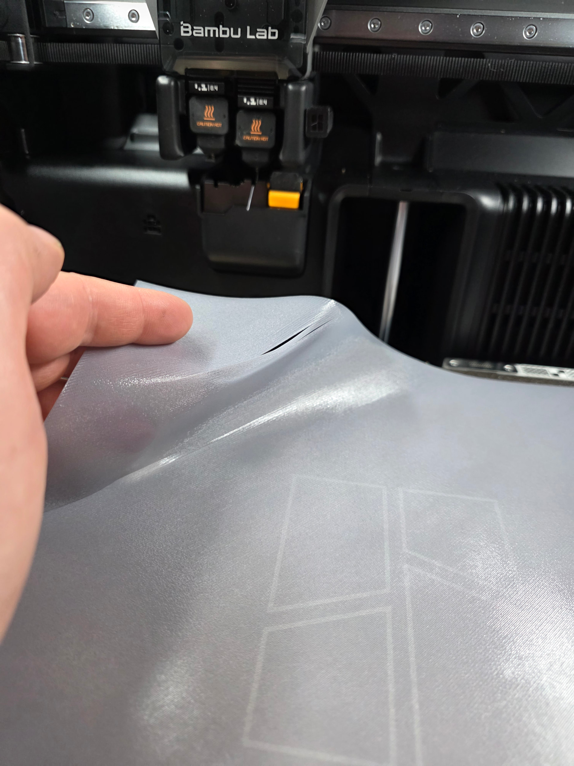

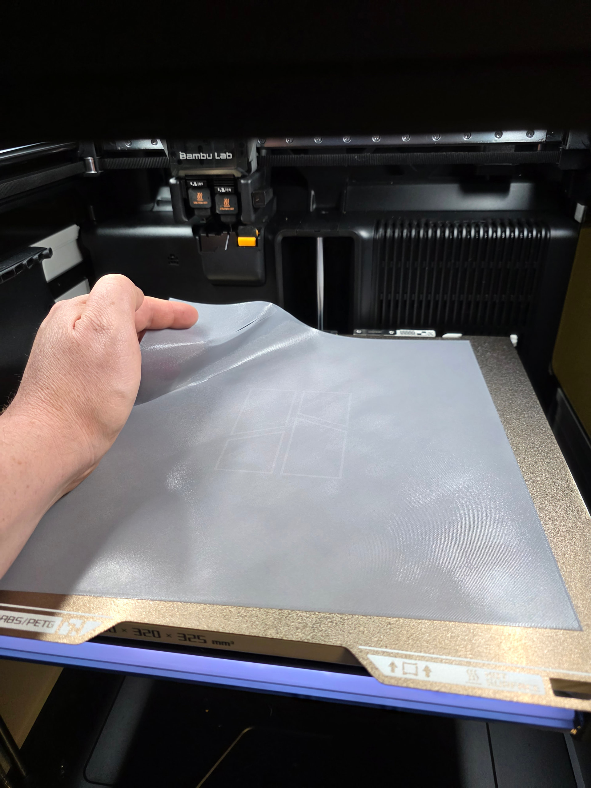

1 1It printed fine but the back left corner was clearly slightly too far away as the line adhesion is poor and the infill lines just pop apart. The rest of the print the line adhesion is great.
The plate seems fine based on that result.

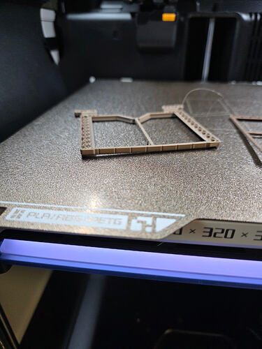

Do you have any photos of the failed prints, with profile views and ones of the obvious failure points.
Definitely not fine on the back left part where the infill didn’t fuse to itself. The rest of the sheet is solid and can’t be pulled apart. That back section can easily be separated.
Here’s two of the previous failed prints with their edges lifting these were both in that same back left area of the bed.
