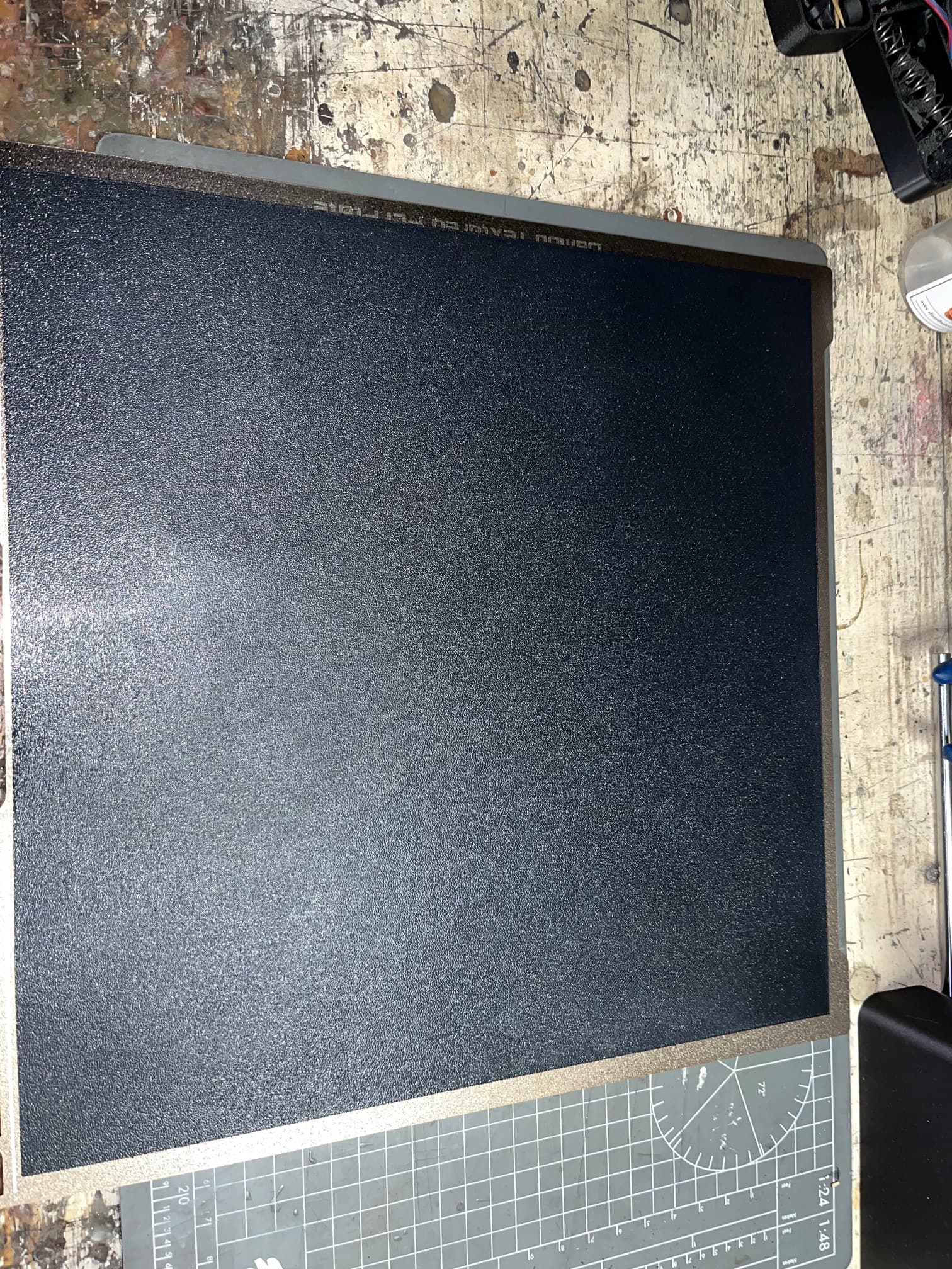

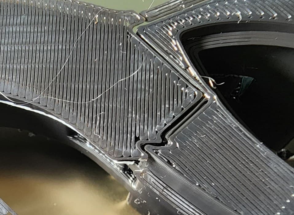

First layer test on my H2D. ASA vs PLA. Is this normal?
After a lot of Bambu wiki reading, chat with GPT, troubleshooting, etc. I’ve come here for some advice.
I am experiencing ‘minor’ print quality issues with my H2D when printing with ASA. I don't think it's filament or settings issue because I've tried printing the exact same models with the same filament and settings on a P1S and it would print just fine.

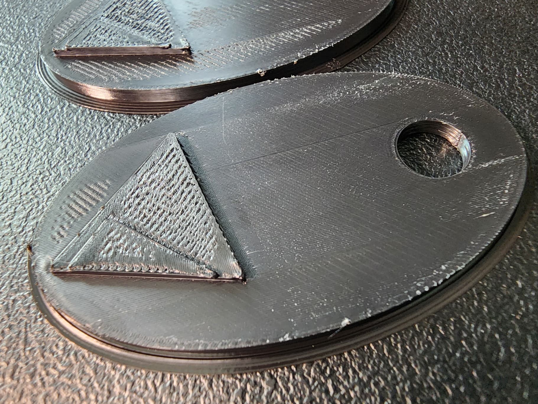

Problems (images should be in order):

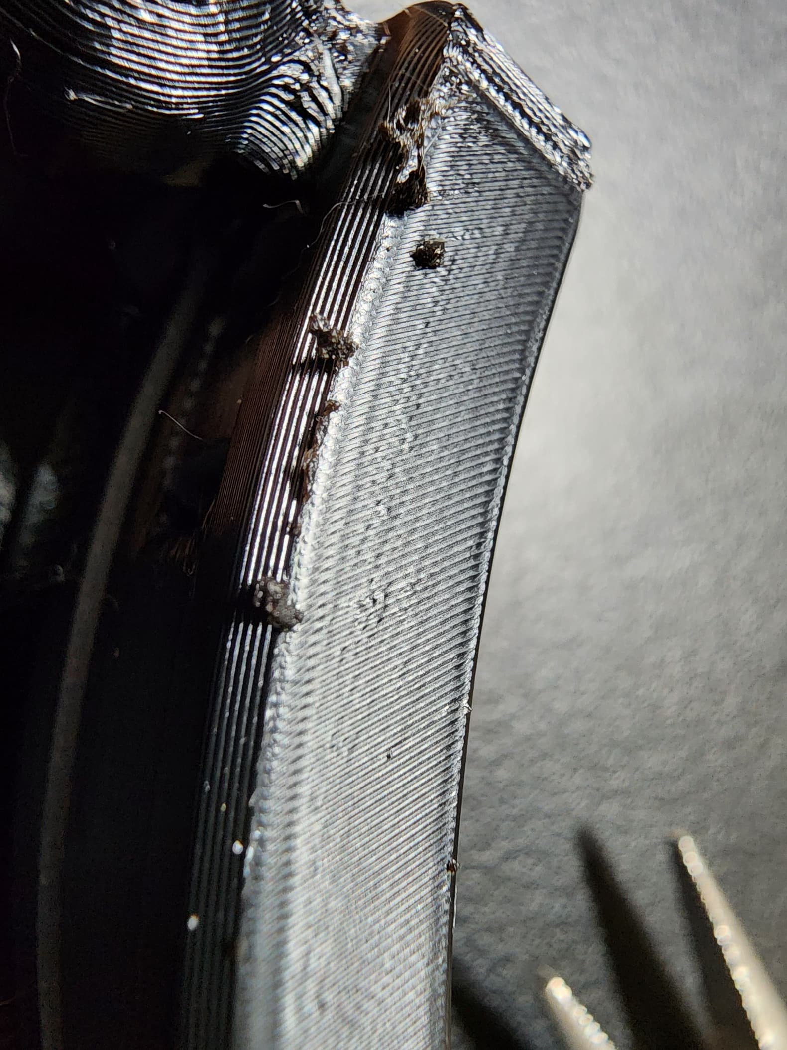

1. inconsistent ironing surfaces. (ie. layer 10 irons fine but layer 20 iron looks completely different)

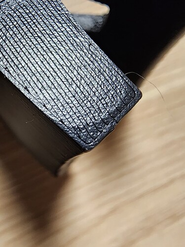

2. ironing leaves little filament nuggets, usually on the edges.

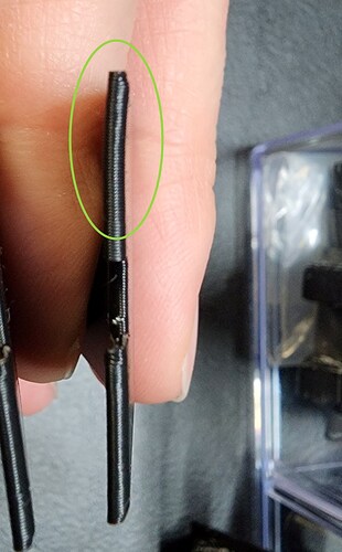

3. when printing a thin wall there is warping in the first 20 layers or so.
4. bottom layer sometimes have large gaps. (doesn’t squish well, only in some areas of the plate)
5. Corners lifting.

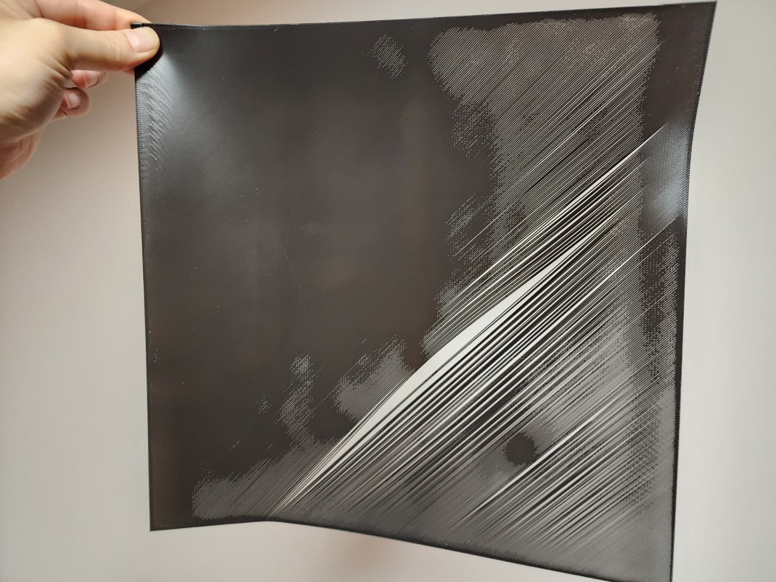

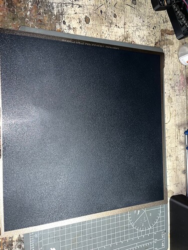

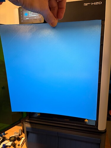

6. The last diagnosis I tried was the first layer test. Tried it 4 times and every time the back left side didn't squish enough as if the nozzle was not close enough to the plate. This back left area was also the area where #4 and #5 was happening as well. (4 and 5 doesn't happen in the front right area) Also tried this test with PLA and it turned out pretty good. (last image)
Again, none of these happened on my P1S with the exact same model, filament and settings.

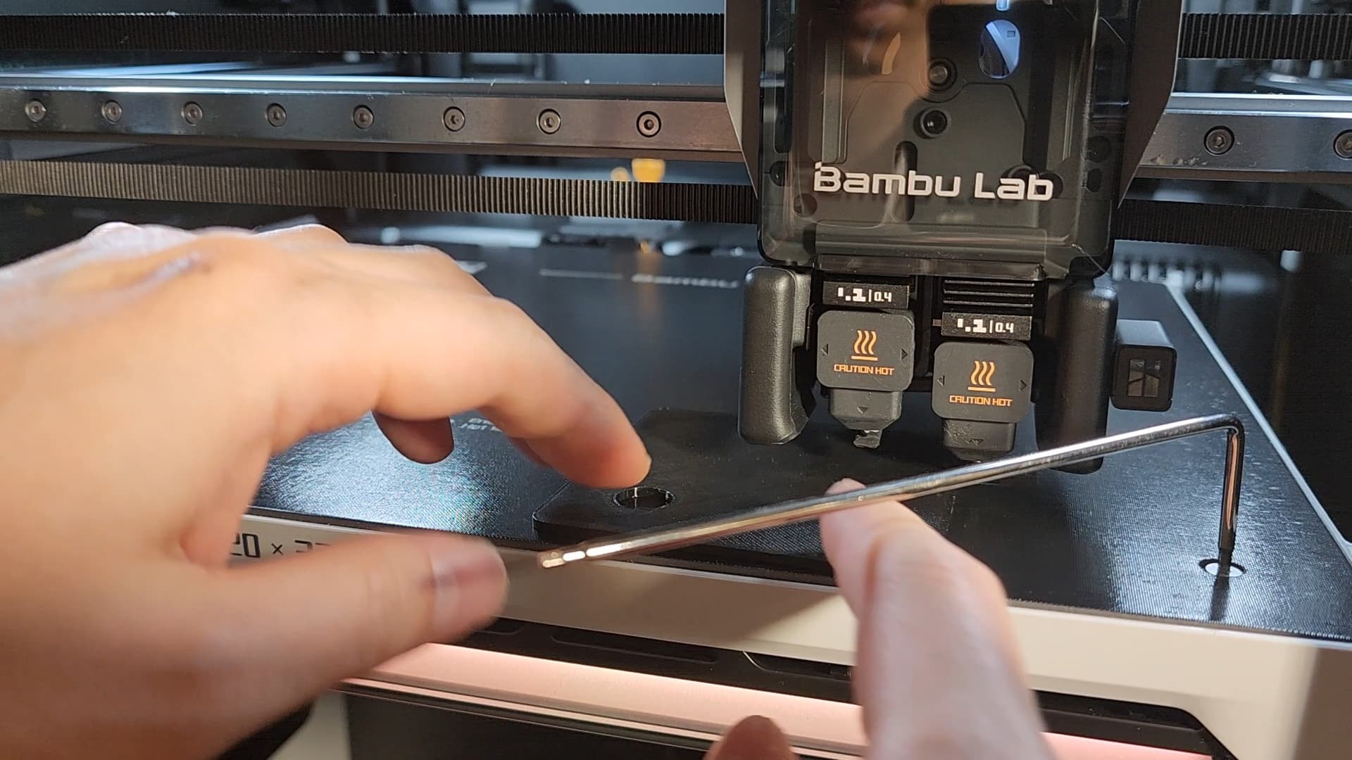

7. After the first layer test I immediately thought that the bed wasn't leveled, so I tried tramming but it didn't change anything. First layer test still fails in the left back region.

Try manual bed tramming : H2D & H2C Bed Tramming | Bambu Lab Wiki

What I’ve tried so far #7 is bed tramming. I did it 3 times.
BTW if anyone wants to do it I suggest changing the gcode so that it stays in each point for a minute instead of 30 seconds.
I didn’t have enough time to unscrew the screws.
I’d really appreciate it if anyone could try this first layer test with ASA on their H2D and let me know if you get similar results as me (6th image).
It’s about an hour print and uses 20g of filament.
H2D First Layer Test.3mf (38.9 KB)

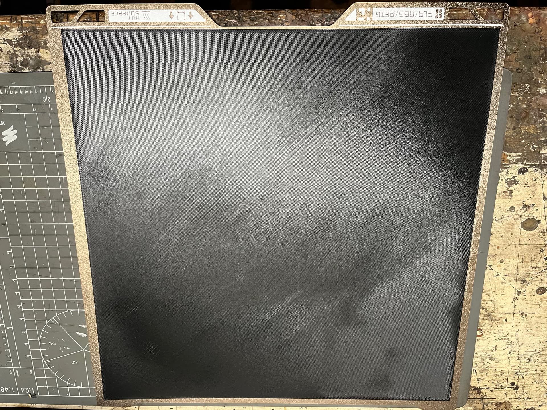

Mine came almost perfect but I also have slightly poor layer adhesion at the back that you cannot really see in the picture and I know the tramming I’ve done as part of the upgrade was not perfect there. It is not underextrusion in my case but more like a lower thickness of the layer (and yours also looks like it is) like if the bed leveling had a hard time to adjust right. In fact the bed levelling as part of the print took a lot of tries in the back. .
ASA is also less forgiving so you could have great result with PLA and not so good with ASA.
I made the mistake to get my hot plate outside the chamber right after print. The layer started to curl up and detach from the plate everywhere, I should have left it in the chamber to let it cool. If you did the same, it might have exacerbated the condition. For ASA a first layer test might be better as a 2 layer test really.
This is printed on H2C but I used the left nozzle, so same as H2D. Nozzle is 0.4mm standard (not HF), filament is BL ASA, bed plate is textured PEI, all settings for BL ASA in studio left at default.
I cleaned my plate with soap and water right before that print which is unusual for me. In fact this was the first time I cleaned it since receiving as part of the H2C upgrade with about 100hrs of print time. Thanks for having proposed to make this, it had forced me to clean it :slight_smile:

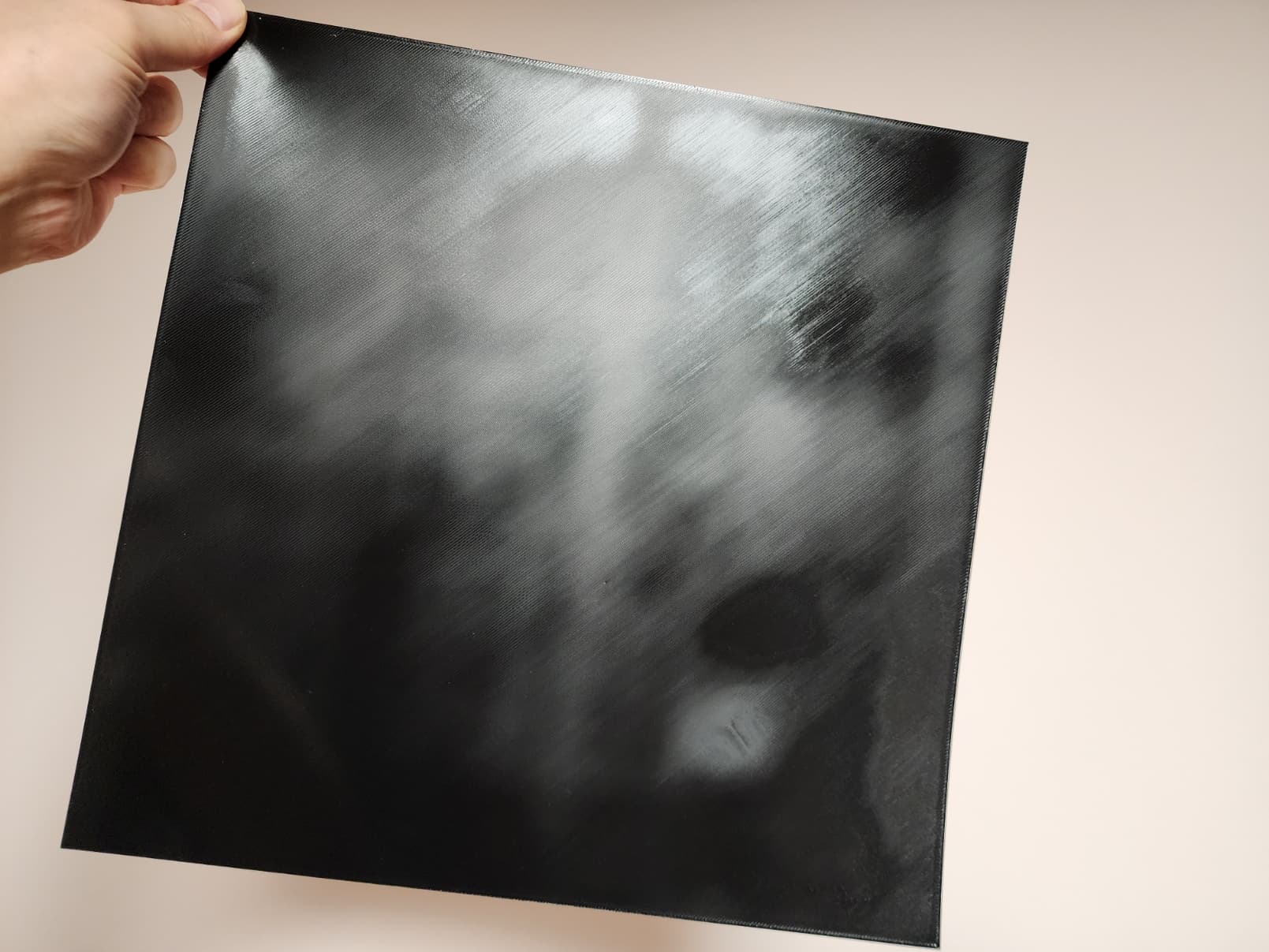

My print turned out slightly under-extruded but consistently across the entire print.
I don’t think it’s really underextrusion but ASA layer adhesion is the worst of all filament, 3 times less than PLA and the slighest variation in flow or thickness may ruin a first layer test. I tried a 2 layer test at the worst part of my bed and it turned out perfect top and bottom.
I think a one layer plate test with ASA is not representative
Edit: I also don’t think the textured PEI is great with ASA, I generally use my glacier plate to print it
In this case the 1st layer test is to determine if the bed leveling works correctly and that the layer thickness is consistent.
Oh I get it but you don’t need ASA for that, PLA will do it nicely as ASA is tougher to print. I made a 2 layer ASA and it’s perfectly printed top and bottom and thickness is constant
Thank you @Gerrit and @philch for doing the test. I appreciate it very much.
I can see that @philch has adhesion issues in the same region as mine but still not nearly as bad as mine.
@Gerrit yours look incredible and this is what I’d expect the test to turn out to be at least after bed tramming.
I understand that ASA is harder to print but what I’m looking for is consistency. If it doesn’t do well with one layer that is ‘fine’ but if that’s the case, it should do poorly across the entire plate not only in a specific area every single time, while printing extremely well in other areas. (It’s not ‘fine’ but I’d have an easier time accepting that the issue lies with the filaments’ difficulty.)
And I think both of your results, especially Gerrit’s result support this thought of mine.
