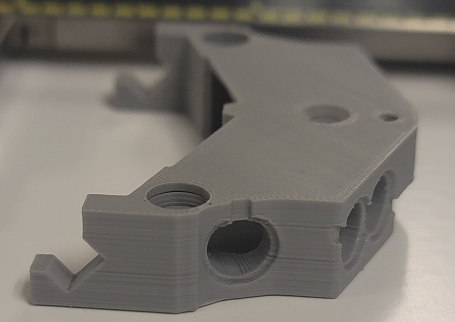

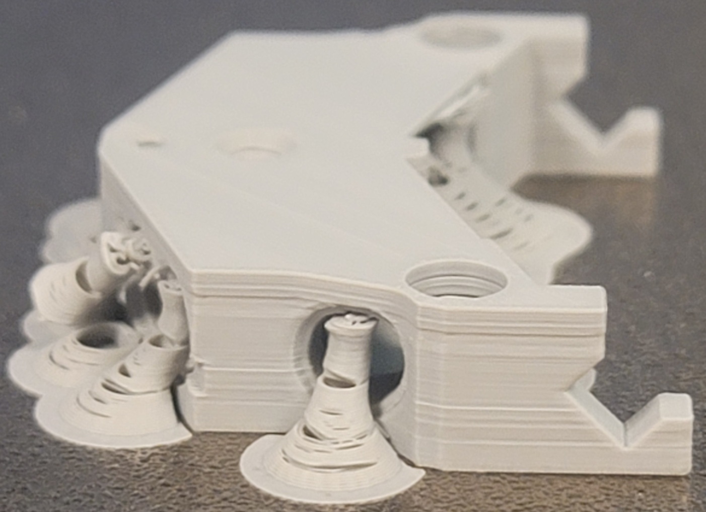

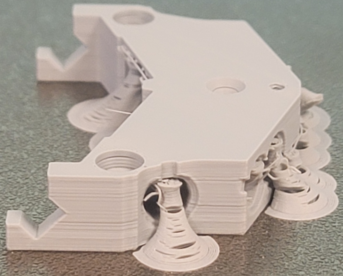

First PLA BASIC on H2D is a Misprint

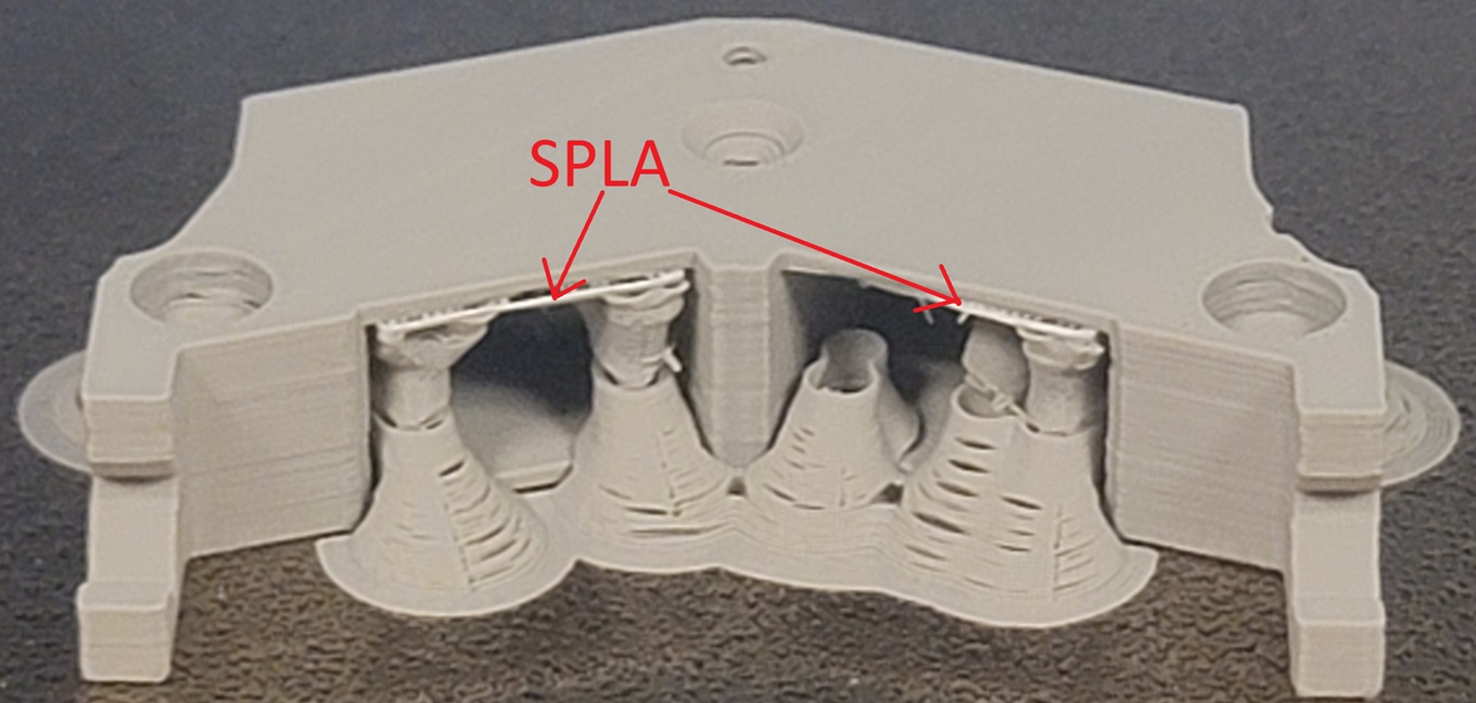

Using new 0.2mm nozzles and Bambu Lab parameters the 1 hour print is poor. The Textured PEI
build plate is clean, yet adhesion is light. For the part and support, Bambu Lab Gray PLA Basic (PLAB) filament fed to the right nozzle from an AMS 2 showing 38% RH was used. Bambu Lab Support for PLA (SPLA) was used as an interface layer and was fed to the left nozzle by an AMS HT showing 30% RH. No purge tower was used, as there is no material swap at either nozzle. The SPLA was observed flowing poorly, requiring some distance before putting material down, late in the print. One time earlier in the print a purge was seen prior to putting material down, but that was the only time. The tree supports look terrible and some of them were toppled by the nozzle motion. The part didn’t print clean either. I certainly was not expecting such poor performance from Bambu Lab. Would someone please suggest what’s going wrong here? Photos attached of the print and the cleaned part (same gray part different lightings). Thanks.
My understanding is that the tower use is a best practice. Not because of the changing of filaments, but to allow the proper pressure to be achieved before the nozzles move to the model. This is even in your observation as you said it required some distance before putting down filament. Try enabling the “prime” tower and see if that makes any difference.
Also, it seems that the RH is very high for even PLA. Try drying the filament, too.
@Steve_KA5YFC is right about moisture, both of those filaments are potentially way too damp to work well.
He’s also correect, there’s no such thing as a purge tower, and there never has been. Purge goes in the purge chute, the tower is a PRIME tower, and is used to build up nozzle pressure after a nozzle swap - because they don’t retain pressure sitting there doing nothing.
When a new layer begins, if the nozzle hasn’t been primed, the initial pressure is low, so you get underextrusion - which is exactly why your walls are uneven, your supports have gaps, and your interface is bad.
Also, if your print was barely sticking to the plate, no it isn’t clean. Hot water, dish soap, nylon scrub brush, paper towel to dry.

I think that both the filament being too wet and the fact that the prime tower was used are your issues for the most part. If the machine hasn’t reached the proper pressure, it will leave the print as under extruded. I see signs of that in your layers and on the top surfaces. The moisture in the filament will leace surface defects like stringing and little blobs as the filament pops because the water boils off at print temperatures.
Try drying the filament, you can use your printer for that if you don’t have an AMS 2 or other dryer and turn the prime tower back on. These machines are about as plug and play as they come. My first printer, I had to constantly work on, adjust before every print, spray with hairspray and just tinker with to get it to work. I have 1700 hours on my X1C and the print failures I have had are because I didn’t do something or I tried something that I should not have. My new H2C is waiting to find it’s new place on the bench. I have enough confidence in these machine that I bought another.

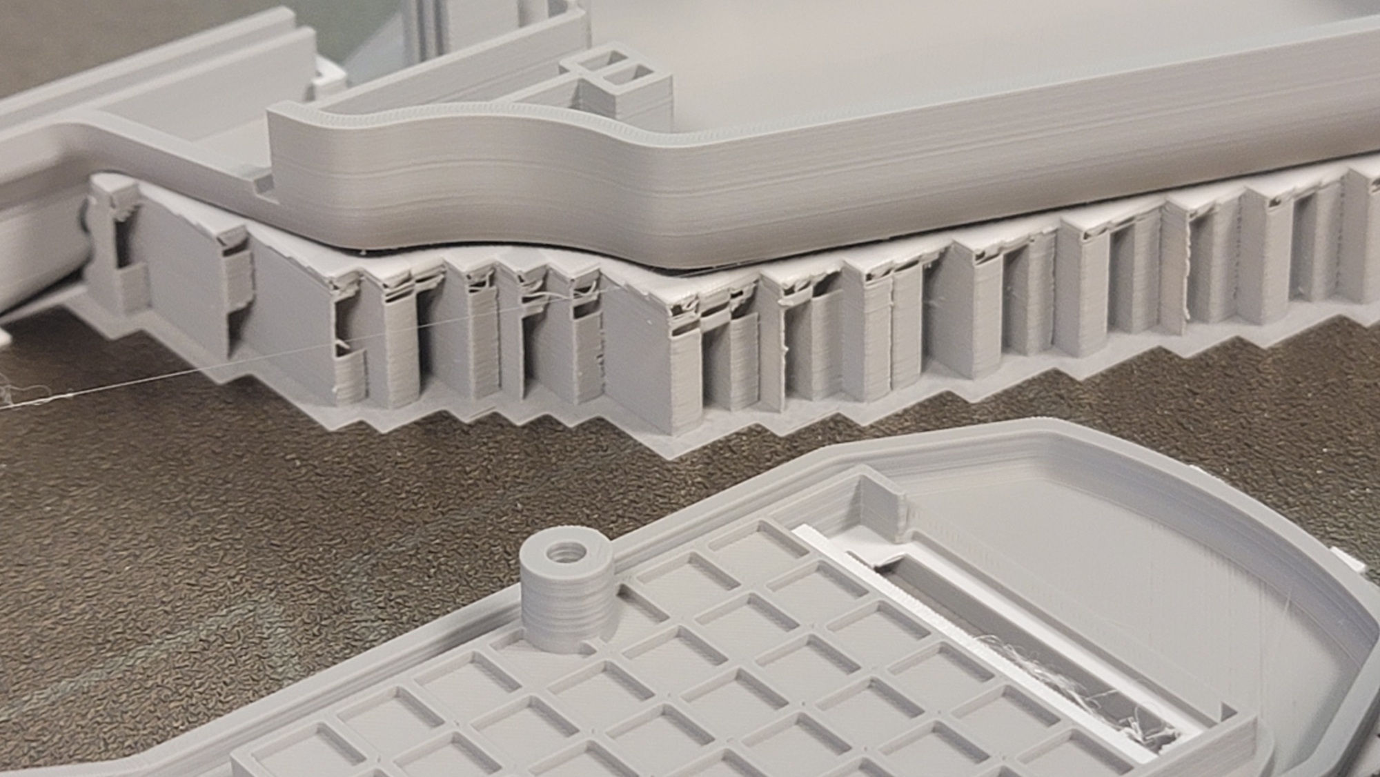

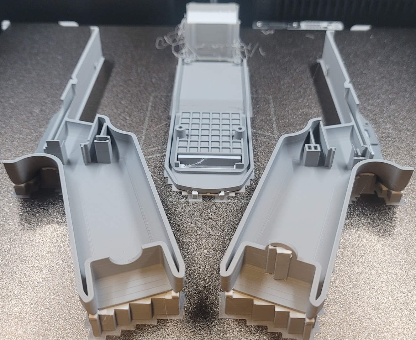

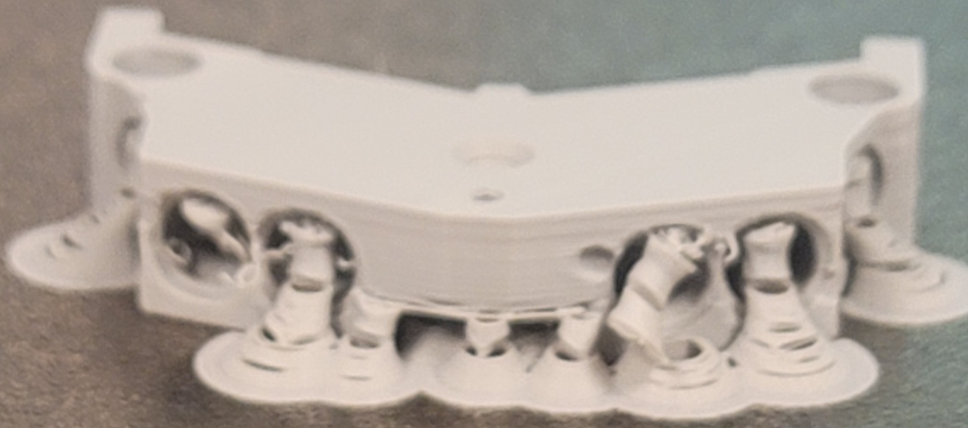

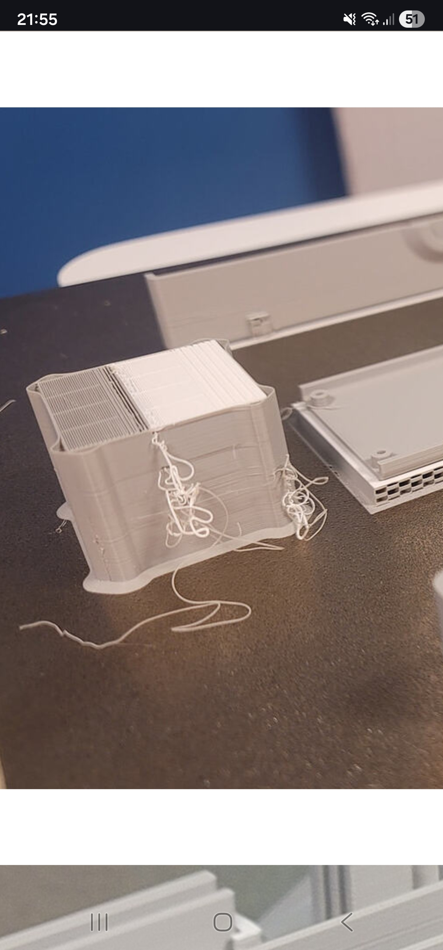

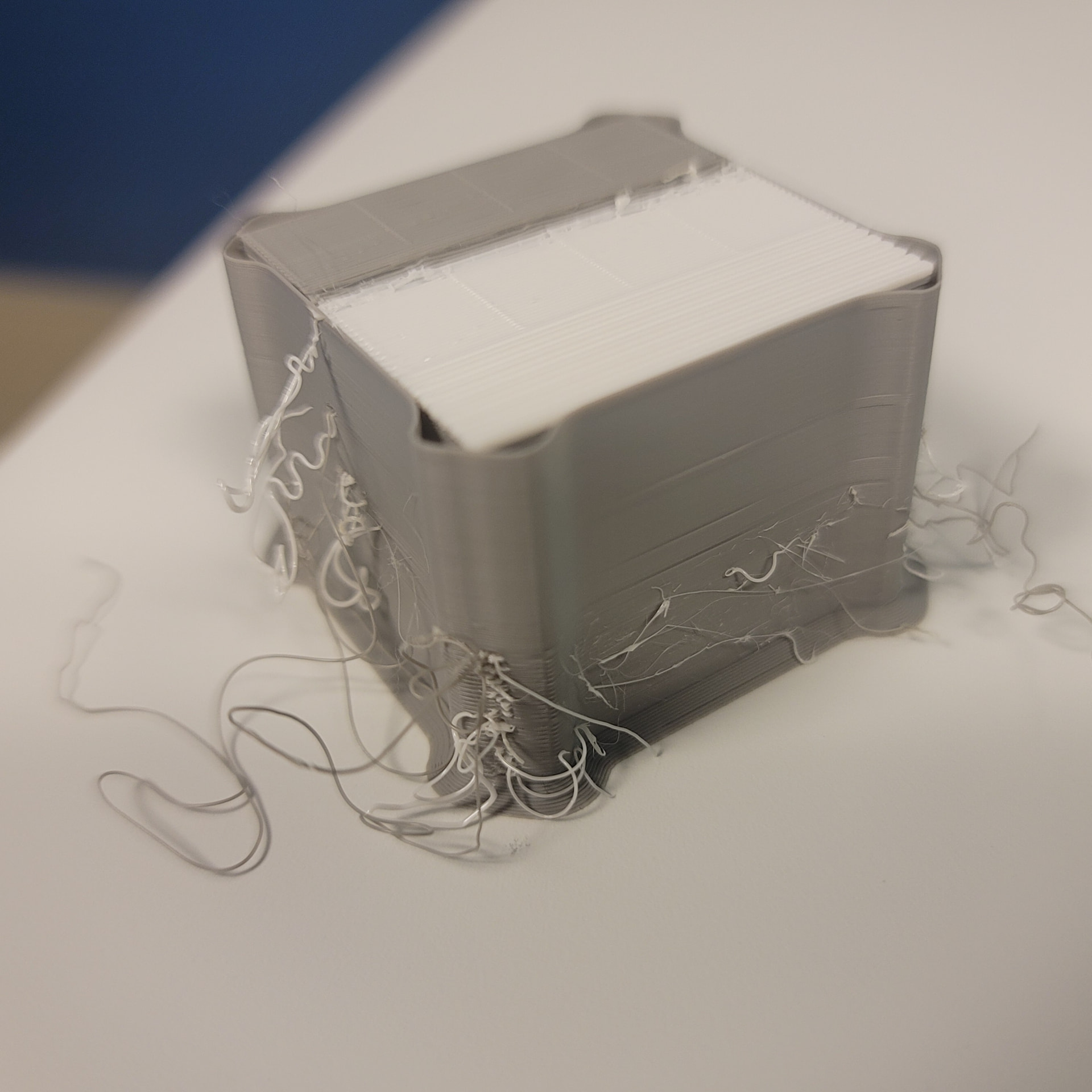

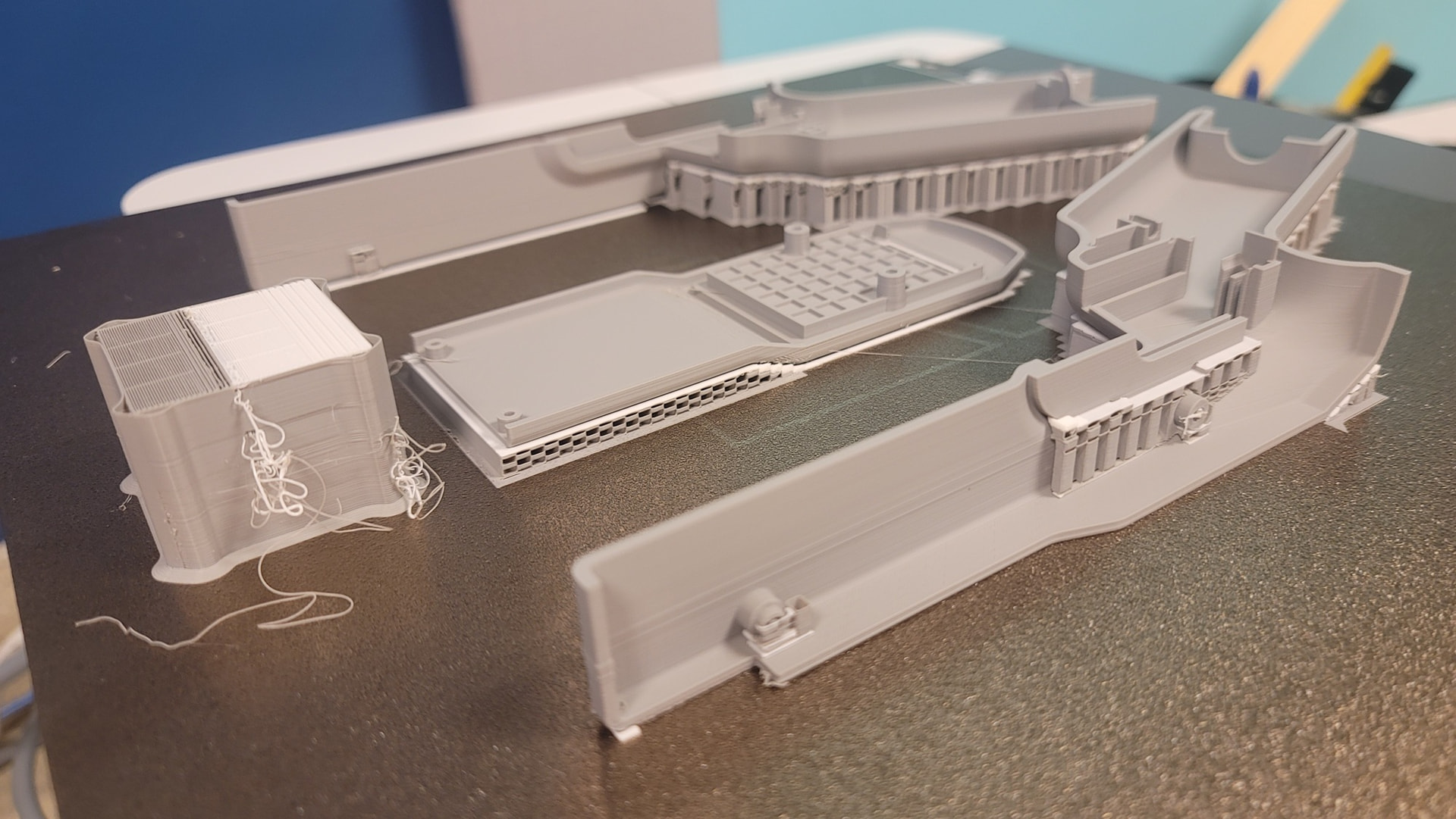

Well, the print when to the 23h53m end. I’ve retrieved the parts and there are artifacts of what I now understand to be of inadequate drying. Major stringing on the prime tower. Support structures are deformed. Distinct layer variations are still present. Please do comment on those and anything else that may be seen. However, the parts are usable for their current intent. I want better performance going forward. I have drying cycles running on both AMS.
Don’t worry about the stringing on the prime tower.
That’s something Bambu did recently, the extrusion is actually now beginning before the tower, so those little noodles are goinf to happen.
Such a strange way of doing it too! So easily for a noodle to come off and land in your print or be dragged around.
That doesn’t seem to be a problem users are reporting, it seems that the printer is doing a pretty good job of attaching the noodles to the tower.
