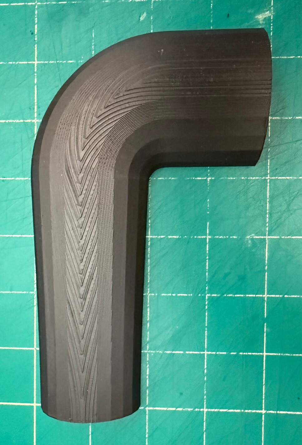

I’m new to printing - will a 0.2mm nozzle significantly increase the smoothness of this print?
Or are there settings inside the printer X1C with the 0.4mm that will help. The v shaped print is due to the tapering of the long part. TIA.
No there will be no improvement but you can try adaptive layer control or change object printing direction.
A smaller nozzle is good for greater detail, but that model does not have intricate features. The multiple flat sections rather than smooth curved sides are usually the result of a .stl model created as a coarse mesh. Using a smaller nozzle would just make the angles slightly sharper.

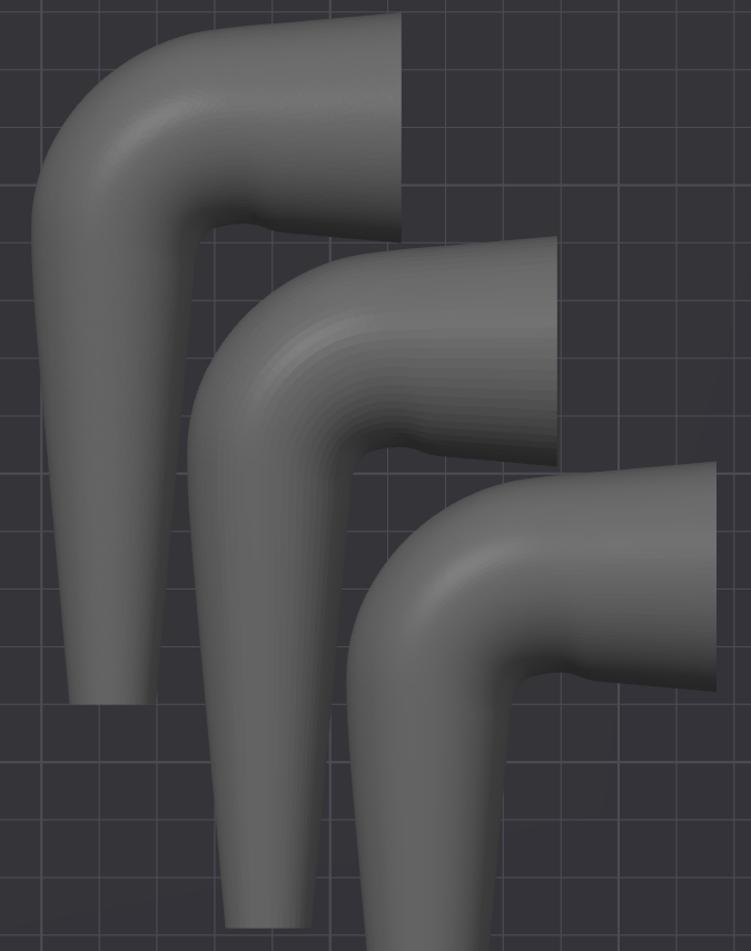

Usually, I export a design from my CAD program as a .STEP (or .STP) instead of a .STL or .3MF file. Curves will be smooth instead of faceted.
If your design program will not produce a .step file, see if it has options to produce a higher resolution mesh (more, smaller triangles) for the .stl.
Top is .step, middle is medium resolution .stl, bottom is high resolution .stl, all from the same Fusion design. (Expand the image to appreciate the differences)
.step files also tend to be much smaller:
